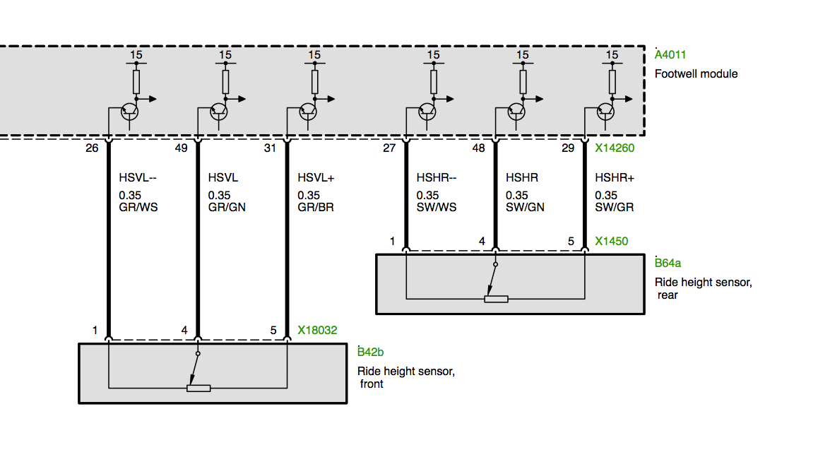

I posted the pin out on the FB post, but here is the actual diagram from the book. Looks like only pins 1,4, and 5 are used. Leads on 1 and 5 with the wiper arm on 4. Not sure the values.

My god. I think I just died and went to motorsports heaven. If that's accurate we have a very compelling suspension datalogging solution.

Just verified a 0.1 to 4.9v voltage swing across 90 degrees of travel, using the diagram above. Looks like we have suspension travel sensor! :D

What was the resistance values and what did you use for the pull down?

No resistance needed. Ignore what's in the ECU box; that's just for your reference. The device produces a variable voltage output.
