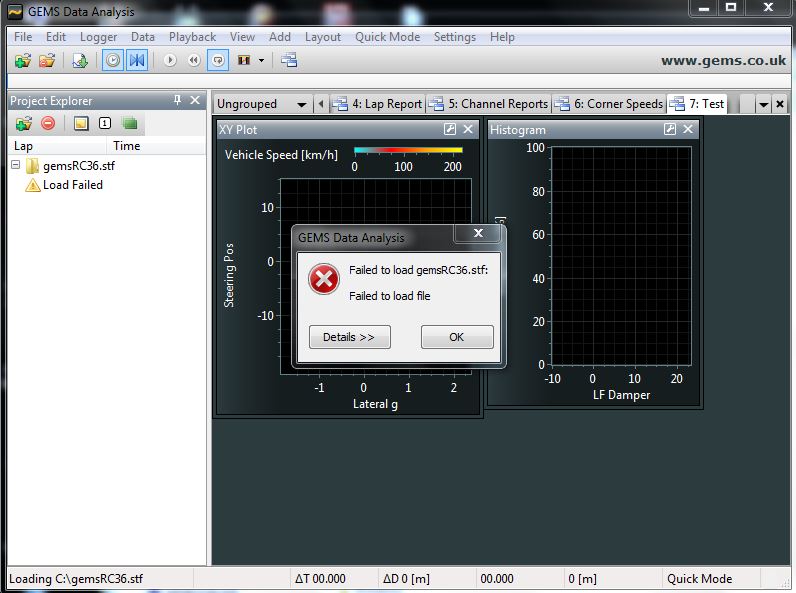

So I am trying to use the AEM/GEMS data analysis software for its added functionality. I installed Perl and have successfully run the rccsv2gems program (said the command prompt line). The notes in the rccsv2gems program mention a .srt file type which neither program recognizes. If i output a .stf file (GEMS base data log file) then I try to open the file and a warning which says "failed to load" (screenshot attached). Has anyone run into this problem before? Anything I might be doing wrong in converting the file with the perl program? I did notice that there is an extra line created in the data; line 495 "print OUTFILE "\r\n";". Changing this to either "\r" or "\n" does not fix the file loading problem.
Screenshot after trying to load converted file.

So with some fiddling I figured it out. I am adding this description since I got lost trying to do this for a while.
First use the rccsv2gems Perl program to convert the .log file from RCP to a .csv file. This program re-arranges the data so that imports better. Using the DLOG99 software from the GEMS UK site, select File then Import and select the newly created .csv file. This will prompt you to save it as a certain file type, save as whatever name you like with the .stf (data file) type. This new data log file of .stf type can be opened by either GEMS Data Analysis or AEMdata. I prefer AEMdata because it is free and has the math channel funcitonality which the free version of GEMS Data Analysis does not have.
To add a little more information, I used Strawberry Perl for Windows. Once the Perl software is loaded you will need to add the Text::CSV functionality (check out this link http://www.cpan.org/modules/INSTALL.html). Then you can use the command line to execute the rccsv2gems.pl file and convert the files. The command line will look like "C:\File Location\> perl rccsv2gems.pl RC_123input.log RC_123output.csv --disable-gps-cleanup" if you don't need the GPS cleanup.
Hope this helps some others get into data analysis software that can help them get driving faster!

Could someone share their log file so I can help look at this? Also thinking of a python version of the script so we can ultimately get it integrated with the app.
Copper280z
Posts: 30
Joined: Sun Mar 15, 2015 3:03 am
Location: United States
Post by Copper280z »
Josh,
The untouched racecapture logs are named RC_x.LOG, not .CSV, this is important. Try cding to your directory and just typing RC_0.log, notepad should open the (gibberish looking) log file, if it doesn't then make sure you have the name and extension correct. Once you've got it opening like that, try running the script again with the filename you're sure is right.
I'm not sure if I did something different (also very new to perl), but I didn't have to install text::CSV and I execute the script without the 'perl' in the beginning.
My rcp is currently riding shotgun, so the data isn't the greatest, but I could probably send you something that's just got some street driving later in the week.
JMcDonough
Posts: 70
Joined: Tue Mar 10, 2015 3:31 pm
Location: Detroit, MI
Post by JMcDonough »
Copper280z wrote:Josh,
Typing RC_0.log instead of .csv did the trick. I still have to use perl at the beginning of the command for whatever reason, but it works! Thanks for the help.
For anyone else going through this, to open the output of the perl scrip in Dlog99 you have to do a File->Import to read the output of the perl script.
Happy to finally be looking at the data.
