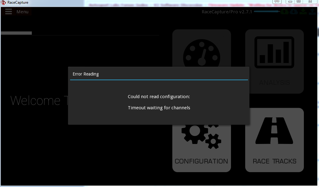

I am getting Timeout waiting for Channels.
Windows7 64bit
Drivers are installed and working
I have re installed the app.
i have tried USB 2 and USB 3 ports.
i have disabled my AV.
I have tired running as admin.
I have tried making sure i have an SD card installed in the RCP. I have tried without SD card.
[/img]
Timeout waiting for channels

Ok I installed everything in a another computer and it the RCP app wasn't downloading 100%
After the 3rd try it seems to Dl completely and installed it all and worked fine.
Went back to my main pc Uninstalled everything. cleaned the registry. then made sure my Anti virus was off.
I re downloaded everything and reinstalled and it seems to working now
