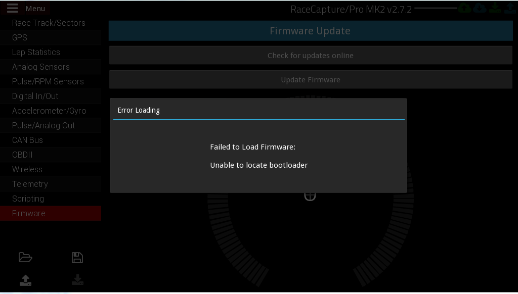

RCP MKII Unable to locate bootloader -Firmwar not uploading
Running windows RCP 1.0.1 trying to upgrade to firmware 2.7.5 from 2.7.2
[/img]
[/img]
- Capture.PNG (42.82 KiB) Viewed 14811 times

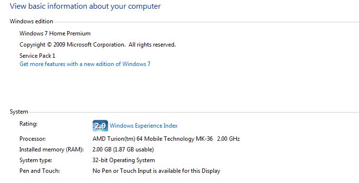

Inspiron 1501
Brent: I have two computers that I tried running the RC software. My primary is a Dell Inspiron 1501 and the other is a Dell Inspiron Mini 10. The later will not run the software because it is a basic POS that I use in the garage for internet searches wile working on cars. The primary Laptop image is attached.
- Screen Capture of my Computer system Configuration.
- Inspiron 1501 System.JPG (36.6 KiB) Viewed 14756 times
Rocket 6706
