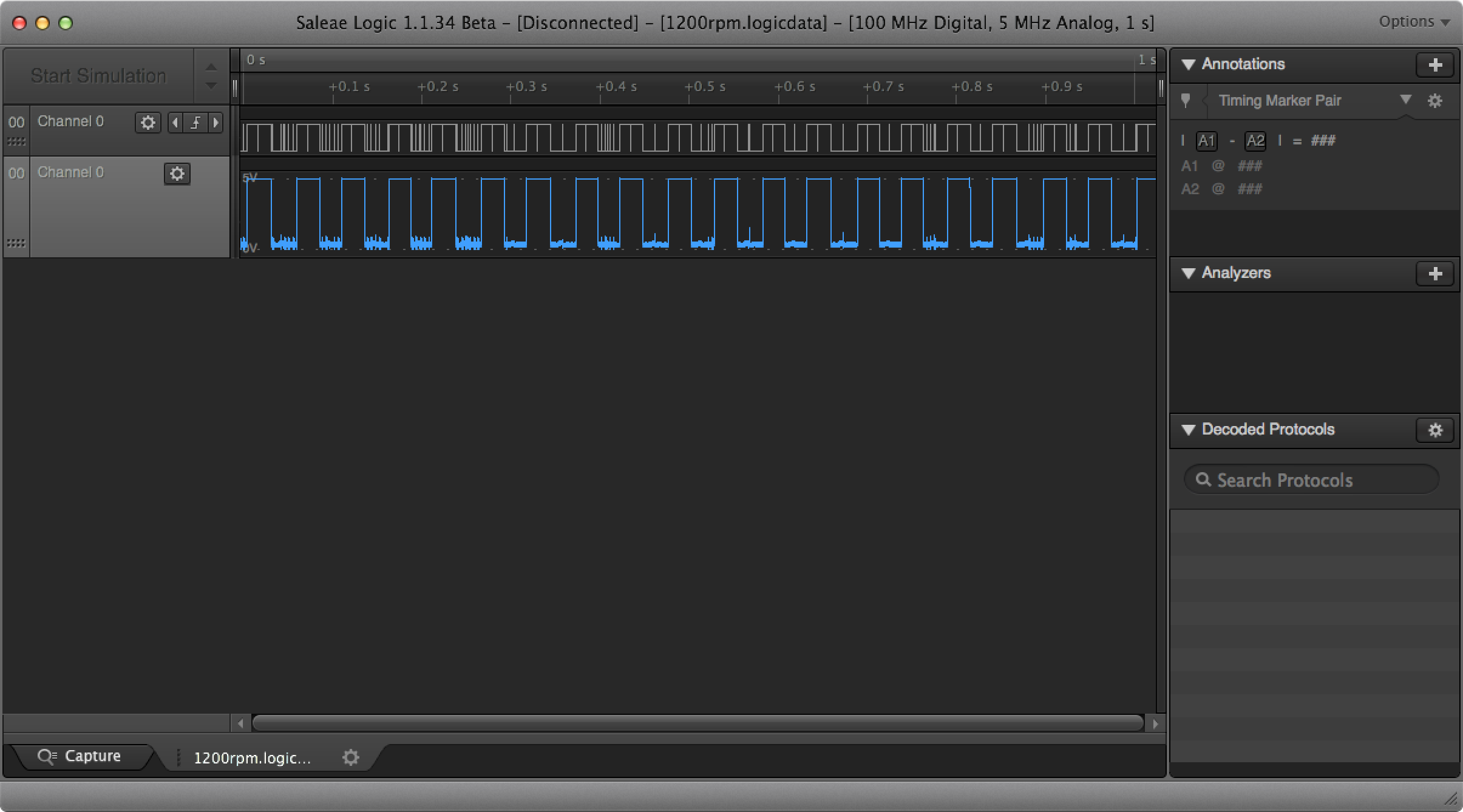

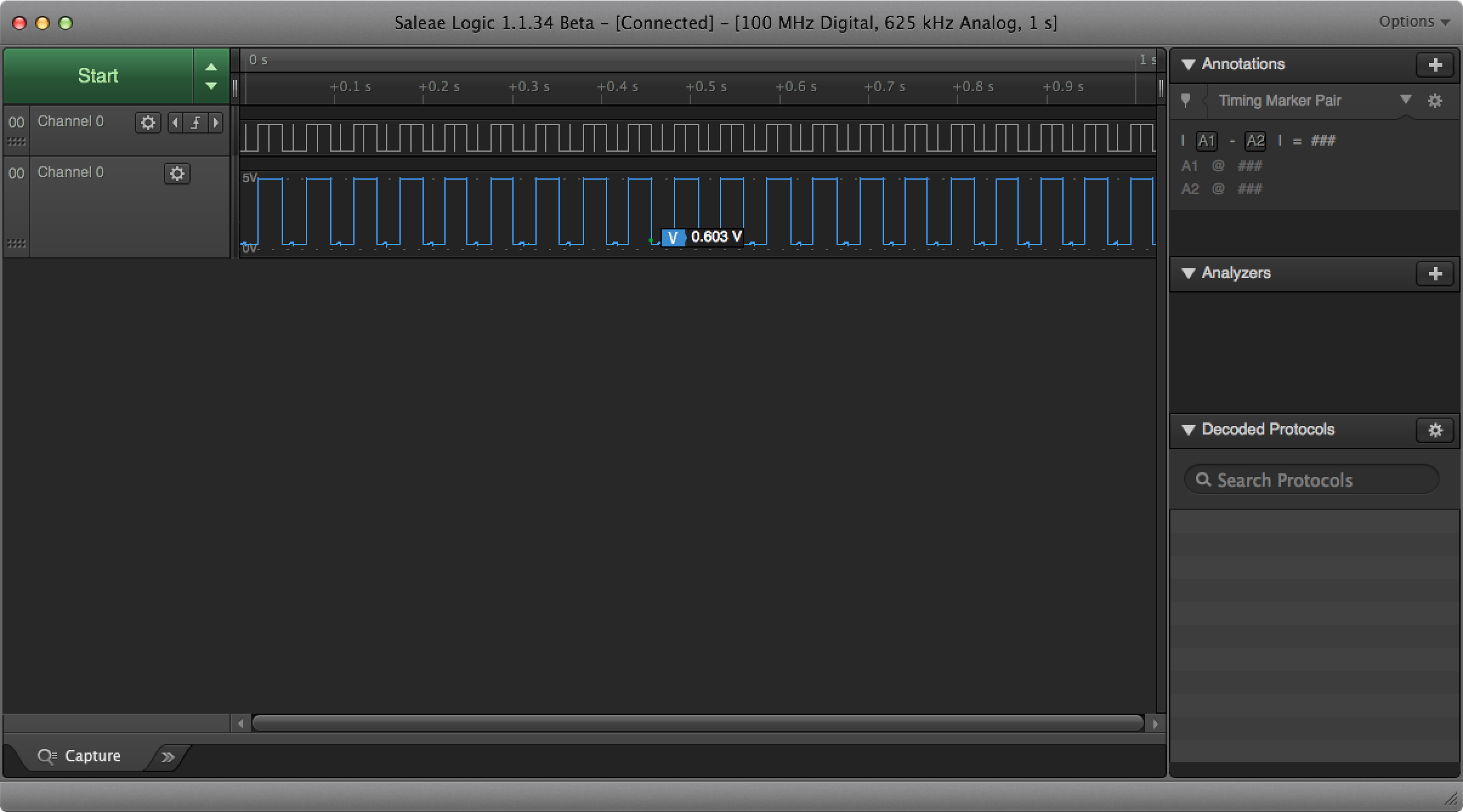

Mystery solved—I got a scope on it, and the output was a perfect square wave, one pulse per rev. I've attached the output from the engine while it's idling at around 1200rpm (which gives 20 pulses per second, exactly as you would hope).brentp wrote:A scope would be super handy to see exactly the pulse rate at a given RPM.
I've now got the RCP2 configured with one pulse per rev, medium timer, and everything's great.
So that's all good. I'm still rather mystified why the configuration I worked out before I put the scope on it (10 pulses per rev, slow timer) worked (it gives *exactly* the same results as 1 pulse per rev, medium timer).
It would be really helpful if the documentation gave more help about the difference between "slow", "medium", and "fast". How slow is "slow"? How fast is "fast"?
- 1200rpm.png (177.14 KiB) Viewed 17794 times
- zoomed.png (173.05 KiB) Viewed 17794 times

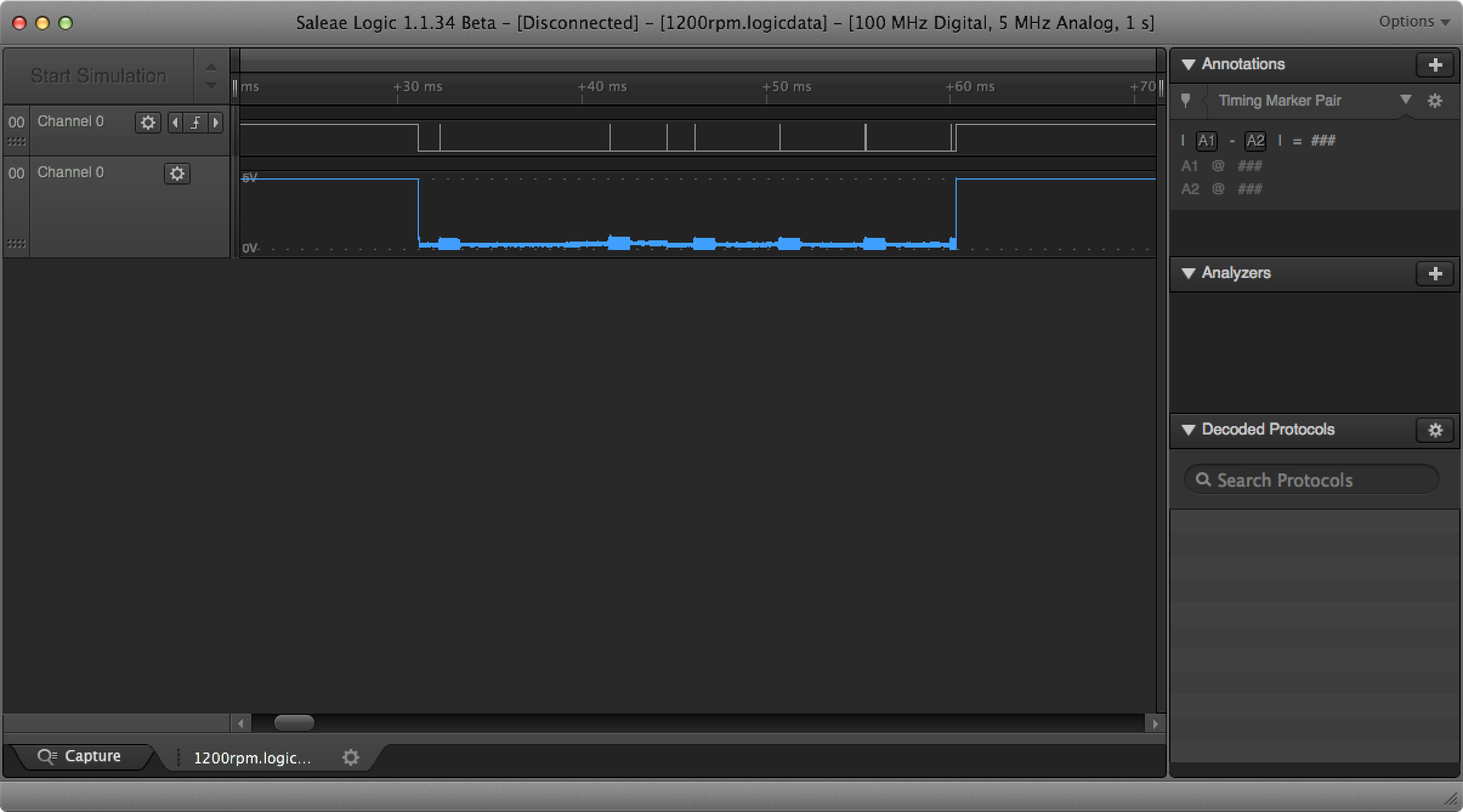

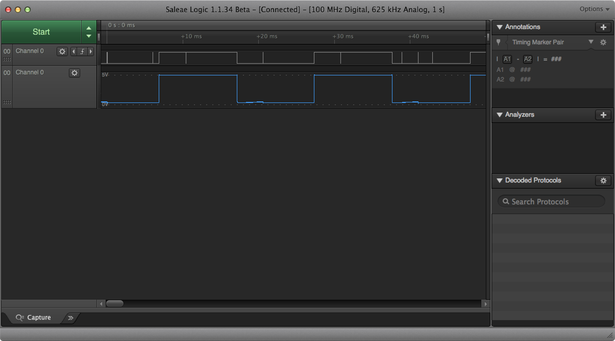

There's only one channel input—it's the tacho output from the ECU. The top trace is in the digital domain, the bottom trace in the analog domain.brentp wrote:Thanks, Paul for the update! What is connected to each of those channel inputs, just to be clear
There are some strange artefacts in the digital domain, which don't seem to have corresponding features in the analog domain—I'm not sure that I'd worry too much about them at the moment, the analog domain is the more interesting one for our purposes (and the configuration suggested by that trace, of one pulse per revolution, is working perfectly).

I'm betting the spikes that show up on the digital samples are really there in analog land, but your analog samplerate of 625khz is too slow to show the noise clearly. You can start to see a disturbance at the low side of the analog trace, that usually syncs up with a spike in digital-land. Also (without knowing how your scope works) if the analog trace is averaging multiple sweeps to get one displayed trace, that'll hide random noise to some degree.
It also depends on what the digital sampler's set to for a high/low threshold. Could be a fixed 2.5V level or some other threshold voltage, could have noise immunity (rising above 3V sets the bit high, falling below 2V sets the bit low, noise between 2-3V is ignored)... you might be able to turn on noise filtering for the digital channel too. But if the noise really exists, then ignoring it on the scope isn't going to help RCP hardware sync on the signal.. better to see as much noise as possible so you know the enemy.. then figure out how to quiet it down so your real measurement device (the RCP) can trigger on it cleanly.

Here's a capture at 5MHz instead of 625KHz. There's clearly quite a bit of noise around zero, but all seems to be below 1V. Given that the setup is working, I guess the RCP2 is filtering it out?
- 1200rpm.png (182.87 KiB) Viewed 17720 times
- zoomed.png (179.26 KiB) Viewed 17720 times
