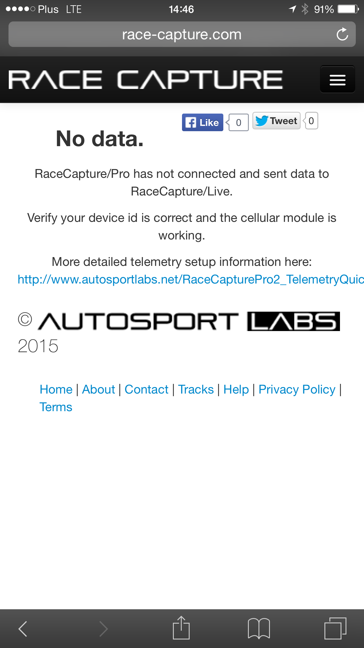

Defining new event does not quite work for me.
I define new event, I add vehicle, all ok. But after clicking on event I get No Data.
I figured out that when I go to Ad-hoc event, edit vehicle and assign it to event I created earlier telemetry shows up for some time in this event, but then after RCP power cycle event says NOT CONNECTED.
Ad-Hoc event works ok always.

Hi sigtrm. The way race-capture.com works is when RCP connects it looks for an event for *today* and adds RCP to that event. Are you creating an event for the same day that RCP connects or another day?
Can you send us a link to the event and your email address you use for race-capture.com?
