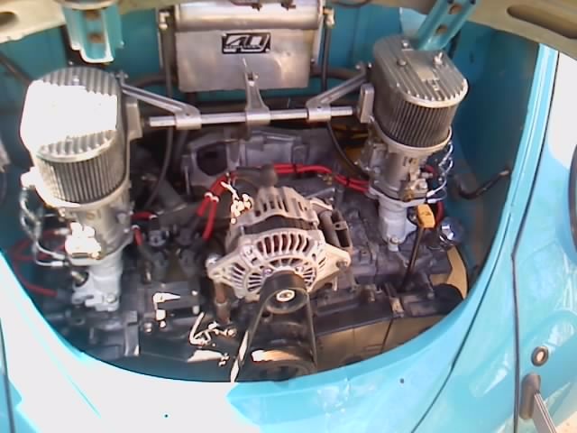

Wondering if someone has a map for a 2.2 Subaru with twin 36 dells.

Here is a map that I created as a starting point. Seems to work ok. Still have some carb tuning to do.
If anyone has any feed back-good or bad-let me know.

Is it MAP or TPS? Can't help thinking that advance under high load and low revs is too little. In case you have a stutter at low revs while accelerating from idle, give more advance in the 600rpm column instead of less at higher load, helps to rev up more smoothly. Check my second Saab Sonett III map to see what I mean. At higher revs give it a degree extra advance per 500rpm; you have the possibility to extend the advance range compared to what you can get out of a dizzy, use it. The advance range at higher revs between low and high load could be a bit more if you ask me.

Thanks for the reply and the feedback. It's a map set up. I will look into your
Saab set up and try it out.
