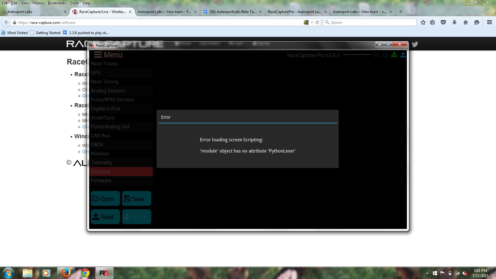

When I click on the scripting tab in V 2.8.3 I get an error that shows up on the screen.
"module" object has no attibute "pythonlexer"
Is scripting disabled in 2.8.3?

Same here. http://www.autosportlabs.org/viewtopic.php?t=4521 But it's not 2.8.3, it's the app. Go back to 1.3.5 and you should be fine (mine works again). Scripting in 1.3.6 works on my Android tablet though...
