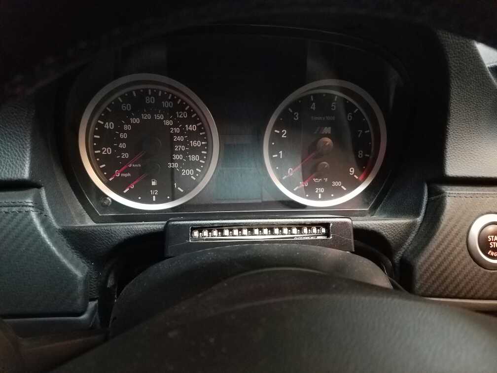

I finally had a chance to try your getUptime idea. It works perfectly. The shift lights turn on and off without delay. I am now willing to trust them on the track.
Thanks to you and Ryan for your help.
