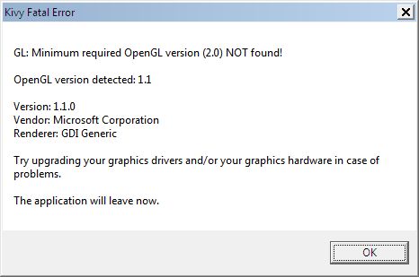

i have a mk1 running software 2.8.7 which will load to the logger over usb from a dell pc running windows 10.....this pc will not however run the racecapture app - some versions (before v1.6) give kivy error and chinese... v1.6.0 says i need open gl ver2 in english....

For your Windows 10 computer, the RaceCapture app needs Open GL 2.0 capable video drivers. You may check the Dell web site to see if there is updated video drivers available for your computer.

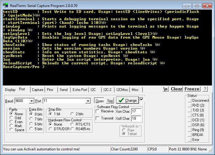

Hard to tell why your vista computer is doing that.
If you have the RC app shut down, then connect RCP, then fire up a terminal program like hyperterminal or RealTerm, what do you see after hitting 'enter' on the keyboard? You should see a command prompt with some menu items show up.
Also, try using a previous version of the app to see if that makes a difference.
-Brent
-Brent

- RealTerm.jpg (111.62 KiB) Viewed 24466 times

I had also tried Safe Mode with networking, but Kivy wasn't happy

- Safe_mode_kivy_fault.jpg (20.87 KiB) Viewed 24449 times
