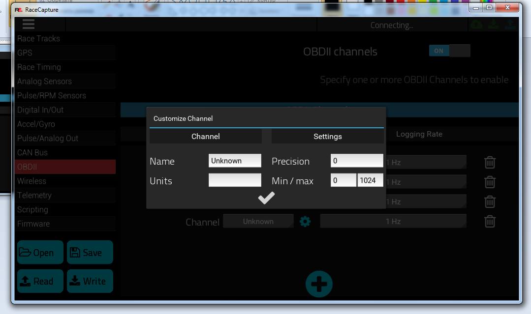

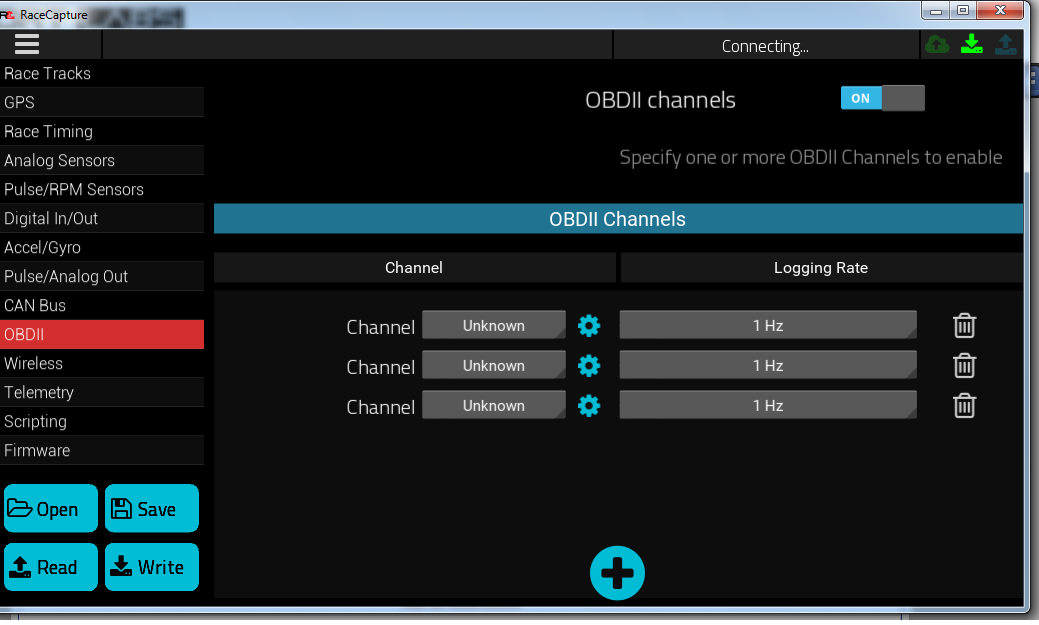

Thank you! But the main question here is, what is actually meant under choose
Because I see this screen in the following way (screenshots attached) which rather lets you to set up the channels rather than choose.
Main screen
Main screen
Channel set up screen

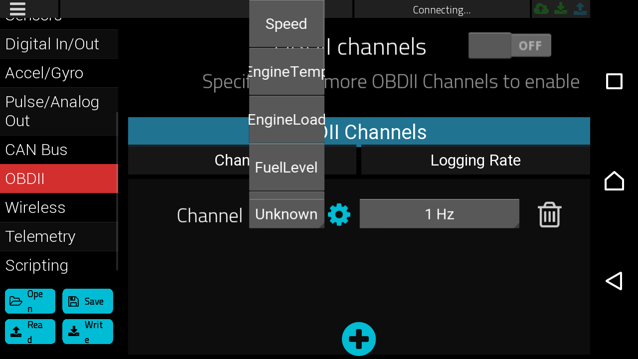

Ah, ok... Click on the word "Unknown" instead of clicking the "settings" and a drop down menu will pop up where you can choose...

Awesome, thanks :o
