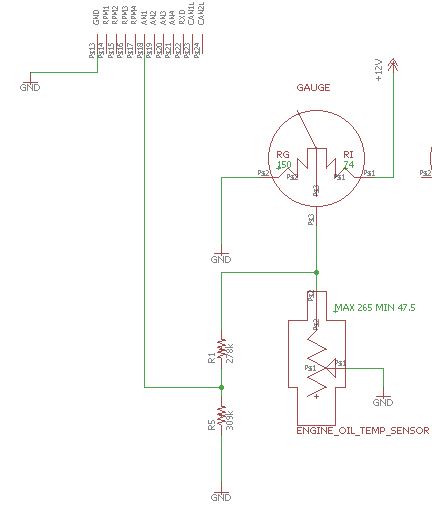

Brent,
Thanks for your note. Very helpful. I have just finished characterizing our temp sensors using an inductive hotplate and a hot oil bath. I have a thermcouple I used to measure temp. I did a curve-fit and have equations for resistance as a function of temperature.
The (good) news is that I checked the output of our existing analog gauges and it's regulated down - I'm getting 5.09 Volts with no sensor hooked up.
Do i still need to add a pull-up resistor (between the analog gauge and the sensor), and if I do, won't that mess up the analogue gauge reading Sorry if my electrical engineering is a bit rough.

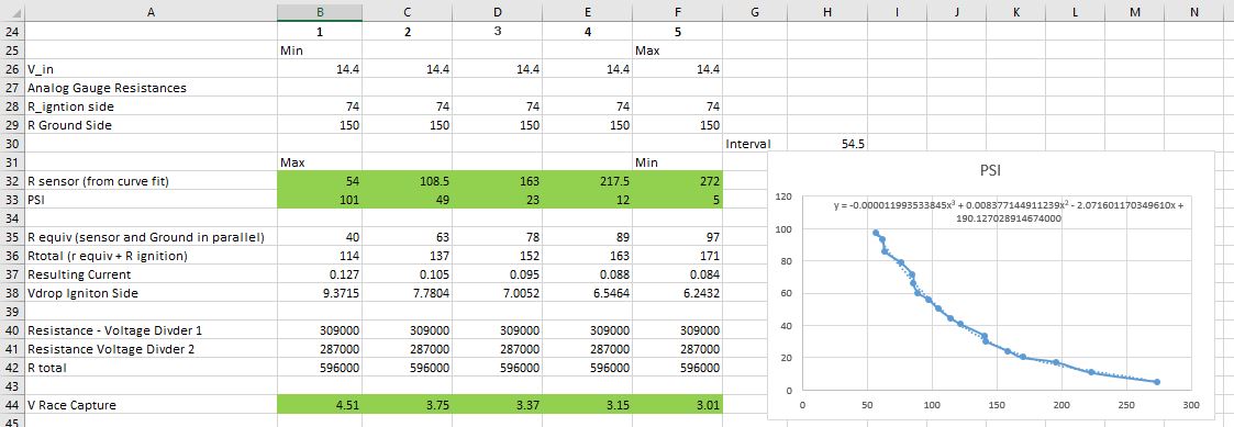

Sorry.. A bit more information. I feel like I'm pulling the thread on a sweater here.
I checked the output sensor terminal on the analogue gauge without a sensor attached and its 5V.
However when I hook up the sensor, the voltage jumps up. With the sensor at 220 degrees the voltage is is at 8.14 volts. Clearly I can't run that into the MK3.
I'm not certain I understand how to add a voltage divider without altering and screwing up the reading on the analog gauge. Can this be done?
Brent, Sorry to be needy. My weak electrical engineering skilz are showing through.
I'm wondering if the work I did characterizing the sensor resistance as a function of temp isn't going to help because i need it to continue to function inside the circuit with the existing analog gauge. I was assuming the existing analog gauge would work like a resistive element (i can do V=ir) but clearly that's not the case.
The only thing i can think to do is to create a voltage divided using some very large resistor values. In this way, the new resistive path would not (significantly) change the resistance being seen by the analog gauge. However I'd have to re-do the existing mapping and instead of mapping resistance as a function of temp i'd need to map voltage at the divider as a function of temp.
Am I looking at this wrong? I don't have much confidence i know what I'm doing here.
to make matters all the more delightful, the analog gauge is proving to be off by about 15 degrees. Not sure what I expected but I was hoping for better than that. So I need to decide if I want to map RaceCapture to the analog gauge readings or to the real temperature. Chinese saying - man with one watch knows what time it is but man with two watches is no longer sure. Wonderful.
Thanks for any advice.
Dave
Dave

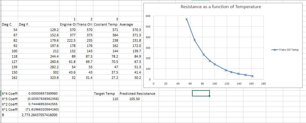

Brent,
That's exactly what I did. It took me a bit of time to figure out how the analog gauges work but I found a schematic someplace that made it clear. For the analog temperature gauges there are two wound coils inside the gauge that act as electromagnets to deflect the needle but basically appear as resistors. One of the gauge coil/resistors leads to 12v and the other leads to ground and the sensor input is tied between these. Basically the sensor input resistance and ground resistor are in parallel which in turn are in series with the ignition resistor so as the sensor resistance changes the magnetic attraction to the needle changes. Based on the gauges I've measured, these internal resistances are in the 100-300 ohm range. So I build a voltage divider out of much larger resistive values (300K or so) that don't impact readings. A schematic is attached.
It all works as expected and I characterized all my sensors as functions of resistance.
To be candid though we're still on the fence on whether to run piggyback gauges or go all-in on race capture. It's a PITA to wire this into the existing gauge cluster which is one issue. The other is that the analog gauges are pretty stunningly inaccurate. For example, in the attached picture you can see i rigged up a simple pressure vessel out of some pipe to allow me to characterize the oild pressure gauge. Unless I've screwed something up, the analog gauge is showing 50psi and my calibrated pressure gauge shows 80+. Yikes. The temperature gauges have been closer but are still off by as much as 15 degrees which could make a difference around boiling. Of course we really use our gauges as a relative reference - not really absolute anyway.
So part of us wants to can all our analog gauges and go all-in on race capture. What's dissuading us is a) if we have some sort of a failure of race capture or our tablet we'd have no gauges in the car (the OEM dash and all the OEM gauges are long gone) and would either have to shut down or run blind. In addition, we are sort of struggling to get all the information we'd like to show on one race capture screen - we obviously would need all our gauges but really want predictive and segment timing as well and I think we run out of channels and real estate.
Oh well. We'll sort it out!
If anyone else is curious I can share how I characterized all the gauges - I did polynomial curve fits and reverse engineered resistance equations from measurements. I suspect that's probably a waste of time and it's far easier to just map the resistance and voltage to mirror the readings on the analog gauges - even if they suck.

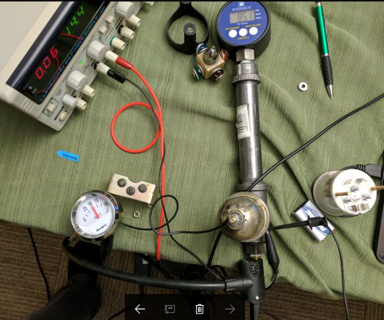

- Capture.JPG (25.47 KiB) Viewed 25035 times
Those types of oil pressure sensors are flat out terrible. Highly recommend a powered sensor that has a linear output between 0.5 - 4.5 volts
https://www.autosportlabs.com/product/1 ... re-sensor/
https://wiki.autosportlabs.com/RaceCapt ... re_Sensors
