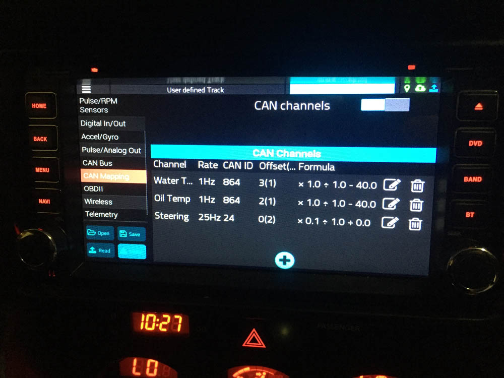

OK had a bit of a win tonight!
I have OIL temp working and almost everything I need except brake pressure
using CAN ID 209 offset 2 and length 1 but not getting a reading, I'm sure i am close as PSI came up in the units for the gauge once.
I couldn't get throttle / wheel speed via CAN but using OBD for now.

I think I need a little help, I have zero experience with CAN or PID and I'm trying to set this up on my Racecapture/Track to read from my GT86 racecar, I really need someone to spell this out in simple terms for me :oops:
So I've inputed the exact same CAN settings for all three as shown above and I'm getting nothing back on the display, Am I missing something? I tried the standard PID for RPM and it was working fine so I assume its not a communication issue.
Example of what settings I've used to try and map the oil temperature
Can Settings:
Baud Rate 500K
CAN mapping settings:
Rate 1 Hz
Can ID 864
Mask 0
Can Bus 1
Offset 2
Length 1
Bit Mode: Not Ticked
Source Type: Unsigned
Endian: Little
Formula: Raw x 1.0 divided 1.0 + -40
Unit Conversion: F->C
I also tried using the PID instead but I can't figure out the settings to use, as best I can tell the PID for oil temperature is 2101, but the information for the oil temperature is located at byte location "AC" which I believe would be equivalent to offset 28?? But I can only select up to offset 7?? Also how do I find out with CAN ID to use with the PID, and all the other settings to use?

OK, make sure you are CAN mapping, maybe turn off OBDii channel mapping to be sure, as there is no PID mapping in CAN.
Edit CAN channel mapping:
channel
Units: C
Precision: 0
Min / Max: 0 / 200
CAN ID match
can id: 864
Mask: 0
Can Bus: 1
Raw Value Mapping
Offset: 2
Length: 1
Bit mode unticked
Endian: Little
Formula
Raw x 1 / 2 + -40
Units Conversion
No Coversion
Try that and let me know how you go

Write that then restart the app and the racecapture.
I had a few niggles that have been sorted by that i think.
I have brake pressure working now as well!

actually this should be easier,
attached is an RCP file you can just load, note you will still need to select the channel within gauges.
https://www.dropbox.com/s/vmnu7wu4m7nnj ... N.rcp?dl=0

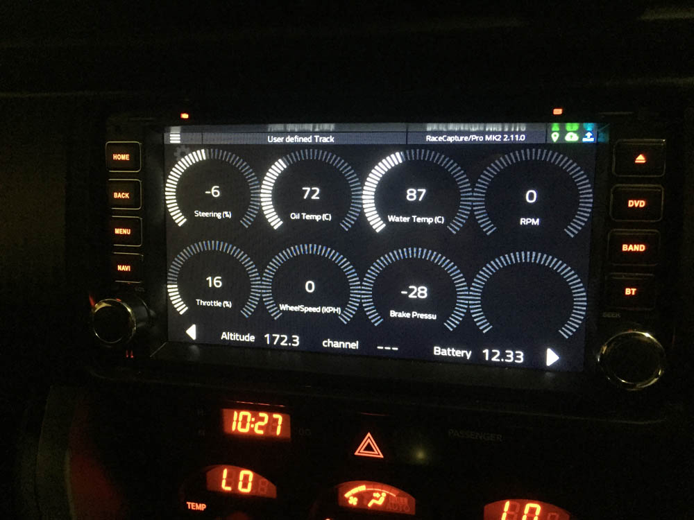

no worries, i just reworked it with wheel speed and 0-100% pedal, same link as above.
I was finding the the RCP needed a power cycle after entering settings. Maybe also force quit app just to be sure.

Little update, got this up and running on my racecar for this weekend, thanks to crimespree for the config file again.
Had a few issues, mainly my table would not consistently pick up the racecapture/track WIFI, also had a lot of issues with the GPS accuracy, both obviously not CAN mapping related. But was great to have oil temp and brake pressure visible in car, and to be able to log steering angle too.
I'm blaming the poor GPS on the location of the unit, so I've moved it into the centre of my dash so it has clear windscreen above it, however I'm not sure why the WIFI connection was so poor, it continuously dropped in and out. But I'm looking forward to some future bug free logs so I can overlay steering, brake and speed which will be awesome

Anyway, using crimesprees excellent file I could not get wheelspeed either, and decided to compare his inputs with those listed above. I think for those he forgot to convert length from what I assume are bits to bytes, as was done for the parameters that work. Appears we leave bit mode off, but wondering if we can use the listed length/offset if we turn it on?
Would be nice to have the exact entries we need for racecapture listed without need conversions, but this is the only place I have found this information, so hard to complain!
