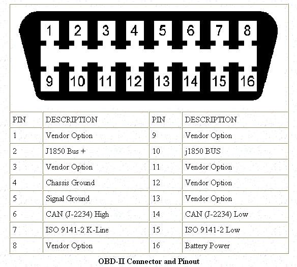

I need the pin out diagram for the OBDII connector side of the OBD/RJ45 autosport cable.
Vehicle does not have OBD system, but will be using the CAN output from Hondata ECU to connect to RaceCapture MK2 OBD cable.
Hi, the OBDII cable pinout conforms to the SAE standard OBDII pinout specifications. Note, only CAN, GND and power are connected. See the attached image.
For further reference, the RaceCapture RJ45 pinouts are here: https://wiki.autosportlabs.com/CAN_Bus_Integration
You can also take a CAT5 or CAT6 network cable and cut the end off as well, if you're hard-wiring a solution.
Hope this helps!
