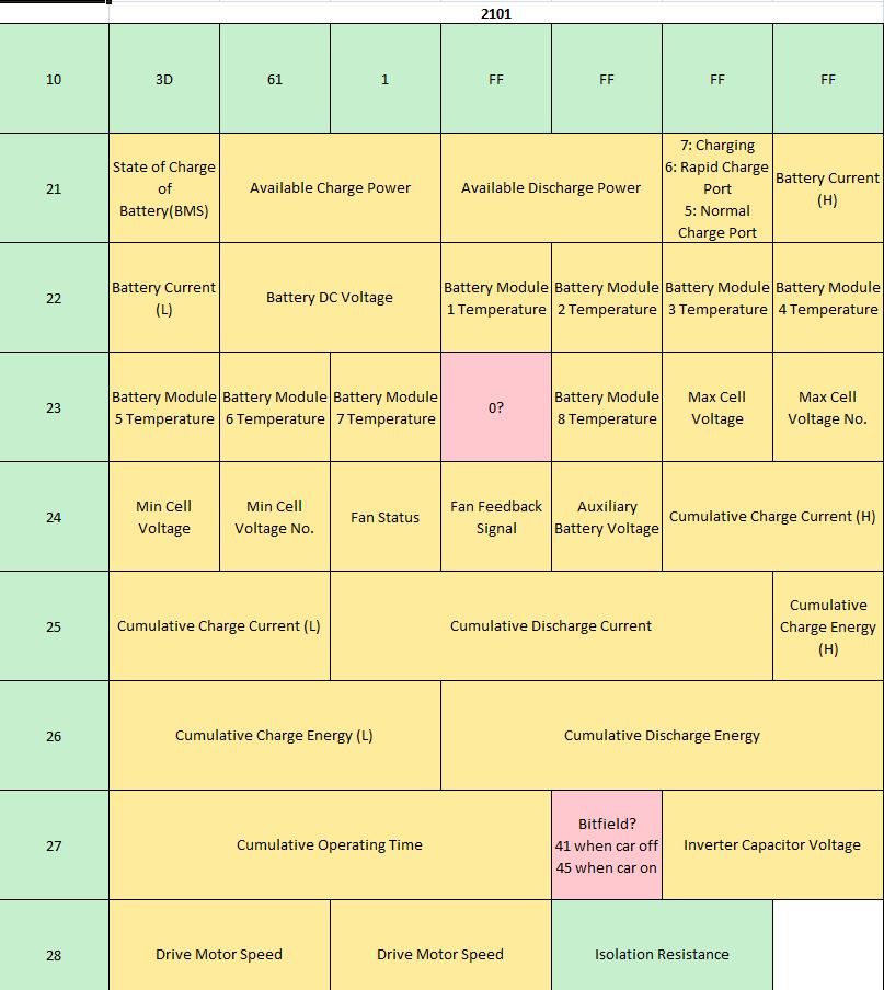

For instance, to gain "Maximum Battery Temperature", using Torque, I would ask for data from 2101 from device 7E4. I would set the data type as "signed", and ask for data offset byte O. I have attached a screen shot (courtesy of Kia Soul EV Owners forum) that shows the data at 2101.

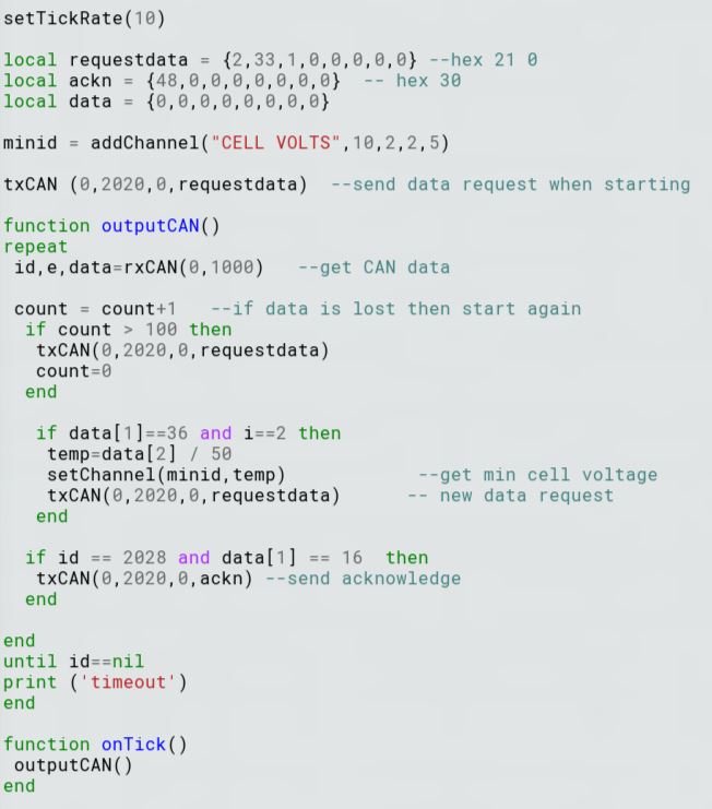

I thought I would post this code example to extract a piece of data from an OBDII Multi-Frame message and output it as a virtual channel. Hope this is useful.
This is very helpful; thank you.
