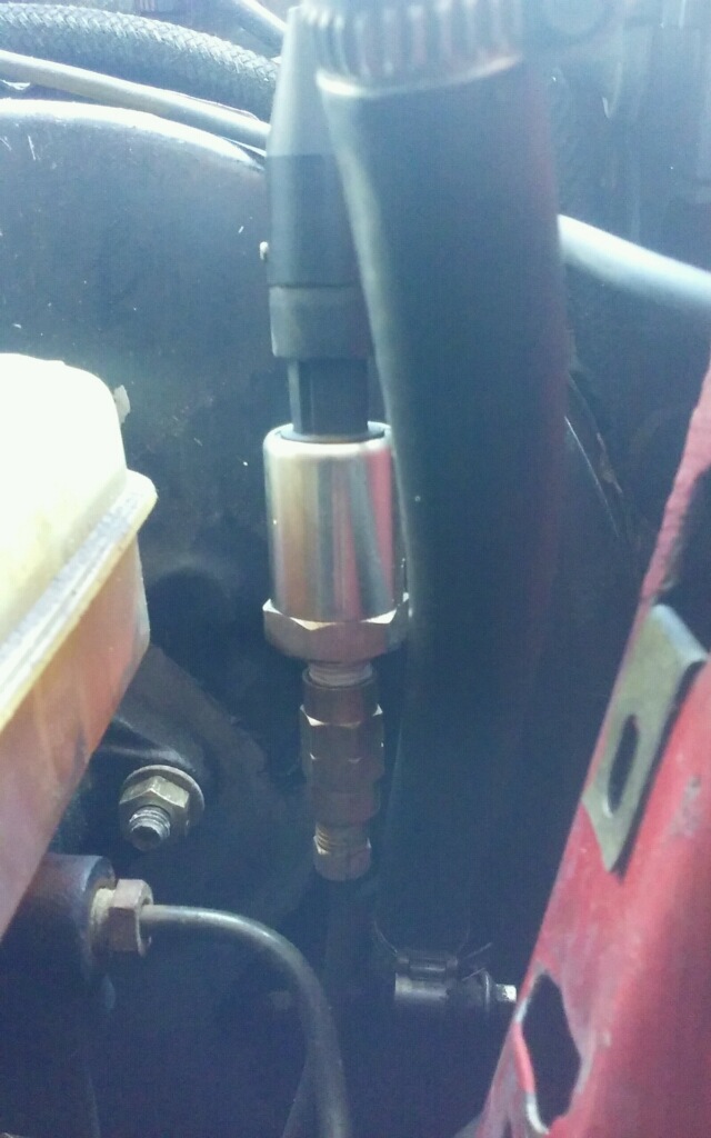

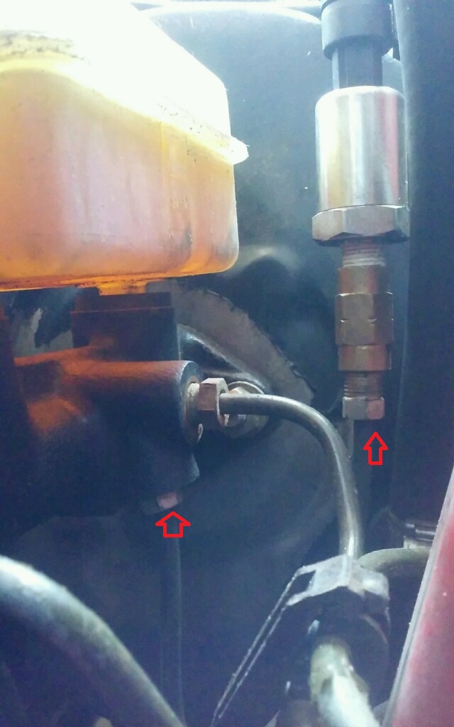

See the pictures attached for our break pressure set up.
We connected a 10mm bubble flare on a small break line to a free spot on the bottom of the pump. And then a 10mm to 1.8 NPT adapter at the other end.
- Break sensor 2.jpg (128.03 KiB) Viewed 24575 times
- Break Sensor1.jpg (126.45 KiB) Viewed 24579 times
