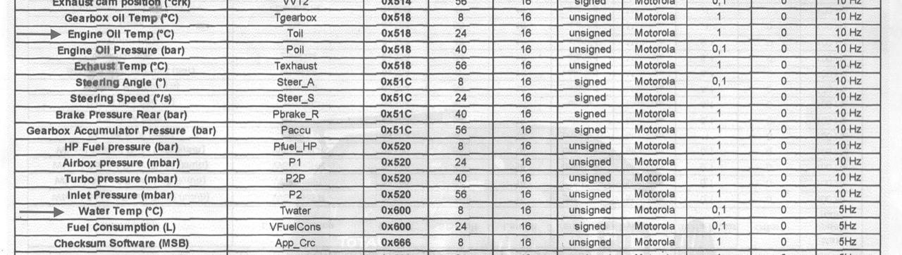

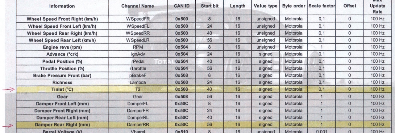

Hello,
I plan to do the first CAN mappings and have some issues in converting the doc from the manufacturer to the RCP MK3 parameters.
I attach 2 pictures of the manufacturer documentation.
Can anyone help me on how to convert this info to the RCP parameters, specially the 4 yellow lines?
They mention the Motorola byte order, what is that?
On the second picture, it is written MSB and LSB at the end of the channel name.
I guess it has to be related to the endian mode?
Thanks for you help !

So first you will need to convert that CANID from hex decimal to get the value you will need.
0x508 = 1228
0x50C = 1292
0x66E = 1646
Then you will want to select the "bit Mode" box
Startbit = offset
Lenghth = length
Select signed or unsigned based on the table
Edian = Big (this is what the motorola/MSB format means)
Scale offset will be what you multiply the value by
offset after that will be if you need to +/- in that data equation.
Good luck!

Thanks for your reply kijones.
I was not converting the CANDId, there my mistake.

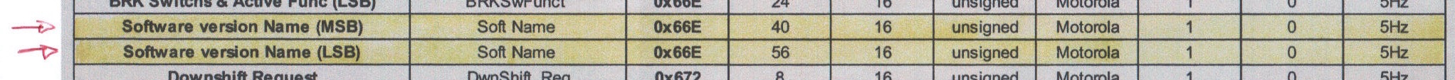

One additional question: on my second picture, There is the SOFTWARE VERSION NAME parameter which is listed twice. One with MSB at the end and the second with LSB.
Does MSB means BIG endian as you write and LSB SMALL endian ? If this is the case, do you know why it is also written Motorola for the byte order for the second one (LSB)?
Regards

MSB vs LSB
Most Significant Byte vs Least Significant Byte
Just determines what the first byte of the data is starting with, like reading right to left vs left to right.
It looks like the two channels that you have highlighted in the second pic are the exact same thing, just broadcast in a different patters. I'm guessing they did that so that if your setup was only able to read data in MSB or LSB that you could still get the reading. But you do not need both of them
Motorola format is Big Endian or MSB, unless otherwise noted most of the time. Again, i'm guessing, that is why they specifically called out MSB and LSB for those channels.
