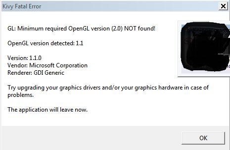

Analysis could not see on RaceCapture APP for Win7
i had simular situation.
U can see above title.
