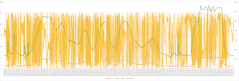

Here's a chart of what I believe is RPM: Byte 3 (dark orange) is the most significant byte and Byte 2 (light orange) the lower.
Green is RPM decoded: ((Byte 3 * 256) + Byte 2)/4
RPM
RPM
RPM Decoded.png (231.94 KiB) Viewed 48994 times
