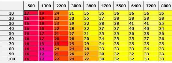

If I post my map on here , could you guys advise me which section to retard.
I know it's my responsibility. I'd just like to have a back up.

Retarding is meant as less advance, so if for example your ignition is now 31 degrees at 10% load at 3000rpm you make it 30 or 29.
You have interesting bins at 8000rpm. I don't know if you rev that high, but is the retard as compared to the 7200rpm column meant as a soft rev limiter?
How does the engine pick up at low revs, no hesitation when you open the throttle? I guess not as you have quite a bit of advance, but should you experience it you may solve it by advancing at higher load, especially in the 500rpm column. As you open the throttle you may experience a short lean out of the mixture before the extra squirt of the acceleration pump arrives in the cylindres. A bit more advance may prevent this, as I have experienced myself. There are some inconsistencies in the 2200- and 3000 rpm columns at higher load. Was this done with a meaning or was it just forgotten to retard ignition there?

I should have mentioned that bogg brothers timed it up to 6500rpm. There is rev limit at 6500rpm.
They just put it on thier rollers and timed it up with the bike carbs.
Their only one of few in the country that specialist in setting up bike carb n tuning megajolt.
I will be installing Phormula knock detection unit (cost around £400). I wonder if I can adjust it at home.
