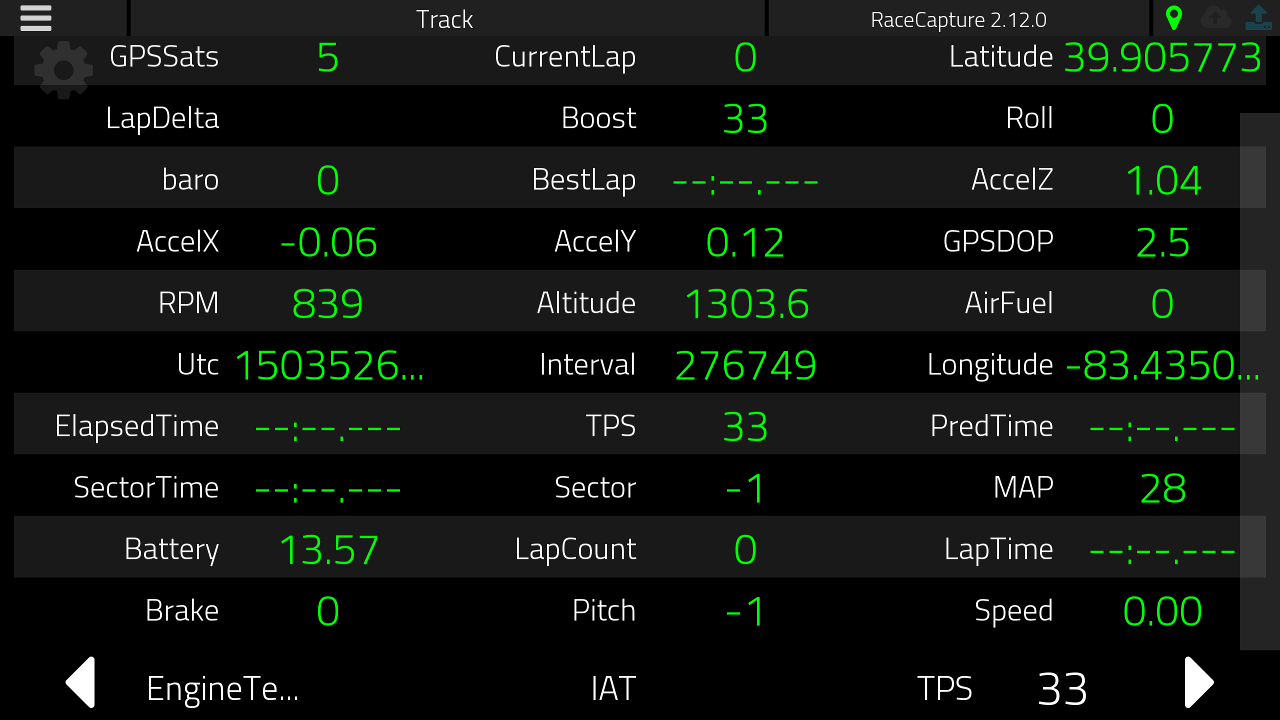

I am trying to add Boost pressure to my RCT. I have an OBDlink MX that shows calculated Boost, which I assume it takes the MAP and subtracts the BARO. I have unsuccessfully tried to add BARO which I assume is PID 33, mode 01h, 0 on CAN ID, Formula is Raw X1 /1 +0. MAP is showing around 28 to 29.
So even if I can add those, how would I set it up to estimate my boost pressure? Sorry, I am new at this, but I am used to plug and play, and adding custom PID's is a little challenging for me.
This 17' Honda Civic is being a PITA with them not releasing PID's for their car. On the dash of the , it can show Boost pressure, brake pressure & throttle, but only on their own screen. Also, my TPS is showing around 33 to 34, and I know it is incorrect, at Idle it is usually 12-14.
I am trying to get the 17 Civic Data up and working first, then I am going to work on CAN data for our 04 GT3.

Attached is a screen shot of what was showing.
RCT for 2017 Honda Civic
- Screenshot_20170823-182236.png (214.95 KiB) Viewed 20246 times

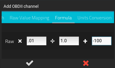

Calculating boost based on baro pressure:
As you know, boost = map sensor value - barometric pressure.
At the moment, RaceCapture does not support the ability to subtract one channel from another in the OBDII mapping.

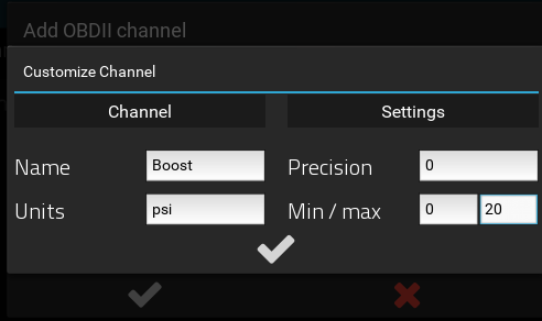

However, what you can do is estimate the barometric pressure - at sea level it is ~100 KPa (technically 101.3) You can modify your OBDII channel to subtract 100 from the converted MAP sensor value and then convert it to PSI (on the last tab). You'll also need to convert it to Bar (which is the 0.01 multiplier in the formula).
Finally, customize the MAP channel to be Boost instead, by pressing the gear icon next to the channel name.
Here's a table showing barometric pressures at different altitudes:
https://www.avs.org/AVS/files/c7/c7edae ... f87b9e.pdf
Hope this helps for now!

- boost3.png (15.61 KiB) Viewed 20241 times
- boost.png (14.24 KiB) Viewed 20244 times
- boost2.png (12.41 KiB) Viewed 20244 times

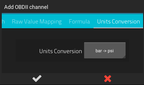

2017 Honda Civic Type R
Settings to show my Boost pressure:
OBD2 PID: 11
Mode: 01H
CAN ID: 0
Mask: 0
Offset: 3
Length: 1
Source: Unsigned
Endian: Big
Formula: RAW*0.01/1.0 + -1.0
Conversion: BAR->psi
now to work on the other settings
