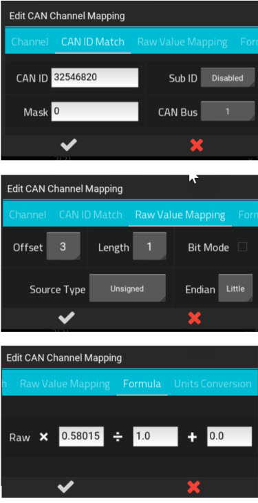

Cool. Can you show your mapping config, or attach your racecapture config file here?
wolfe83
Posts: 10
Joined: Tue Dec 19, 2017 1:57 pm
Post by wolfe83 »
Here is the mapping. Thanks
