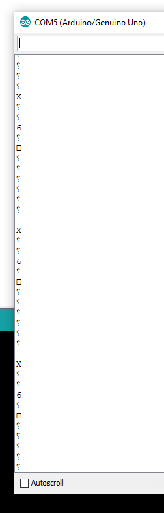

I'm trying to use the Aux serial port on my Racecapture Pro Mk2 to send data to an arduino uno. I know thw racecapture is sending the data but it's showing up as gibberish on the arduino.
Baud rate is set at 9600 across the board. I have the aux TX pin going into the TX pin on the arduino (pin 1) and the RX into RX (pin 0)
Is there anything I'm missing on this? I tried switching the TX and RX but with that, nothing showed up.

Arduino serial output
Looks like a baud rate issue. Have you tried different baud rates on the Arduino side?
Also, you can get a USB to serial adapter for your computer as an alternate way to test, and use a terminal program to test your data output.

This is waking up an old thread but hopefully this may help others having trouble connecting devices with a serial interface (e.g. Arduino, maybe some gauges, etc.) to the RaceCapturePro Aux serial interface.
The problem is that the serial ports on the RCP and Arduino use different physical level (electrical) interfaces. The asynchronous serial protocol (baud rates, stop bits, etc.) riding on top of the physical layer is the same.
The RCP aux port uses an RS232 electrical interface with signals of -12V (logical 1) and +12V (logical 0).
Arduino COM ports use a TTL electrical interface with signal levels of +3.3 volt (or 5 volt) for a logical 1, and 0 volts (e.g., ground) for the logical 0.
It is necessary to use a signal converter to communicate between the two systems. Sparkfun Electronics (and many other places) sell these (https://www.sparkfun.com/products/449).
For you electronics gurus, I found inverting the signal with a simple NPN transistor circuit (with resulting voltage levels of 0 and 12 volts) also works for transmitting data from the Arduino to the RCP. A second circuit for transmitting data to the Auduino should also work, but I've not tested that. In any case, your mileage may vary.
Without a converter for the electrical signals the devices will never communicate and the mismatch may cause damage.
A good description of the issue is found at https://www.sparkfun.com/tutorials/215
John
