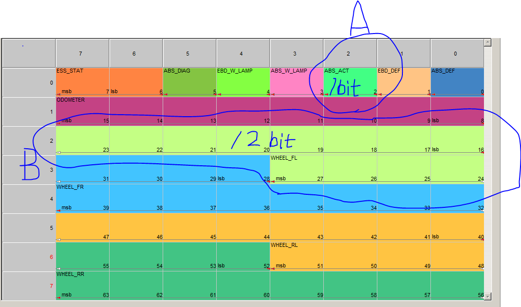

i could directly see CAN mapping data for 1 or 2 length(1(8bit) or 2(16bit) byte).
i want to see except 1 or 2 length.
For example 1 bit type and 12 bit type.
You can see attached file.
Could you tell me how to set them?
1bit pattern , 12 bit pattern

If check the Bit Mode , how to input Offset and Length in A and B case.
( For example , A case Offset= ? Length=1 .
B case Offset=? Length=12 . )
ferg
Posts: 36
Joined: Mon Dec 03, 2018 7:56 pm
Location: Paso Robles, California
Post by ferg »
When it Bit mode, the offsets are in bits (0-63), and the lengths are in bits as well.
I would try the following:
Case A: Offset 2, Length 1
Case B: Offset 16, Length 12
David Ferguson

One thing , regarding your advice about below.
i think Offset is 6.
Which is correct?

Post by ferg »
Well, there is a little "2" in the lower right corner of that box that represents the bit number. I would say (and I did say) it would be 2.
But you have the case to test.
Which one works?

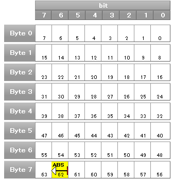

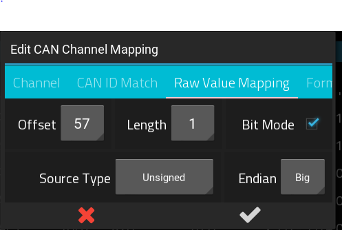

Takabayashi
Posts: 21
Joined: Tue Nov 13, 2018 5:23 am
Post by Takabayashi »
Hello Ferg-san,
Thank you for quickly reply.
Actually , i try to other vehicle.
i attached 2 mapping. One was done, other is not....
i think this case can ignor little endian and big endian.
In this case i could see signal.

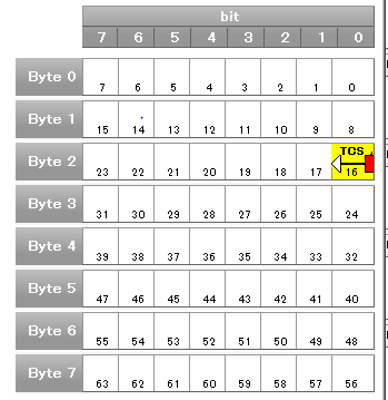

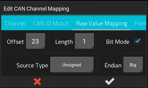

Takabayashi
Posts: 21
In this case , could not see signal.
But i think mapping will simuler before case.
