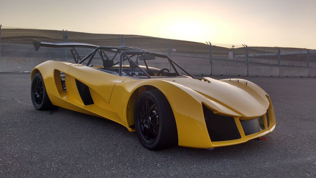

I'm installing a RCP Mk III into a Palatov D2 with roadster bodywork.
The car is powered by a GM LS3 E-rod crate motor, so it has OBDII. The issue is the original instrumentation package (custom-made for the car) did not work reliably for me. Palatov have since moved on to Aim dashes. I decided to be different and go with RCP. I plan to use this car as a test-bed to get familiar with RCP.
If this goes well, I may migrate my Spec Racer Ford over to RCP. It's part of a larger effort to get on top of data acquisition. I like Aim's hardware, but Race Studio's interface leaves a lot to be desired, not least of which is the requirement to run Windows. RCP appeals as an open platform with a modern software stack.
One wrinkle: my car is open cockpit. Since most of you guys out there have tin tops, let me explain what the two big issues are:
1) The dash is almost always in direct sun, and most phone / tablet LCDs are just too dim to be read in sunlight. On top of this, they are often highly-reflective which makes the problem worse.
2) When we drive in the rain, everything gets wet, and so everything must be at least water resistant, if not outright waterproof.
On the other hand, this car has 430HP, and weighs 1800 lbs, and is currently running slicks. I'm not *planning* on driving in the rain any time soon. I just don't like the idea of having parts on the car that can't get wet. But waterproofing is the lowest priority.

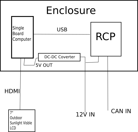

So I've settled on the following configuration. It might seem the obvious way to do it, but it never hurts to think things through up front:
  • Using off-the-shelf components as much as possible. Keep modifications and fabrication to a minimum.
  • We need a single-board computer to drive the display.
  • Both RCP Mk III and SBC will be contained in a single enclosure, which should be metal to help eliminate noise.
  • I am opting for an internal DC-DC converter, so there an be a single 12V connection for power.
  • The enclosure will be water-tight, with some kind of cable gland to seal the HDMI, power, and CAN connections.
  • I will consider the effects of mechanical vibration and heat on the components.
Here are the questions at this point for which I invite suggestions from the readers:
  • Which single-board computer will I use?
  • Which enclosure will I use?
  • Will I power the RCP from the RJ45 port, or the molex connector?
  • Will I supply CAN from the RJ45 port or the molex connector?
  • How will I pass the HDMI signal through the enclosure?
  • How will I keep the size down?
  • Will I have issues with the internal USB connections? (Here I am thinking mechanical vibration.)
Each of these issues has multiple solutions, and it's hard right now to see what the best answers are going to be because essentially everything is on the table at this point. I don't know, at this point, which issues will be the hardest to address.

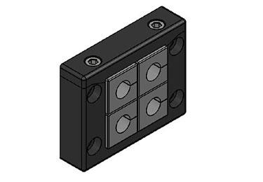

High-End Split Chord Grips / Glands / "Entry Plates&quo
Post by emdash »
For those not familiar, a Chord Grip a.k.a. cable gland, is just a way to run a cable into an enclosure that's fast and easy and water-tight. Normally this means the cable can't have a connector on it, otherwise there's no way to pass it through. But there are split ones. I just can't seem to find any.
The only thing I can find so far are these:
https://trimantec.com/collections/all#/ ... Management
I'm considering just dropping the $50 it'll cost to get one of these, because it really would save time.

Post by emdash »
I got a bit further, good enough to validate that the overall setup works, not compact enough for the car in question.
The sad story is that I'm selling that car soon, so the immediate need for the project is gone. But I know a lot of people who build racecars, so I may find motivation to finish what I started.
I did make some real progress on the software side, and I'll be continuing to work on that independently. Keep your eye on uDashboard.
