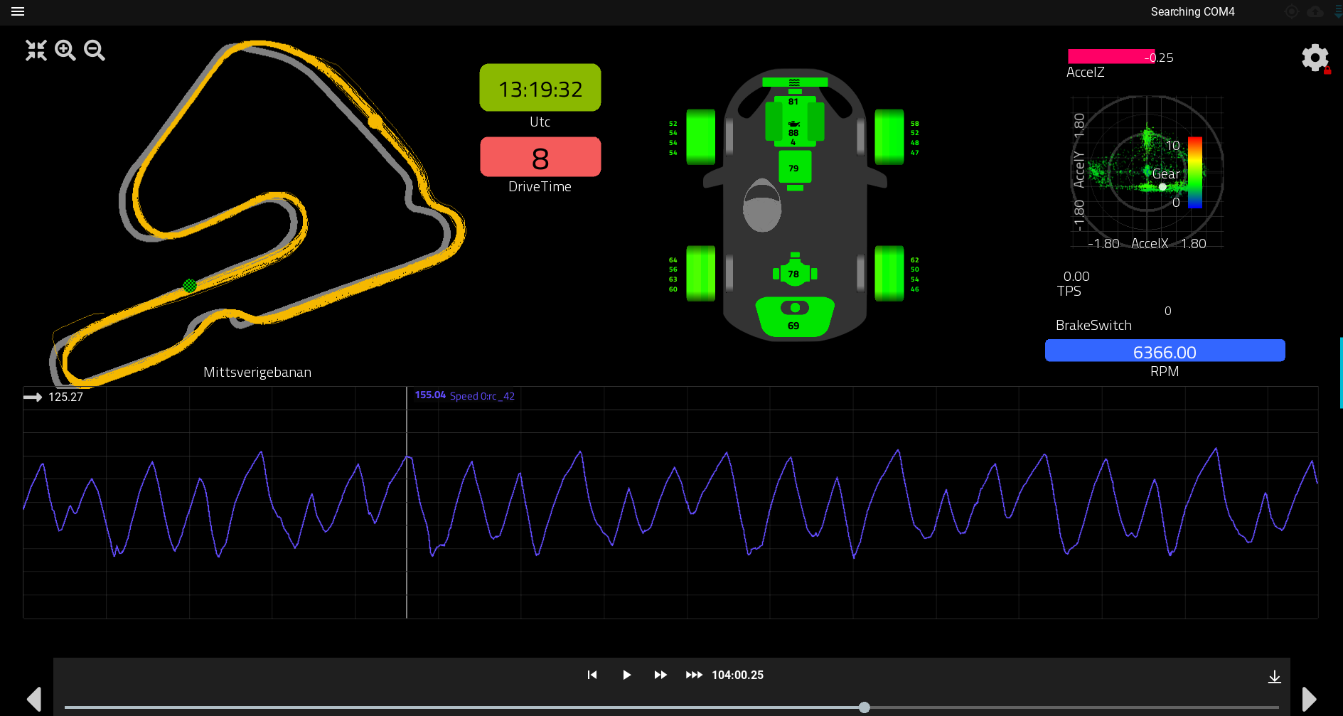

Hi.
1. When i zoom in the log Graph area it eventually disappear and then it goes in reverse at the map and data.
Don´t know how it handles short logs but in this exempel the log are around 2h and the zoom is not enough when it reversing.
2. Is it possible to change the color switch points at the tire temps?
The green gap is way to big to our tires.

1. Are you talking about zooming in on the line chart data? Can you explain in more detail? Is it from zooming in "too far"?
2. The tire temperature range of the overview gauge is not currently configurable.

Okey.
See this video.
No problem when analyzing a singel lap but when with endurance its very useful to zoom a lot.
https://youtube.com/shorts/UPTu-spo_kc
Re: Reverse when zoom and TireX Colors.
In order to get more resolution for your charts, you should break the data into laps. This is normally done when racing, because laps are calculated on the fly.
You can also recalculate laps after the fact in the latest app release; see: https://www.autosportlabs.com/racecaptu ... s-release/
