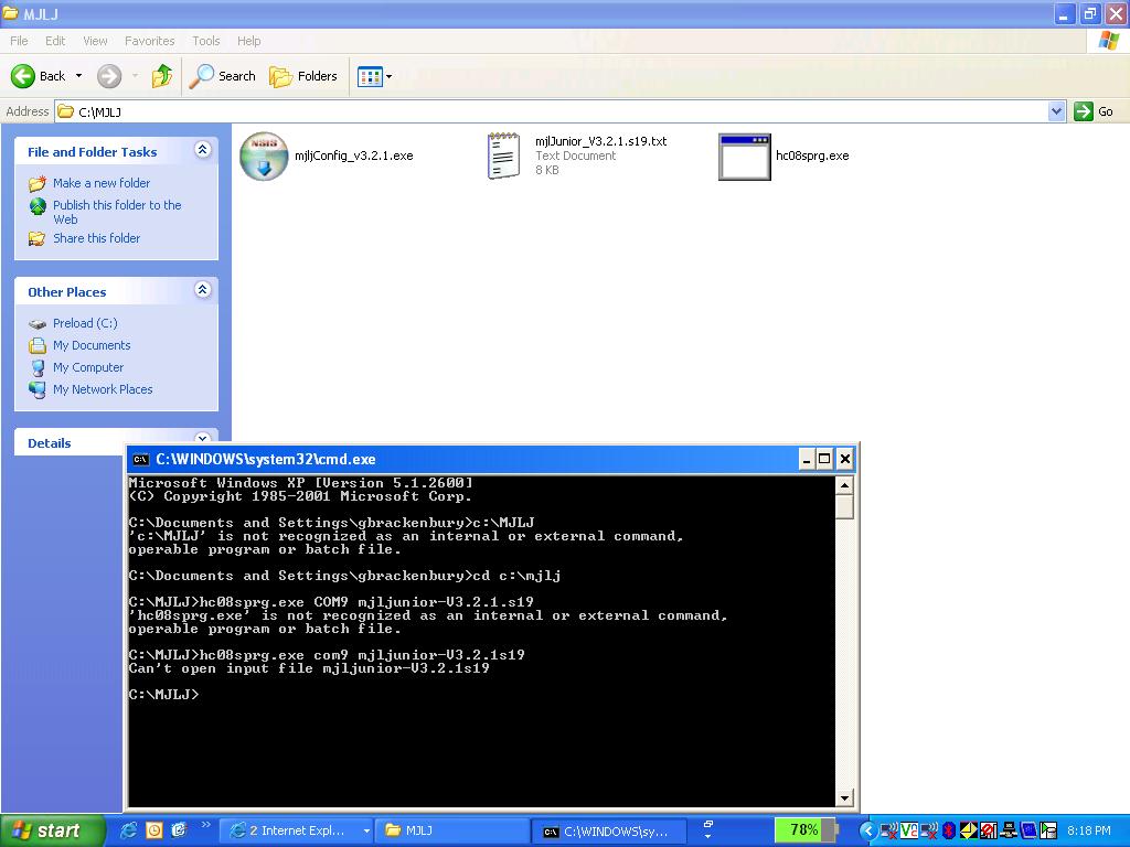

HI Brent,
ok well the serial cable i have is no good, its a male female so thats out, i have not tried the download but will soon, just thought i would give another update because when i try and get the config from the MJLJ i now get and error code of (87) the ign advance must be between 0 and 59 and all the cells are, so i dont understand.
see image
i do not know which cell to change and cycling the ign does nothing.
see image

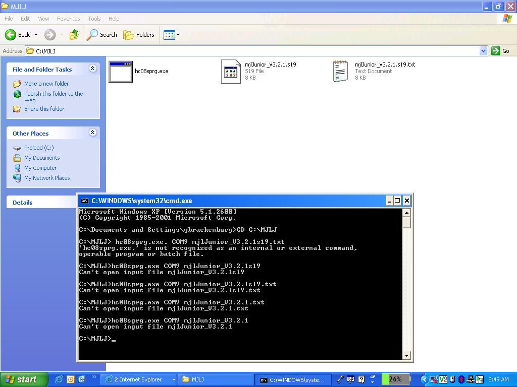

A couple of problems.
1. Your web browser saved the MJLJ firmware .s19 as a '.txt' file (see the name of the file in your screen capture of windows.)
2. You mis-spelled the name of the file in the windows command prompt. "Can't open input file..."
Try re-issuing the command with the file name: mjlJunior_V3.2.1.s19.txt
