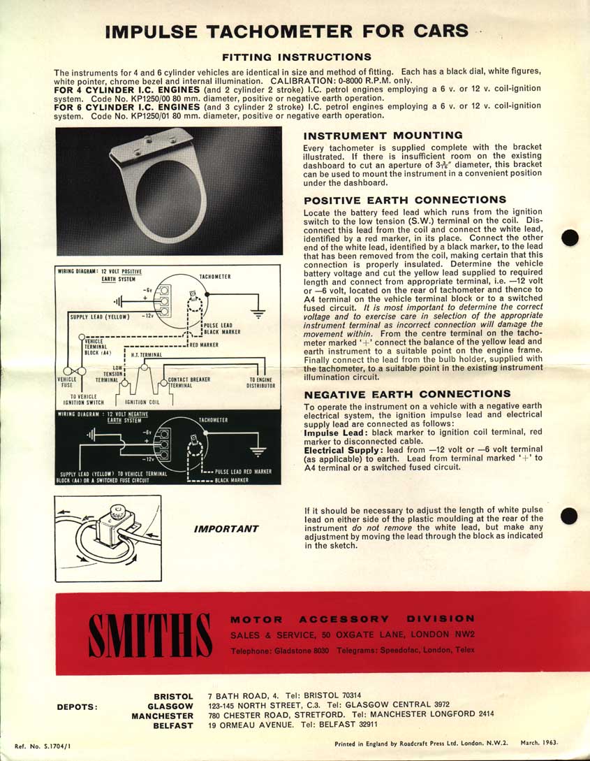

Recently I bought a Smiths tachometer and I couldn't make it work in anyway. After digging up few sites, I found attached brochure which shows wiring for both positive and negative earthed impulse tachs.
Maybe it helps if yours is the same type. I didn't know impulse tachs before and I was thinking that mine was broken. It worked great during my bench test.
Ibrahim
