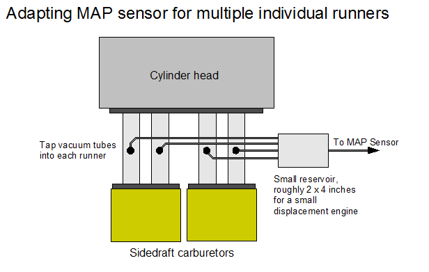

would this work?
or would the unequal lengths and the fact that the hoses join so close to the runners create a vaccum problem?
or would an idea like this work better?

Hi Julian,
Both hose configurations should be fine. What is more important is the mini-plenum to smooth out the pulses.

I had a muck about with your image, Brent, and came up with this option (don't want to tread on any toes though :lol:). Would this offer any advantage over the other arrangement? The reservoir would have a union per runner, and basically replaces the tee-pieces. If this format was employed it'd most probably be easiest to mount it locally.
As for the filling and emptying, on an NA car such as a twin-SU'd Mini, from the moment the engine cranks the reservoir would see negative pressure, and this vacuum would only vary, rather than fill and empty and at worst would take split-seconds to catch up. Provided the reservoir is not overly large, there'd be no problem at all - between 1/4 and 1/3 of engine capacity would be perfect.
Individual signals to reservoir.
In further thought, I think your proposal has the edge in being more 'technically correct'- I'm trying to picture what the individual runners are doing on the 4 parts of the otto cycle. I'd like to replace the wiki image with what you updated, I hope you don't mind? :)
in any case, while one runner is drawing vacuum, another runner has it's intake valves closed, so atmospheric air pressure would travel from this runner towards the runner that's drawing vacuum. I think your modification has this path going through the plenum and seems more correct- but I'm not prepared to do the math on this. Perhaps direct measurement of both approaches might be interesting???
