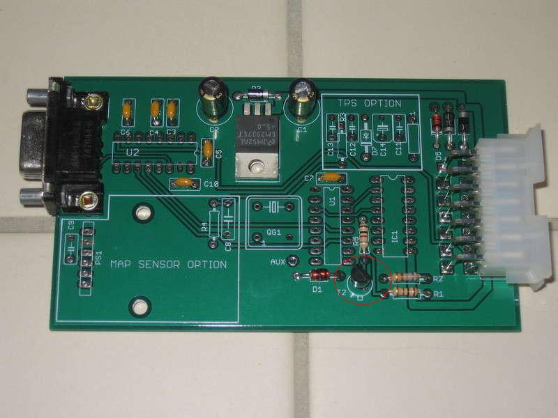

so it is the little switch in the ECU soldered into place T2???, see pic below, can i buy this part as my kit is completed already?
Nope, that transistor isn't related to map switching- and no board modifications are needed on the V3 controller to enable this feature.
Wiring the switch is covered in the Installation guide, here: http://www.autosportlabs.net/MJLJ_V3_ve ... E_3.1.0.29

ahh thanks Brent,
so i just wire it in through the molex connector and all should be good.
sweet i will look into it, this way i can have a low boost and high boost map to protect the engine on high boost and have a bit more advance for lower boost settings.

Yes, that is the way that you can connect the switch for a TPS installation.
For a MAP installation you can use the same connections but you have to add R3 (1K) onto the PCB to deliver 5v to the TPS Ref connector
