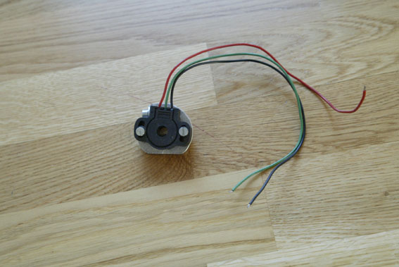

Is there an easy way to find out which wire is which on a TPS before I install it?

They've stated:
Black - earth
Red - positive
Green - signal
So, is Positive equal to Vref, and Signal equal to TPS input ? Or is it the other way around ?

Patriq wrote: So, is Positive equal to Vref, and Signal equal to TPS input ? Or is it the other way around ?
Exactly that....
