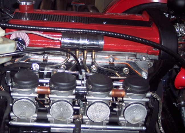

On a different part of MJLJ, I have attached a picture of the bike carb set up on my Zetec engine. All the manifolds were home made, using bits from the scrap yard, and the intake balance plenum is just an old piece of exhause pipe that I welded ends on, then polished. The whole set up looks good and works well, which proves that you don't have to spend loads of money buying manifolds etc.
All the very best, Bob
Thank you, ever so much for all your help (and patience) I truly would have been lost without you.
- Intake plenum.jpg (152.58 KiB) Viewed 25170 times
