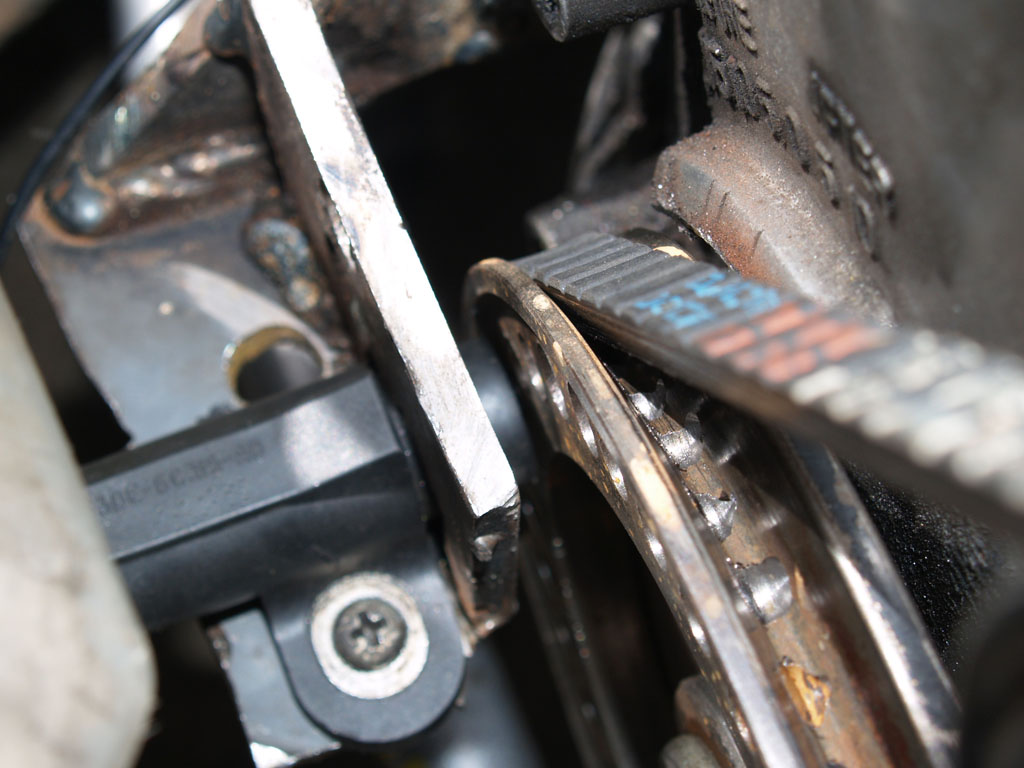

My Edis setup is backfiring through the Carby every 3-4 seconds on idle. It will also do this as it revs but not as badly.
I'm assuming this has something to do with the signal being sent from the VR sensor.
Is there any way of testing the signal without using an oscilloscope?
Are there any other things i could also check?

the most likely thing up with a vr sensor is not close enough to the wheel. i think brent actually commented on that from your photo, did he not? so a (possibly) easy thing to do is move the head of the vr sensor closer to the wheel, which would help if you are suffering an intermittent signal for that reason.

Thanks Alexander but i had modified the mount as Brent suggested.

Unfortunately, yes: if you're experiencing mis-firing, it's likely the EDIS module is losing sync with the trigger wheel. Does it happen when running on the EDIS alone (MJLJ disconnected) ?

Its difficult to tell from the angle of your photo there...
Are you sure the center metal pole of the VR sensor is aligned accurately with the center of the holes drilled in your pulley ?
It looks like the VR sensor may be aimed slightly *inside* the hole circles. that gap looks pretty wide too..
If they are off to one side, you probably wont get an equal positive and negative swing on the sensor signal, which will possibly confuse the EDIS.
Also, are the holes all accurately center drilled on a circle-line ?
For a hole-drill trigger setup like that, I would imagine that alignment and tracking would be very important, since the edges of the circular holes would give a more gradual sine-wave-like transistion signal between hole and metal as the circular hole sweeps past, whereas the usual square-cornered trigger-wheel setup would give a sharper edged transition.
A scope is probably the only way you are going to be able to check for certain you have equal positive and negative swing and minimal run-out on your trigger signal

Yeah i think a scope might be the way to go.
MY trigger wheel is by no measure "accurate"

Have you checked your grounds on the shielded cables for both the PIP/SAW wires as well as the VR sensor?
Do you have enough cable to re rout the shielded wires?
Have you put a tining light on it? What is the timing doing when it back fires?
Have you checked the plug wires? Ya I know probably dumb but I have to ask.
How far off are you drilled holes? From my limited understanding this could be critical.
Have you tried wiggling wires with it running?
