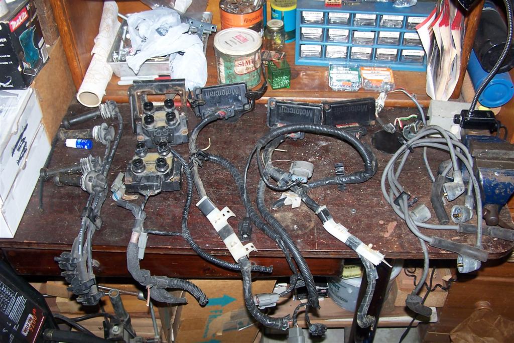

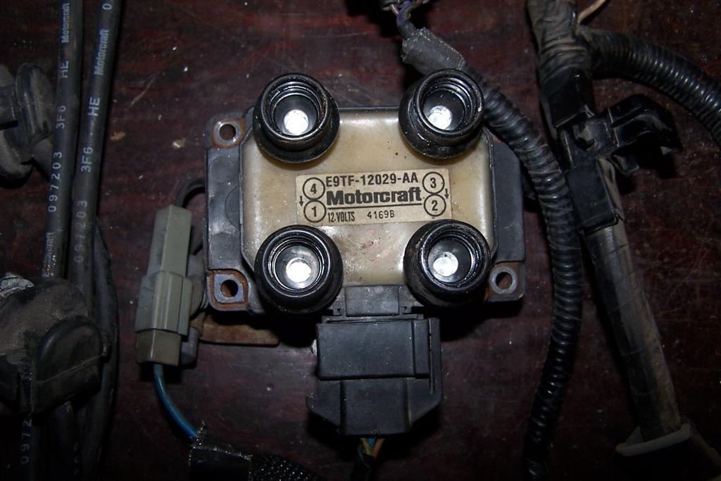

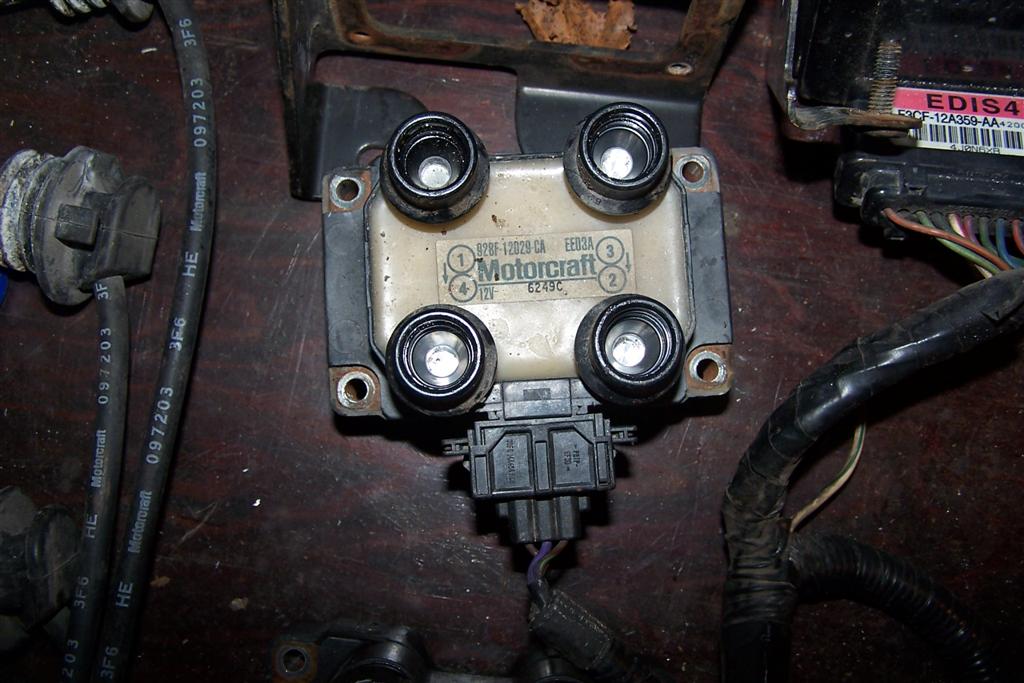

Note the difference in the coils
The one that is labeled
1 3
4 2
Is form a 97 contour. with the 2.2. It had no resister and it did not have an EDIS unit it was the later integrated control system.
The one labeled
4 3
1 2
Is from a 94 Escort Note the attached Resistor
1 3
4 2
The one labeled
4 3
1 2

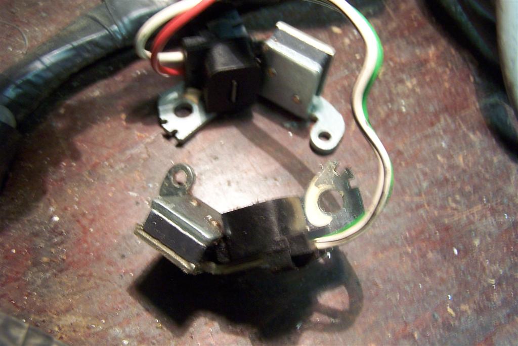

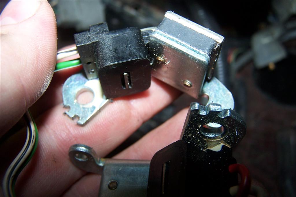

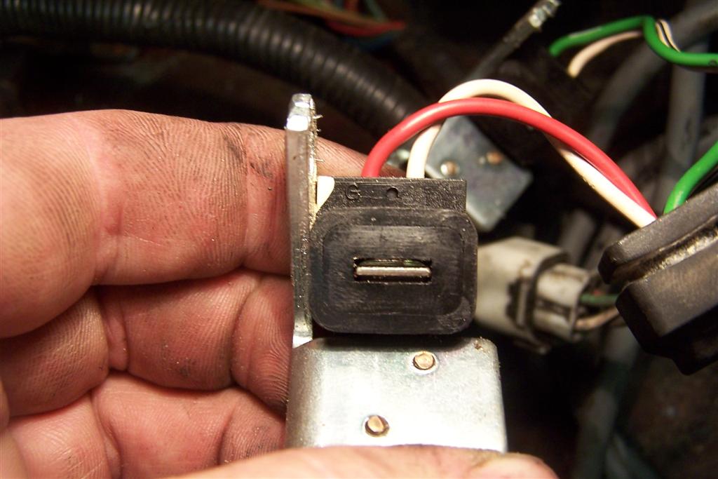

The RX7 VR sensors.
My biggest worry is that I will have to modify these to get them close to the wheel. They were against wheels taht are about 1.25 inches in diamiter. I will have a 3 inch wheel. Thus the angle of the mounting brackett may ahve to be changed / bent / adjusted. FOrchinitly I have two to play with. Another hote is taht these seem to be much easier to mount due to how the brackett is configuared. Additionaly they are MUCH smaller than the Ford unit I have I will get a photo of the twe units together and post it for comparison.

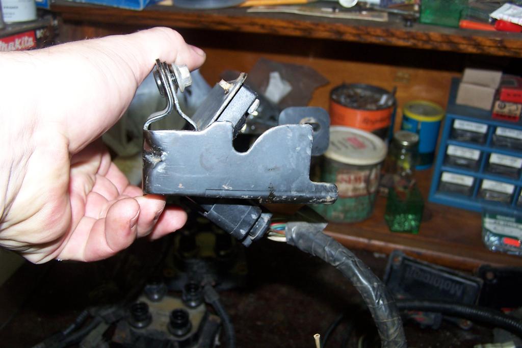

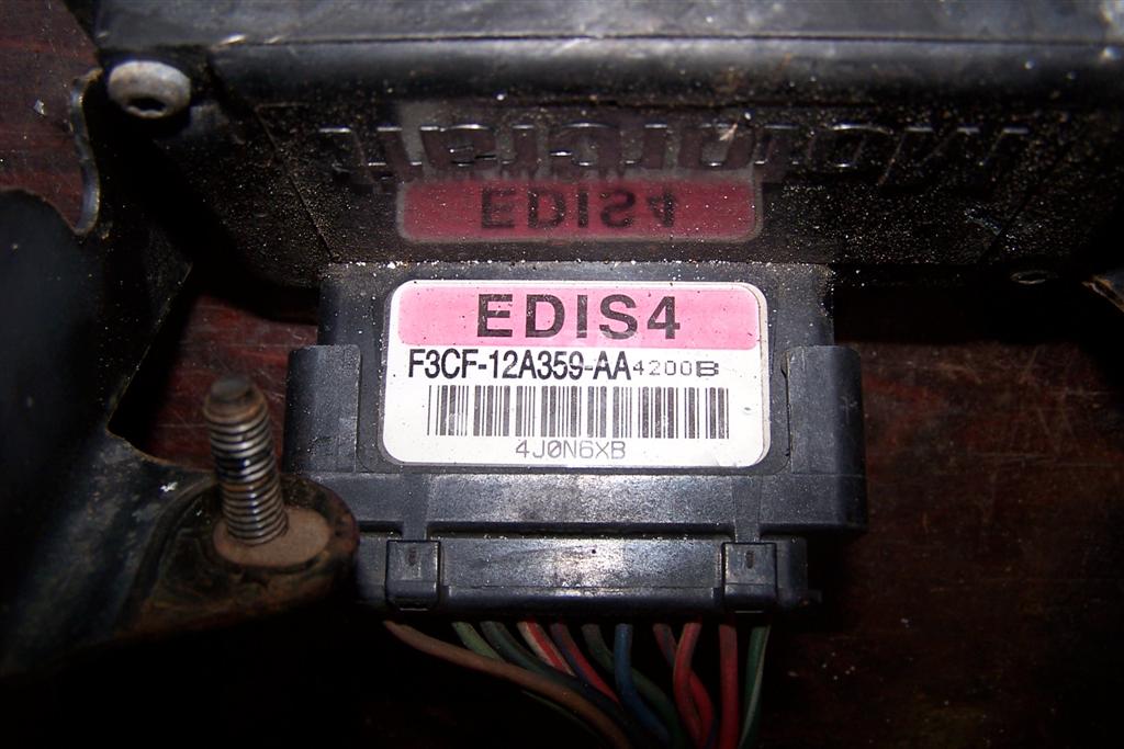

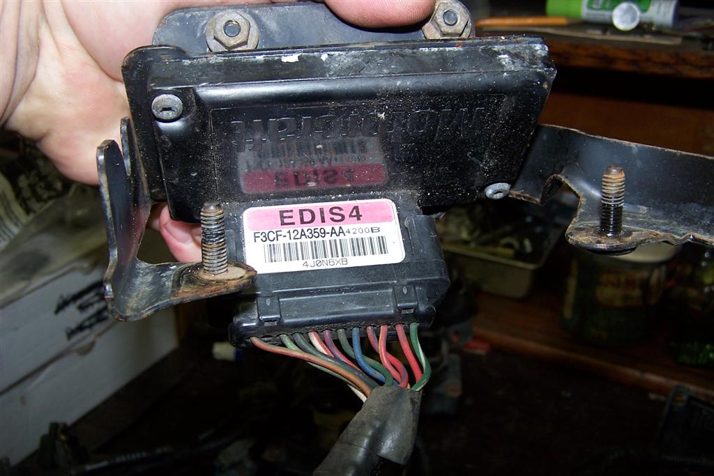

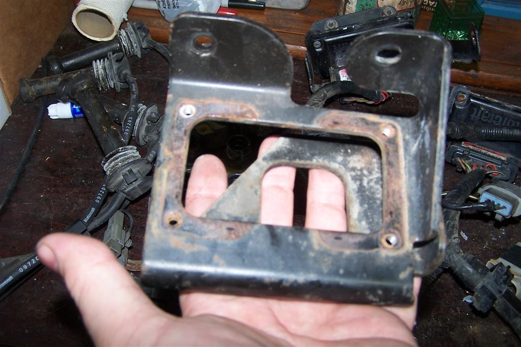

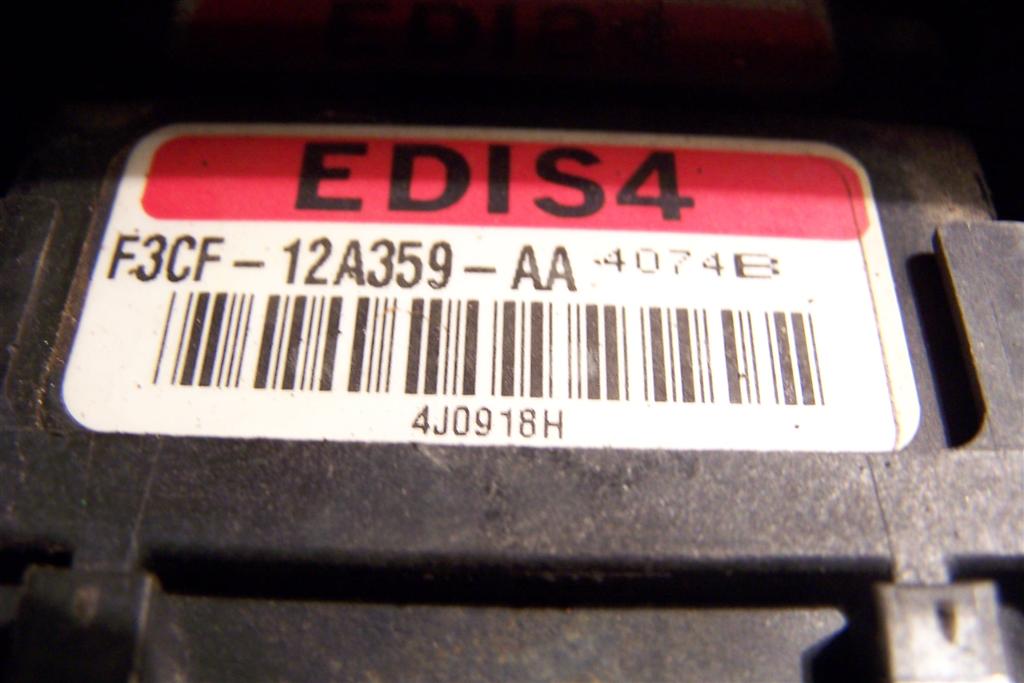

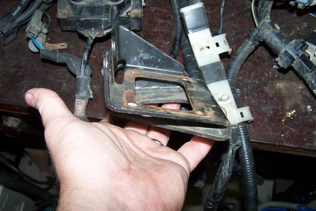

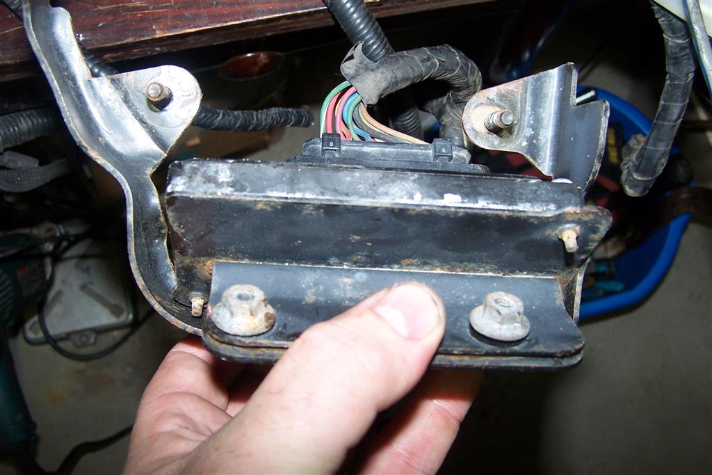

This I found interesting. I noticed that all the EDIS units are mounted in the escorts so that the plug is facing down. I assume that this is to make sure that water will not collect in the plug of the ellis unit and short it out. The photos are of the bracket that mounts the EDIS unit note the downward angle that the plug is mounted in. I don't remember this being noted in any of the information I have read but it may be a good thing to considder when mounting your EDIS units.
The first photo is looking down on the EDIS unit and the brackets. The other we are from the side and the front.

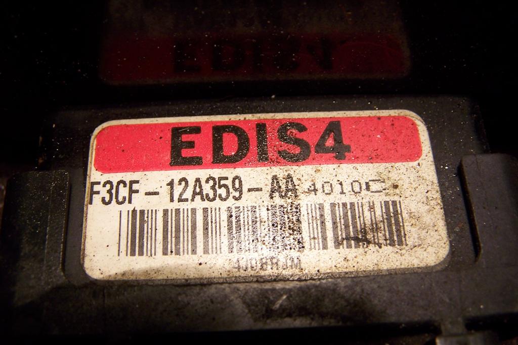

dean,
re the resistor... i am fairly certain that it is only for suppression of radio interference, and so has no importance for this application.
re the slightly altered marking on the sticker.. heaven only knows why the change, but it makes absolutely no difference. the '1' and '4' are just the opposite ends of a single coil, so it makes no difference at all which you consider at 1 or 4.
re the mazda sensor... just as a matter of interest, did you select that because i showed it in a couple of my threads, or did you independantly know of it? i only knew of it because someone else who had made the same conversion told me. just curious...
anyway, if you didnt have good look already, see this post:
http://www.autosportlabs.org/viewtopic. ... ight=#9080
where patriq had put the same sensor on the edge of 90mm / 3.5" wheel. so i am sure the mazda sensor will fit your 3" wheel.

alexander,
I actually know alot about the Mazda units I have raced FC's for many years. I use to do motor swaps in my IT prepared FC in a mater of hours. (missed shifts are a bad thing). I did not however immediately think of it. It was reading threads here that jogged my memory. I was actually thinking of using the cam position sensor from the 1994-1995 3.8 V6 ford Mustang. It is similar to the Mazda unit as it is mounted where the distributors were in the older 3.8's They don not have a tooth gear in them there is a cup shaped piece of metal that spins by the sensor. I think it is more of an on off or high low wave of long duration. They are also a very small sensor I just dont know what there resolution is. There are two of them. An early and a late model. I suspect that they would work. I know where one is in the junk yard and I may go get it and try it. However I really like the Mazda units. They are so much easier to mount than the ford units. The other thing that swayed me was that it has been tested here with positive results. This was a big factor in my decision to go that rout as well as I knew where two were in the local yard. Has anyone tried the Mazda unit on a standard ford trigger wheel?

The trigger wheel must be constructed with 36 precise, evenly-spaced teeth, with one missing, giving the required 36-1 pattern.
If the teeth are slightly off you will have errors in ignition timing. If they deviate more significantly, the EDIS module will lose sync with the trigger wheel, resulting in loss of spark.
Does it measure the spacing or does it just count the teeth? If it just counts then all you would have to deal with is the offset in the tooth count versus degrees from TDC on the trigger wheel.brentp wrote:The trigger wheel must be constructed with 36 precise, evenly-spaced teeth, with one missing, giving the required 36-1 pattern.
Also how does it determine RPM. it it is based on the tooth spacing and its relationship to the -1 then this could be an issue if is only notes the timing of the -1 in relationship to the previous -1 then it should work.
Brent can you explain how the EDIS "sees the trigger wheel?
I am going to have to try this on the bench and see what happens. If mount the gear on a drill and spin it by a fixed VR and vary the rpms I would be interested to see if the EDIS keeps up with it. I then could put a light on the plug wire and see ff it holds a constant timing mark over the RPM range. Dang it so many things to try and so little time.
