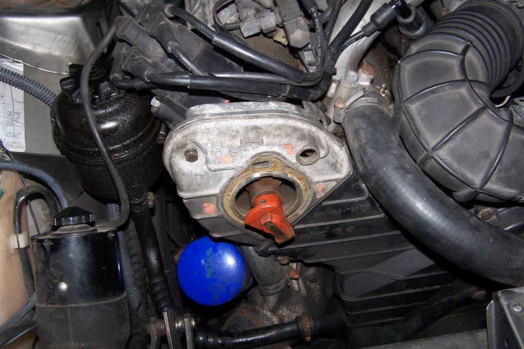

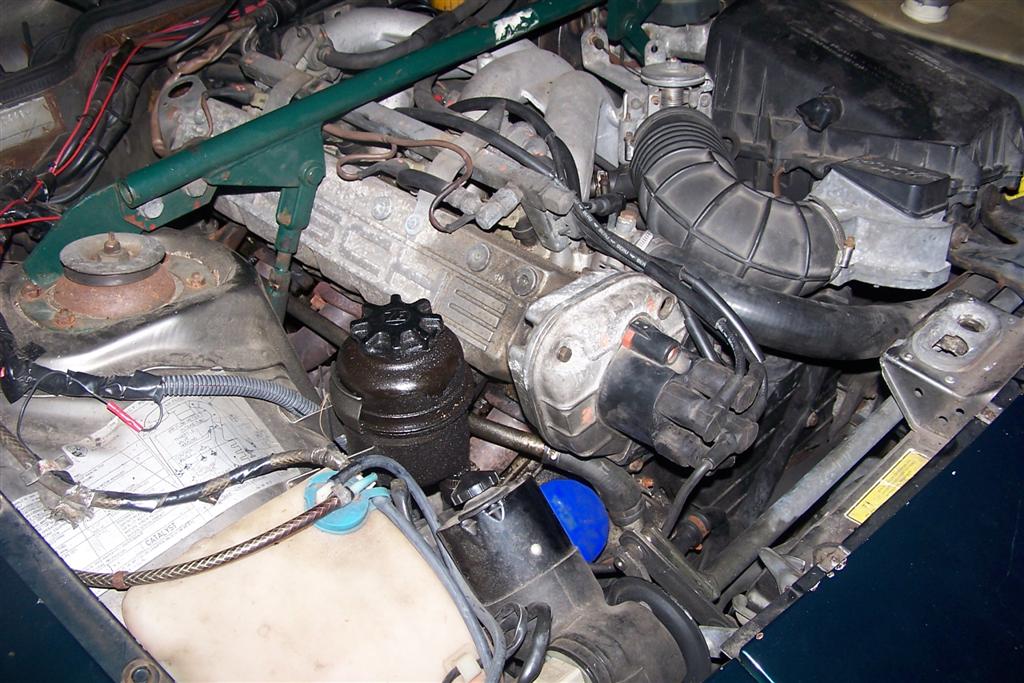

First off what got me started.
For those that know 924s/944's we are cursed with the Bosch motronic system that uses two VERY expensive speed and reference sensors that tend to die. There replacement cost is in the neighborhood of $150 each and two are required. So with that budget in mind and knowing how all of the other fords that I have had over the last 25 years or so have never had ignition problems I set out looking to swap a ford based ignition in my 924s. This is how I stumbled on Megajolt as I was already familiar with the MS systems.
Train of thought that I had (kind of).
1. Installing a 36-1wheel on the crank of a 944 is a bit of a nuisance due to how the timing belt is installed as well as how the power steering belt pulley is installed. Add to this how both the harmonic balancer and the two pulleys are sandwiched together and there relationship to and how they are secured to the crank and how this is also being intricate to the proper function of the oil pump make this a not so fun place to try to install the 36-1 wheel. Long story short I really don't want to mess with this unless I am doing my timing belt.
2. Along with the elimination of the speed and reference sensors the installation of an EDIS based system would also eliminate the stock cap and rotor that are mounted to the end of the camshaft at the front of the motor. Due to the problems with mounting the wheel noted in #1 above this in turn becomes an ideal physical location to mount the wheel and the pickup. However since the cam is only rotating at half the crank speed this means that stock 36-1 wheel will not play well with the EDIS unit due to it turning at half the crank speed. Or so I thought. It should be noted that I thought a possible solution to this was to make up a 72-2 wheel. This is still a possible way to go but for now this has been shelved and will be pulled out and dusted off and implemented with a standard edis-4 unit and a standard 4 cylinder coil pack.
3. A the same time I was mulling over #2 above I it occurred to me that if I wanted a true COP set up on my 4 cylinder I wold need the EDIS-8 unit as it has 4 coil drivers.
Then it hit me! If I install the 36-1 wheel on the cam and use an EDIS-8 unit I will end up with each of the coil drivers firing only once per 720 deg of crank rotation. This would make a true COP possible on a 4 cylinder motor. So next came the plan.

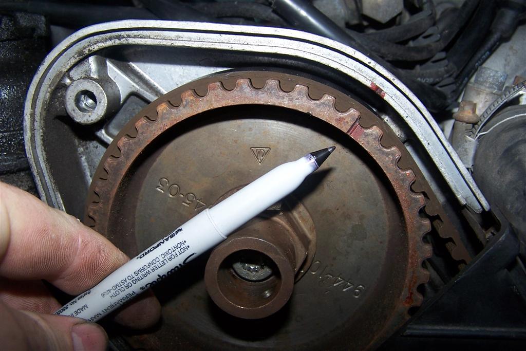

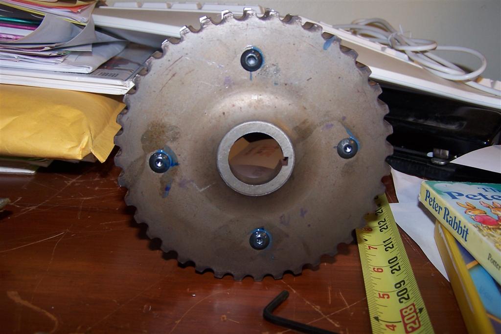

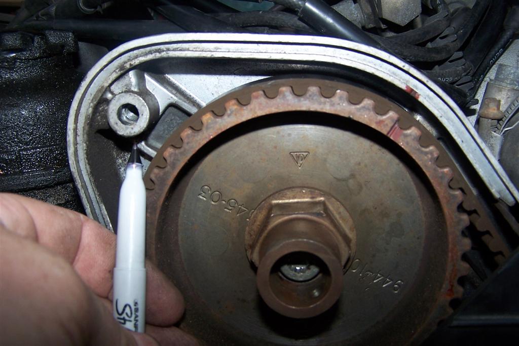

The plan:

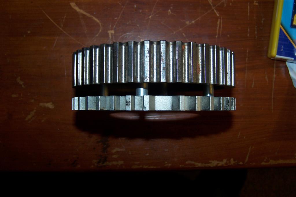

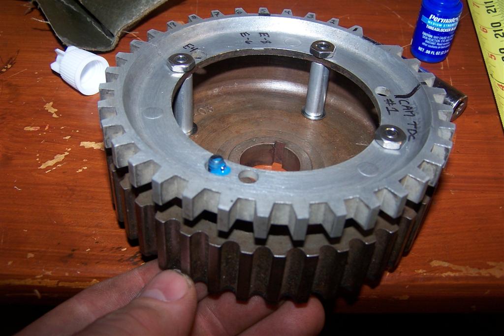

Mount 36-1 gear to the cam. Because the cam is spinning at half the crank speed it would cause the EDIS-8 to only initiate a spark once for every coil trigger / connection for every 720 deg of crank rotation. This in effect eliminates the wast spark/allows for potentially true COS. This also allows for what looks to be a very easy installation of the wheel and sensor as it is at the top of the motor at the front of the engine bay and in the location where there is currently cap and rotor.

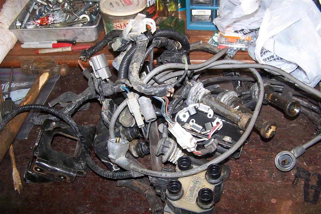

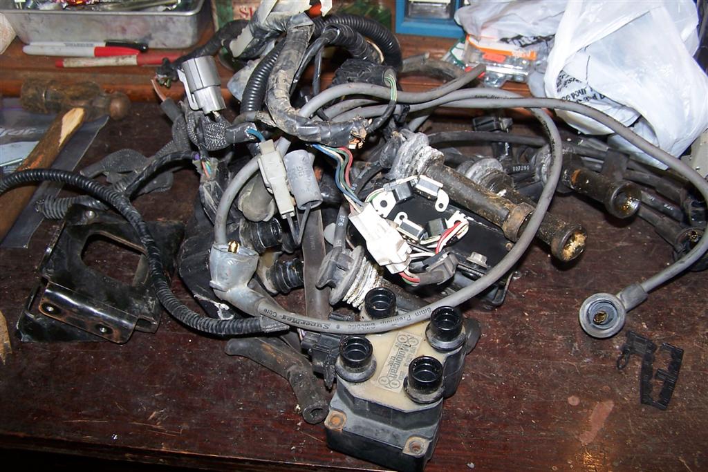

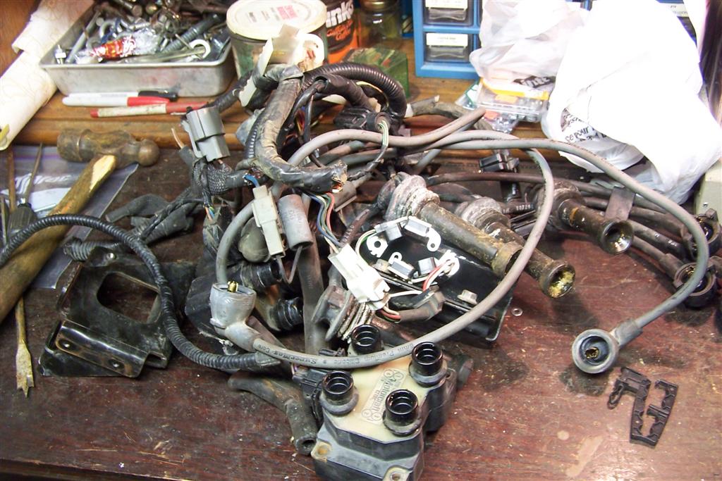

I have the 36-1 wheel and the pick up from a motor swap i did in the wife's mustang sitting on the shelf.
I would use COP coil units from a ford 4.6 V8. (I have 7-8 spares for my 2000 expedition I have accumulated over the years. Picked most of them used from ebay really cheep.
Spark control would be by megajolt v4 with the MAP sensor. I have a M62 based forced induction project all but completed for the same car.
I have an EDIS-8 unit form the junk yard.
I need to get wiring harness pig tails for the EDIS, the pickup and the coil packs

RPM would be half if based on the wheel. An issue?

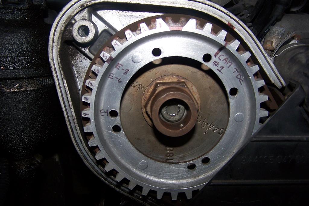

How many teeth off from the missing tooth would I mount the sensor? 5? in keeping with it is an edis 8? or would his mess up the default. After thinking about this I believe it to be 5.
Timing: Since the cam rotates half as much as the crank I would assume I would need only half the timing when tuning. IE: 10 deg btdc on the crank is only 5 deg on the cam. This would mean I could (in theory) put in or pull twice the crank timing as the EDIS timing normally would allow. Because of this how do I mount my sensor? still ten degrees off of TDC on the 36-1 or should I cut that in half as well. Thinking more about the I am convinced that I would want to mount the sensor at 5 deg before TDC on the cam giving me an effective 10 deg on the crank. This would allow the limp home function of the EDIS to would work.
Can I revamp the maps in megajolt to take into account the cam rpm is half the crank? (ie 3000 rpm on Th cam is 6000 rpm at the crank) Would my maps only go up to 3250 (the cam rpm redline of this motor)?
Same for the timing and the megajolt maps. Assuming that I will have to position the sensor at 5 deg BTDC on the cam to get an effective 10 deg BTDC on the crank. I assume that my timing inputs would be half that of a "normal" installation/setup?

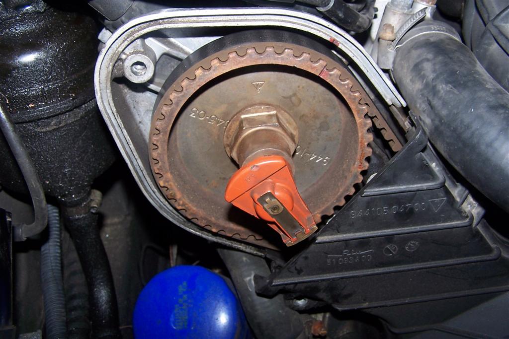

The ease of witch I can mount to the gear to the timing belt pulley where the cap and rotor are now and having one coil per cylinder that is not wast spark is enticing. Definitely not better than a crank fired wast spark system but it would be a leap forward form the stock set up and would get rid of the speed and reference sensors that are the bane of 944 most owners existence

An update with some photos of the wheel mounted to the cam gear.
- 2008-11-08 EDIS Porsch cam wheel 001.jpg (65.57 KiB) Viewed 378142 times
- 2008-11-08 EDIS Porsch cam wheel 009.jpg (91.25 KiB) Viewed 378143 times
- 2008-11-08 EDIS Porsch cam wheel 011.jpg (86.19 KiB) Viewed 378147 times
Respectfully
Dean
Dean
And a couple more of other things - Sensor mounting location and tdc on the cam. The nice thing about cam mounting is you can not be 180 out.
Also a mockup of the wheel in place. getting the alignment corect for mounting the wheel to a spair cam gear I have shown in the previous posts.
- 2008-11-08 PORSCHE-EDIS 046.jpg (108.01 KiB) Viewed 378128 times
- 2008-11-08 PORSCHE-EDIS 045.jpg (98.29 KiB) Viewed 378129 times
- 2008-11-08 PORSCHE-EDIS 006.jpg (108.52 KiB) Viewed 378130 times
Respectfully
Dean
Dean

Arrrrrrrrrrrrrrgggggggggg.. .. Avast ye land lubbers we pillaged and had a good hall.. .. . . OK I am not a good Pirate but I feel like I was today. This is photos of my hall as I put it to the counter at the yard.
- 2008-11-11 EDIS From Riches 001.jpg (139.88 KiB) Viewed 378030 times
- 2008-11-11 EDIS From Riches 002.jpg (141.7 KiB) Viewed 378031 times
- 2008-11-11 EDIS From Riches 004.jpg (157.03 KiB) Viewed 378033 times
Respectfully
Dean
Dean
