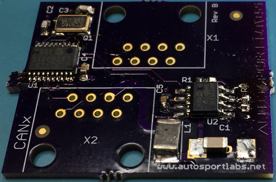

Is C1 the correct form factor? Looks a bit small for the pads.... Can I solder the one end to the circle? Or does the circle not connect to the pad just to the right? Build list calls for "SMC_D" package. Somehow I bought "SMD/SMT."
Does it matter if it's polarized or not?
I finally got around to working on this.... This is some tough soldering! It's extremely difficult with a very fine tip soldering iron and magnifying glass. I thought I had pretty steady hands and good eyes for fine work, but this is near my limit.....
Halfway complete CANx
IMG-1405 (copy).jpg (147.76 KiB) Viewed 43441 times
Good job so far!
You need a SMC D sized package for the capacitor, and it is polarized. It's a tantalum capacitor, and the polarity matches the band orientation on the PCB. Capacitance isn't critical; 15uF to 33uF should be fine.

Components aren't mounted as straight as I'd like, but they should be functional..... I learned a lot from soldering the first board. That's why I ordered three PCB, because ordering 3 from OSHpark didn't really cost any more and gives me a few for practice. :wink:
brentp wrote:
GTIspirit wrote:
* CPOL-USSMCD doesn't lead directly to a "polarized capacitor." Searching for a 10uF "polarized capacitor" yields results for bi-polar/non-polar and general purpose. Which is correct?
you can use a 10uF 1206 ceramic capacitor, 16v. Polarized capacitor not required.
This is what I ordered for 1206 10uF "C1" 1206YD106KAT2A
1206 is too small, will 1812 size work?
Mouser doesn't list a "SMC D" package, what is the equivalent case code?
The pads look smaller than x 0.12" so maybe "case code" 1808 is the right size? Except no product is available with capacitance 10uF - 33uF with that case code. :(
Looking at capacitance range 10uF - 33uF the nearest "case code" is 1812, which is slightly bigger than the pads in the one direction. (If L1 is 1812, 1812 looks a bit big for C1.)
Does polarized matter, or not?
Is there is a recommended C1 capacitor at Mouser.com?
These are the correct capacitors:
https://www.ebay.com/sch/i.html?_osacat ... d&_sacat=0
https://www.mouser.com/Search/Refine.as ... d+case+smd
Narrow your search for a 10-33uF variant, it's not a critical value.
Good luck!
