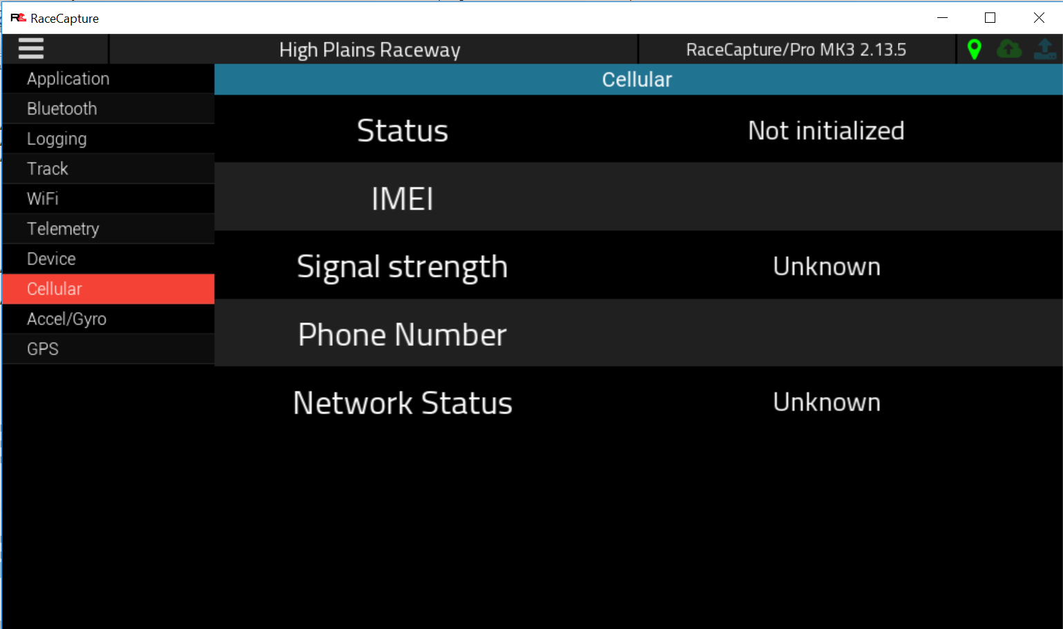

I've had two good sessions with my RCP3, both test days in a spec miata, and in both cases telemetry seemed to work fine with a freedompop SIM. I've moved it over to my autocross car, and noticed that now the RCP3 doesn't seem to even see the SIM (see attachment). It shows as "not initialized" - and the screen doesn't seem to change whether or not the SIM is installed.
- no-sim-registered.PNG (100.89 KiB) Viewed 24139 times

You might want to double check the SIM card is inserted properly, and that cellular telemetry is turned on under wireless. Also check that your freedom pop SIM is active - they tend to go dormant after a period of non use.
Barring that, you can go through the troubleshooting steps here:
https://wiki.autosportlabs.com/RaceCapt ... r_activity
Turned out to be simpler - without background streaming enabled (I disabled this to avoid ad-hoc events appearing every time the RCP3 powered up), it doesn't seem to try to talk to the cell network (no [cell] messages in log, etc). Enable background streaming, or... well, just wait until I'm actually logging via trigger, and it works just fine.
