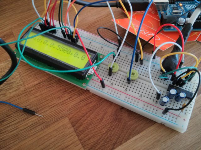

Meanwhile, my MAX232E (not A) ICs arrived yesterday. I'd have hooked them up straight away, but I didn't have the 1uF caps. I've got 8 million .1uF caps, and a 10uF cap, but no 1uF. RS didn't have any (or more precisely, they have them for $2 each, and I need 4 of them...). I had just got back from nerding around the electronics stores in the South Bay, too. If I'd only known I could have grabbed a cople. I will see if tech shop has any in the bin-o-scrap parts they keep near the electronics workbench.

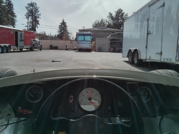

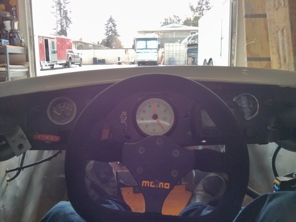

My car was mostly assembled, so I snapped a couple photos from my seating position. It's all back-lit. But you get the idea. This is more-or-less what I see when I'm driving. There's a little room on each corner of the dash, and some room directly behind the wheel which is currently dominated by the tach.

The vantage point helps. Are you planning to replace the tach with the dashboard?

brentp wrote:The vantage point helps. Are you planning to replace the tach with the dashboard?
Not until I trust it. I could see getting a smaller tach to make room for another instrument. But what I want from my dash is something that sits just above the wheel, so I don't have to keep looking down.
that is a tiny space. What we'll create will be larger, like the typical digital dash you see out there. Perhaps if you have a chance to collaborate with ours you can 'burn it in' mounted off to the side until you have full confidence.

I had to try just about every possible wrong way to wire the thing, but damn it the summabitch works! Really, what is UP with these data sheets!? So confusing. I would have thought that R stood for RS232, and D stood for DATA, but it's not like that at all. RIN is RS232IN, and ROUT is TTL out. DIN is TTL in, and DOUT is RS232 out. Go figure. Plus I had the caps hooked up wrong, and I swapped tx and rx accidentally a bunch of times. This stuff is painfully hard when you're dyslexic.
Now I can resume my obsession with the design work and the software side of things. All I can say is thank god.
You're looking at a random fragment of the data stream. In reality it goes by too fast to see, so I pulled the plug for to stage the photo.

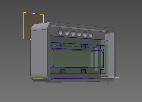

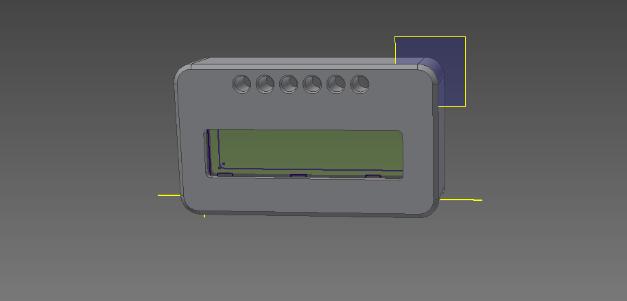

I have a first cut of the housing design (see below). It's pretty straight-forward -- not trying to win any design awards, or anything -- but it's literally designed around the LCD so that it will fit easily. The CAD files are paramaterized such that I can change a few key values, like the LED diameter, wall thickness, led recess depth -- even the LCD unit itself -- and the model instantly updates. It's a lot like programming: I like it.
I still need to design the rear cover and its attachment points (the housing will probably get a bit wider to make room for that). I've figured out where the unit will attach to the body, but I need to design mounts, and they probably need to be composed of some kind of elastic material to help damp vibrations. I need to include a cut-out for the serial cable.I've got ideas on how to do all this, but it'll take a few days to get them into CAD.

Front of housing
Front of housing
Housing rear
Housing rear
