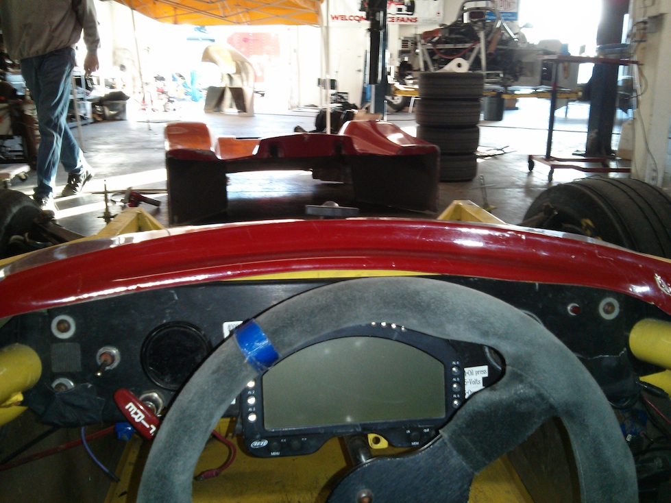

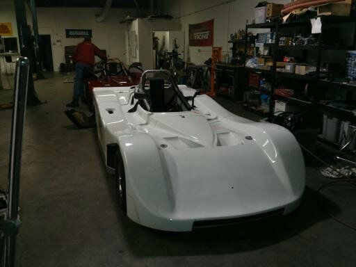

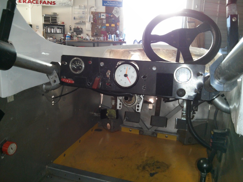

First, you need to understand the context. I plan to install this in a Spec Racer Ford. For those who don't know, I'm attaching some pictures of an SRF and its cockpit.
The key thing to note is that while it has a dashboard, it's quite a small one. It's also largely obscured by the wheel. There's room for one gauge directly behind the wheel, and there's room for two more on either side. None of these mounting locations are any good. They all require completely taking my eyes off the road to read any gauge.
My goal is to build a small unit that can be mounted just above the wheel and directly in my field of vision.

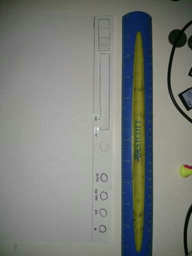

I'm attaching some concept drawings.

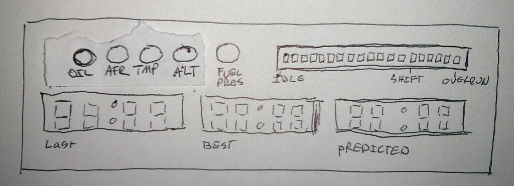

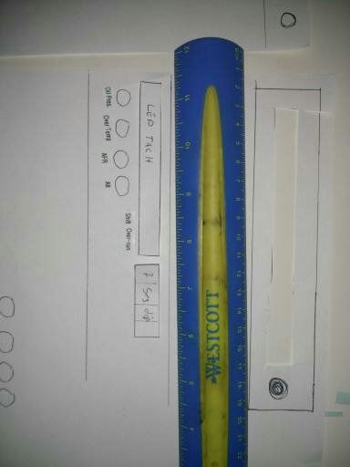

Ok, I broke out the whiteboard markers. Here's what I would imagine for a relatively simple dash. As you know, there are so many examples out there to draw from.
Captures essentially what you did, just a little bit more symmetry, and makes the current lap time and +/- delta time larger and more prominent. Arc of shift light LEDs at top; warning lights at the bottom. Switches at the side.
Just some very loose ideas

What are the dots on the left?brentp wrote:Ok, I broke out the whiteboard markers. Here's what I would imagine for a relatively simple dash. As you know, there are so many examples out there to draw from.

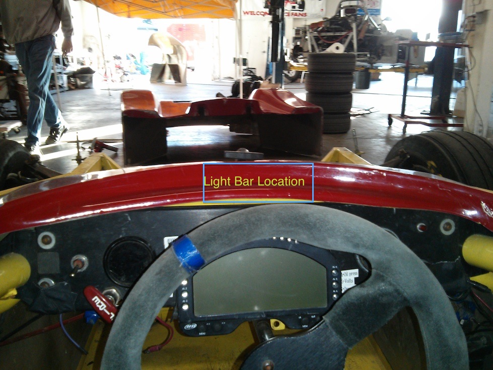

I had a discussion with Dave, who maintains my car. He warned me about mounting gauges too high up in the slip stream. So, I've been re-thinking my design approach a bit. I decided to separate it into several components: The RCP itself, an interface module for connecting RCP to low impedance sensors, and the display unit(s).

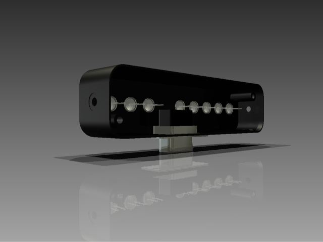

I got a tech shop membership, and spent the weekend playing with Inventor. So, I've attached some renderings and cad files of a slim 4x1" light bar. This bar doesn't include any numeric displays, so it's pretty slim and can be mounted above the steering wheel and still stay out of the slip stream.
Definitely a work in progress. More of a learning exercise than a usable design. I'm just learning how to work with Inventor, so my abilities are somewhat limited at this point. I'm not crazy about the 9-pin D-sub connector. Maybe I'll have a cable emerge from the part, and put the connector somewhere down-stream. The connector only needs to be there if I end up mounting the part to the body, so that the bodywork can still be easily removed. If I mount to the dashboard plate, the light bar can stay in place.
The 5mm LEDs I have are water clear, and so the viewing angle is rubbish. They're nice and bright, but you have to look at them dead on. I am considering adding a diffuser. Based on my experiments with some 80% and 20% diffused, white polycarbonate, the diffuser would have to be pretty thin. I might also try scuffing the surface of an LED with sandpaper. On the other hand, I think it should be possible to get the viewing angle pretty much dead on.
