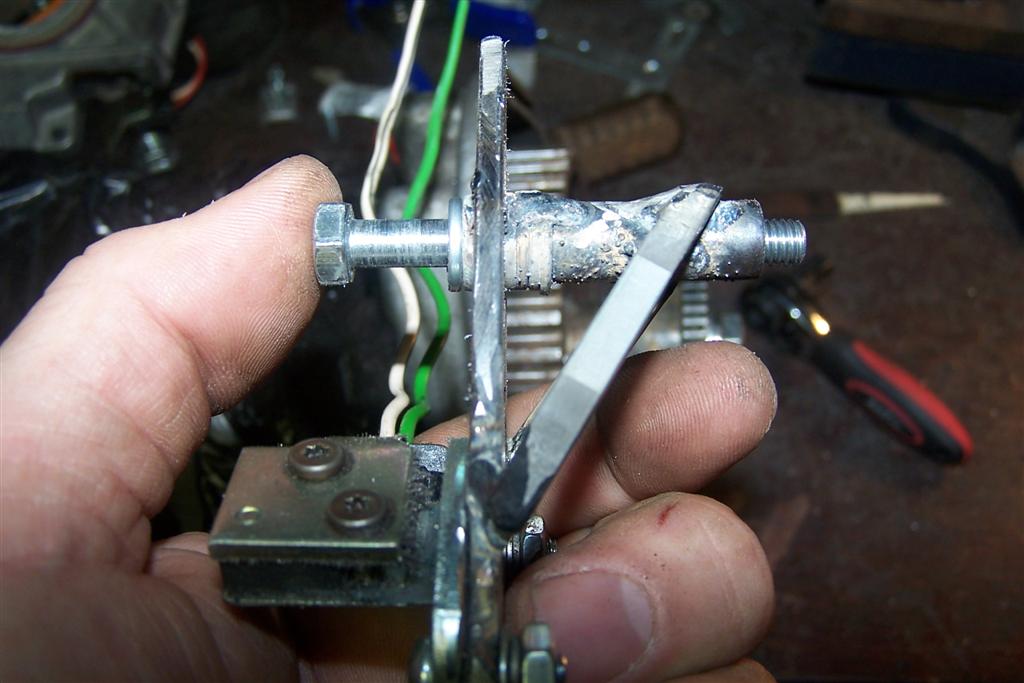

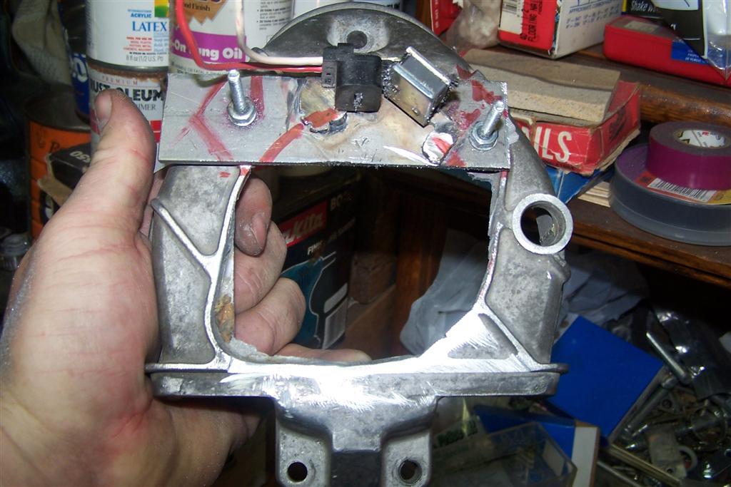

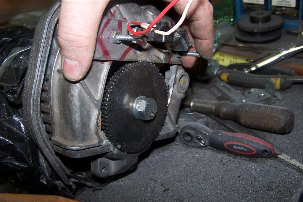

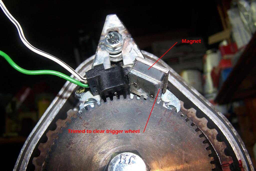

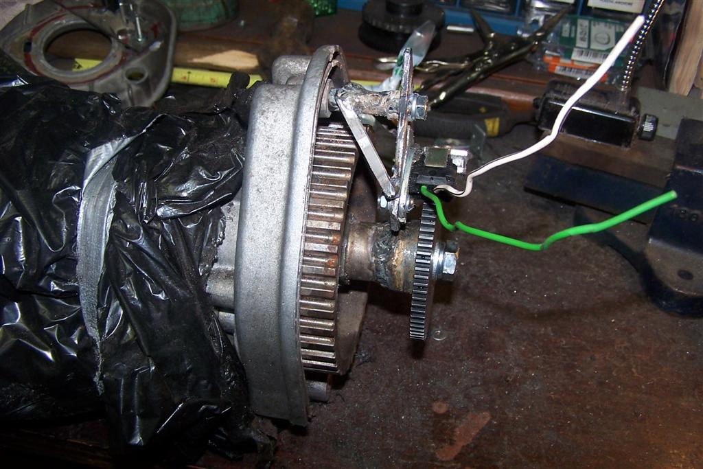

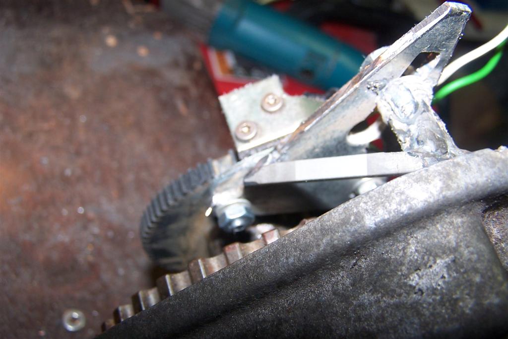

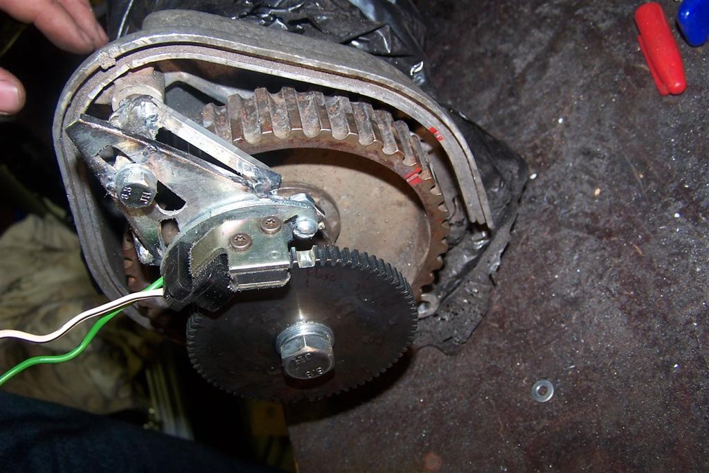

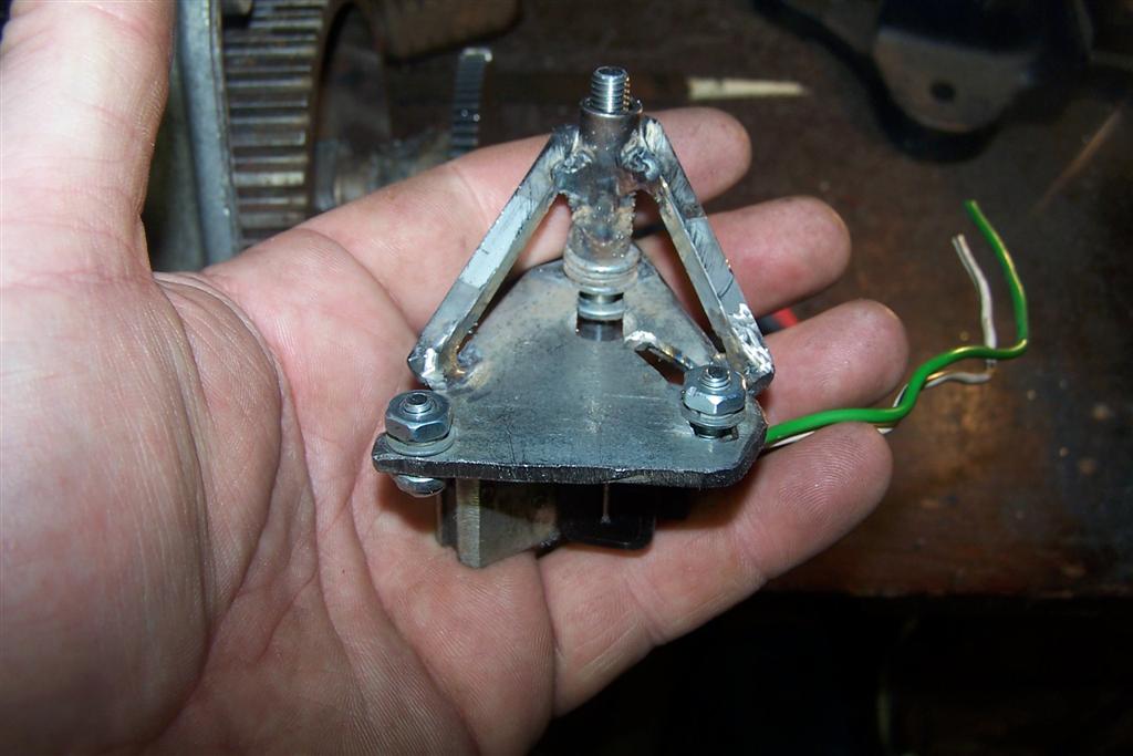

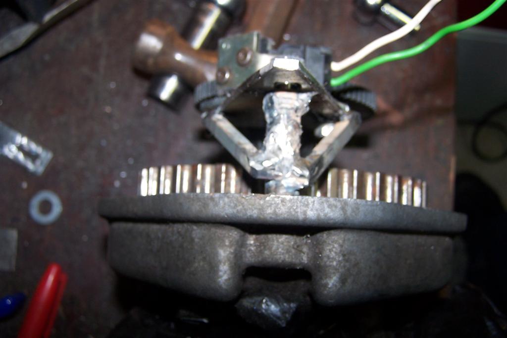

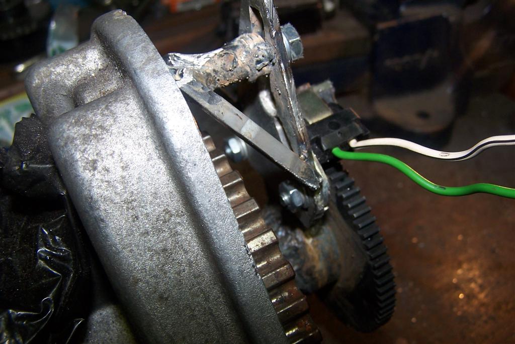

Now some photos f the reinforcement I put on my second iteration of the sensor mount. If this works I will remove it and spend some quality time with it and my dremmal cleaning it up and then a good sandblasting and paint.
- 2008-11-29 EDIS 007.jpg (117.36 KiB) Viewed 191546 times
- 2008-11-29 EDIS 006.jpg (114.97 KiB) Viewed 191547 times
- 2008-11-29 EDIS 002.jpg (62.2 KiB) Viewed 191547 times

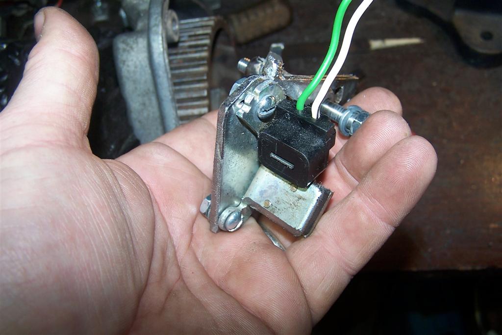

More
Note that I trimmed the mounting bracket that holds the magnet so it has more clearance from the wheel. This makes things much easier. It may only be 3-4 mill but in this case it matters
It also lets you see the curved slot I cut to allow it to be adjusted. It makes setting it up easier.
- 2008-11-29 EDIS 011.jpg (74.63 KiB) Viewed 191541 times
- 2008-11-29 EDIS 012.jpg (83.02 KiB) Viewed 191541 times
- 2008-11-29 EDIS 014.jpg (76.4 KiB) Viewed 191541 times

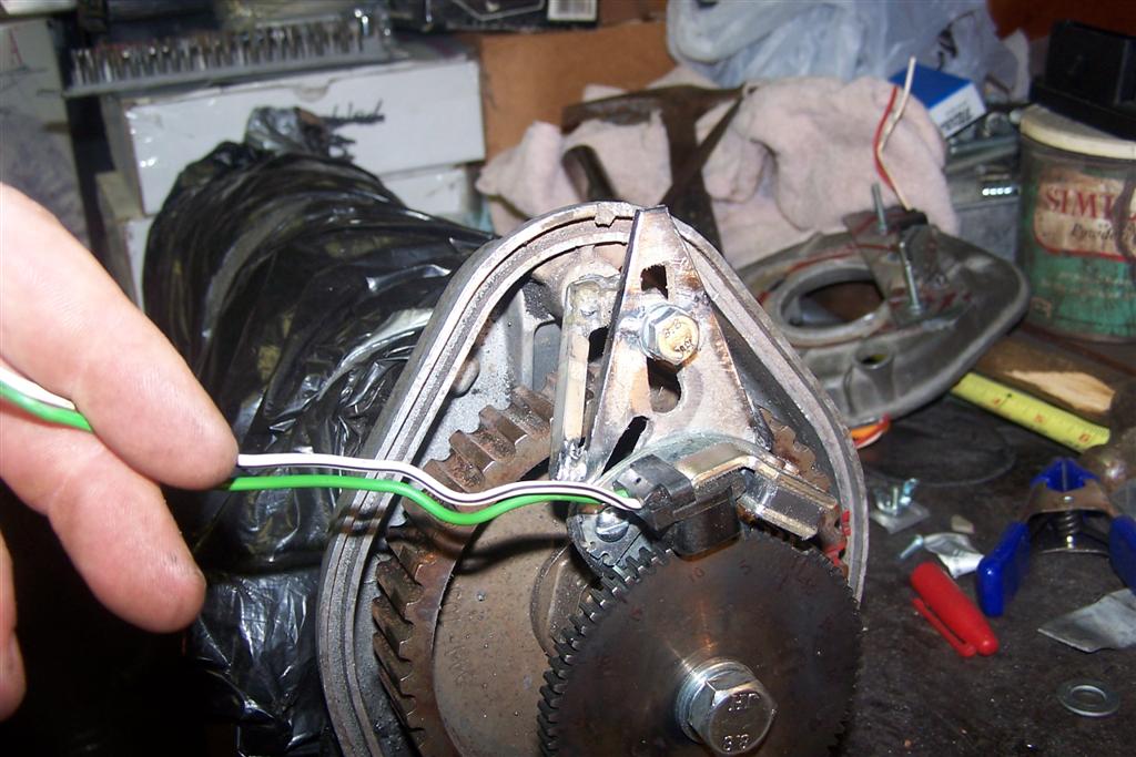

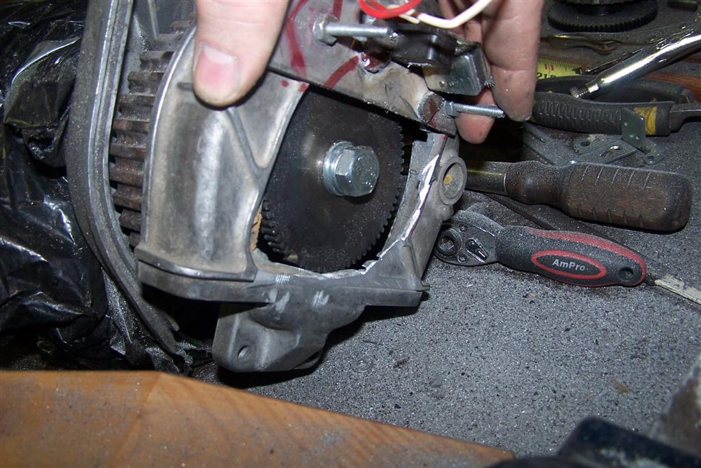

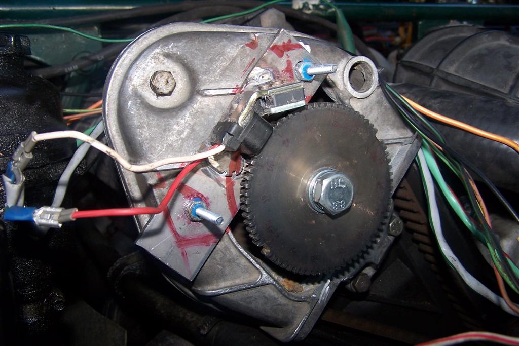

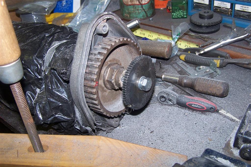

Now the other set up.
I hacked the you know what out of it. Again of this works I clean it up (trim off the excess metal of the bracket) and neaten up the hole by bringing it out to the perimeter ridge. I will then sand blast it and paint it . . . Wait if I do this than I will have to clean up the rest of my motor.
- 2008-11-29 EDIS 021.jpg (104.43 KiB) Viewed 191539 times

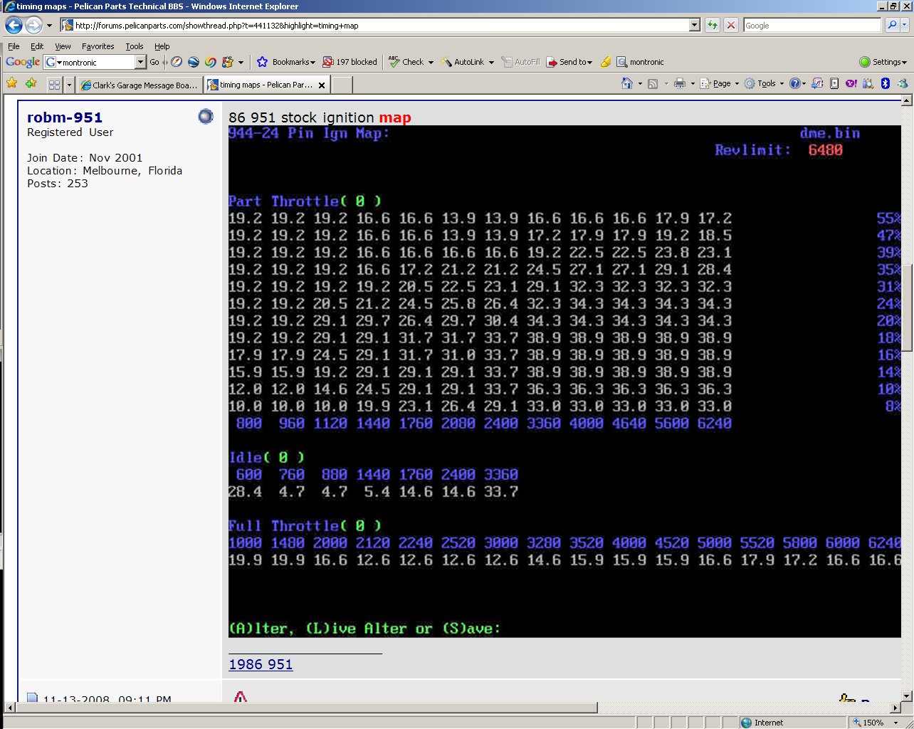

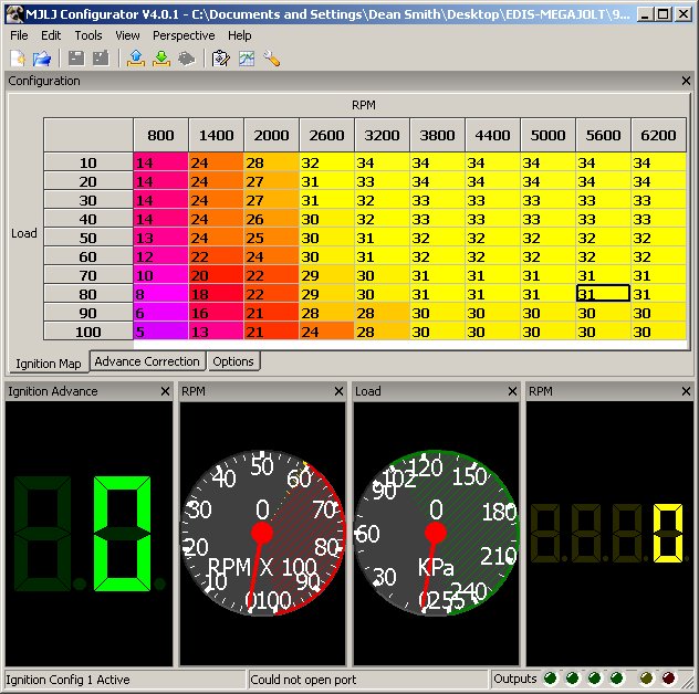

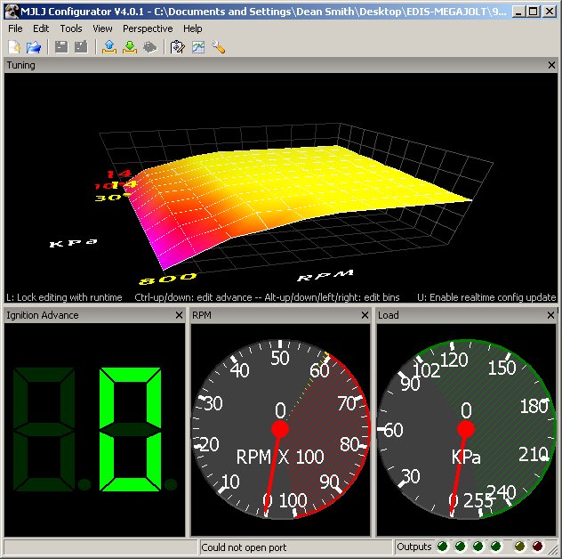

I have been looking for a good base map fr my 924s For those that do not know it is really a 944 so that is where I have been looking. I have not been able to find a NA map but I have found several from turbo cars. I even found one form what was said to be from wilkes. What I did was to take the non boost portion of the map and extrapolate it over the MJ map. I then brought the over all timing down by about 5 deg across the board. I did this for several reasons.
1. From what I can find the stock timing at idle (800 rpm) is 4.7 deg. I rounded this to 5
2. I am sure that the wilks map was designed for premium gas
3. The 951 (944 turbo) has lower compression pistons giving them lower static compression allows for more timing
What shocked me was that after making the map it looks to be very similar to the baseline map supplied with the unit. How was the baseline map developed?
Has anyone done a sort of statistical analysis of maps versus motor size, static compression?
Anyway here is my map and where I got the info for it.
I hope top be testing it later today.

If anyone wants to fool with it I have attached it. I am having second thoughts on the WOT at low rpm (upper left corner of map). I think that I should probably take a little timing out of this area/corner. This tends to correlate with both the base line here and other maps I have seen for the 951.

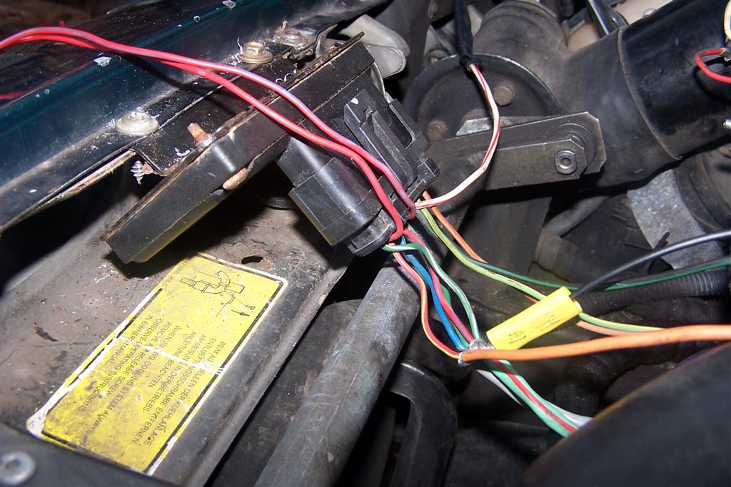

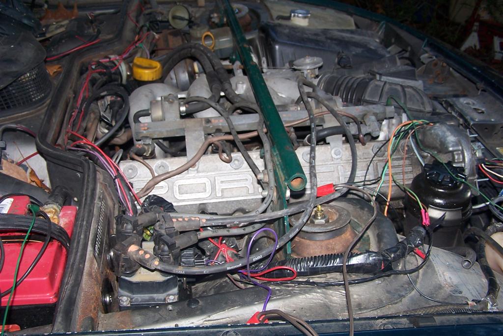

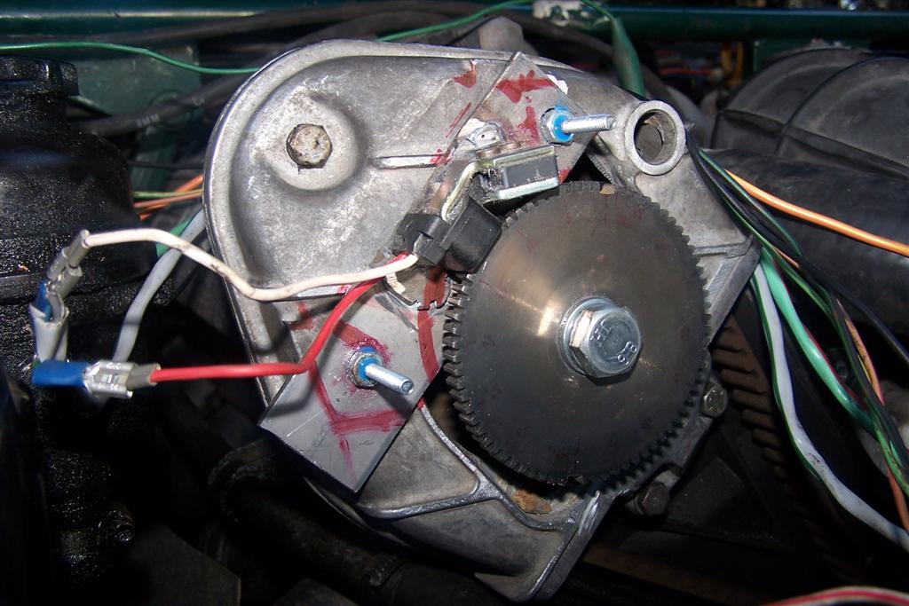

IT IS ALIVE!!!!!
It still needs a lot of work but IT RUNS!!!!!!
It Did not start the first try. I swapped the sensor wires and it purred like a kitten.
I have to clean up the wires and finalise the wiring and install the MJ unit.
Here is a YouTube video of it running and me commenting.
http://www.youtube.com/watch?v=ufkbAqUPiAQ

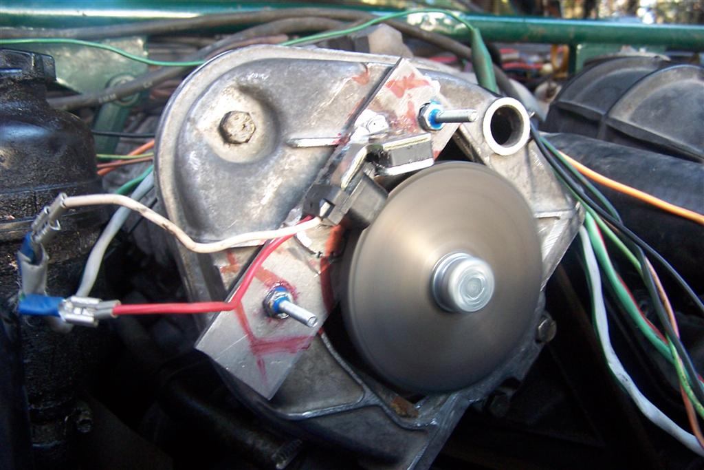

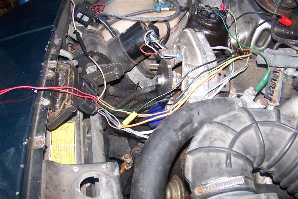

Pix
The first two were taken with the flash so you can not ell it is running the third as you can see it is running

hi dean, good to see another one running!, and your updates have been most entertaining.
i would, however, like to urge in the strongest way, that you make a cover for the trigger wheel.
having a gear wheel spinning around like that at the top of the motor is a serious injury risk,
both from touching it, or getting stray wires caught in it eg timing light test leads, for example.
as you have those two mounting bolts sticking out a bit, it would be dead simple to make a
cover to slip over them, with a couple of spacers to hold it close to, but just away from the wheel.
someone's fingers, likely your own, will thank you for it someday by remaining attached to their hand.
regards
alexander.
regards
alexander.
