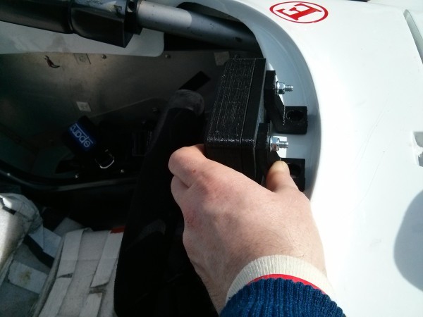

Pictures
Pics.
- That's funny, this doesn't look so bad after all.
- IMG_20140308_114631.jpg (54.32 KiB) Viewed 24522 times
- IMG_20140308_100749.jpg (45.02 KiB) Viewed 24522 times

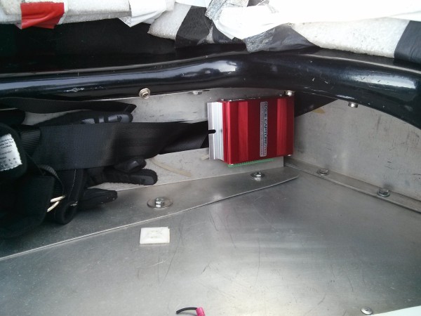

- Possible mounting location for RCP. Not crazy about this.
- IMG_20140308_100943.jpg (55.64 KiB) Viewed 24522 times

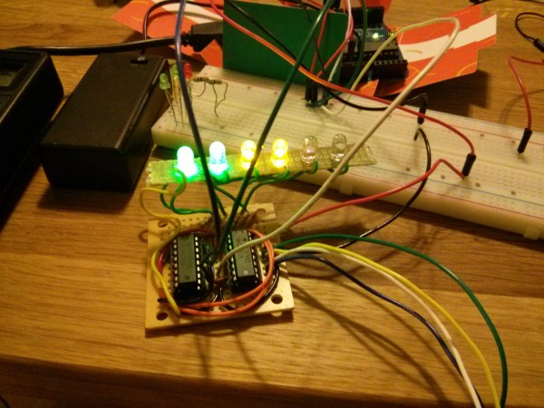

Progress on Circuitry
Working on the circuit board. Using the small radioshack perfboard, which fit neatly into the back cover and RCP housing and have convenient mounting holes.
One thing I've learned is that while solid core wire is best for traces, inter-board wiring should be stranded. Solid core wire is relatively stiff, and when you have a bunch of them, you create a mechanical spring that is *really* stiff, and difficult to fold out of the way. So I get to buy some stranded wire in multiple colors as well
Yea!
There's two 16-pin dip chips on the board. One is for the MAX232E serial interface. The other is a shift register I added in order to avoid pairing the LEDs. I was worried about excessive per-pin current draw. I also like the idea of the LEDs being separate. And I've just always wanted to build something with a shift register.
I'm still using the arduino uno for testing, hence the long leads. I'm planning to run with the Nano rather than the teensy eventually, because it's (1) 5V and (2) has mounting holes. The teensy will be a better fit for the other screen, since that uses 3.3v logic.
That's all for now.

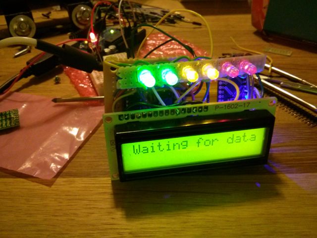

- Lights on, but mounted in housing.
- IMG_20140311_233115.jpg (71 KiB) Viewed 24520 times
- Testing the circuit board.
- IMG_20140311_225105.jpg (77.6 KiB) Viewed 24520 times

On the other hand, I got the shift lights and the serial link finished. I added a handy switch to disconnect the TX and RX pins, so I can still reprogram over USB.

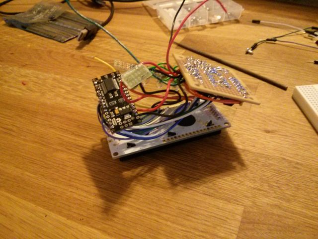

IT'S ALIVE!!! (again)
I got my new (character) LCDs on Monday. I've been hacking up a storm.
Computer PCB CAD tools often have a layer called the "rat's nest" which shows component connections running all over everywhere. This hardware literally IS a rat's nest despite my best efforts at keeping it all sorted.
I wanted to be able to build the board up incrementally, and having little room inside the enclosure to work with, I chose a small board. And ran out of room on the board. I had to improvise some last-minute additions. Also, the wiring connecting the Nano, LCD, and logic board turned out to be bulkier than I expected. It juuuussst barely fits in the enclosure. It's gonna work, at least until vibration breaks one of my sketchy solder joints.
I'll test with this for now. In the mean time, I'm in the process of converting this design into something I can have made into a PCB (more on that in another post).
[/b]
[/b]

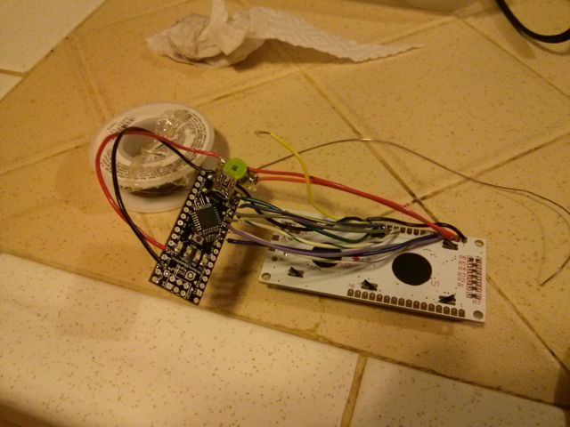

- First, connect the Nano to the LCD. I had to guess at the lead length. Measuring is for sissys.
- dashboard-pics2.jpg (49.33 KiB) Viewed 24445 times

IT'S ALIVE!!! (again) (contd.)
Moar pics!
These images don't capture all the mistakes, frustrations, burns from accidentally touching the soldering iron while trying to grab approximately 20 things with one hand. The times that I broke off wires and had to re-solder them.
Anyways, the wiring of Rev 1 is nearly done. Just a few connectors and what not, and it's a working device. The rest is just software -- but that's easy, right?

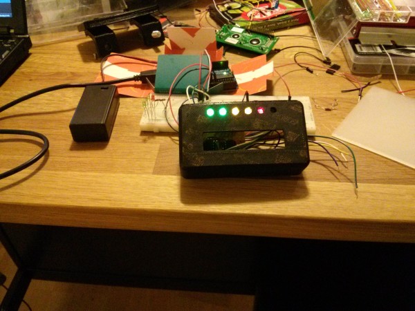

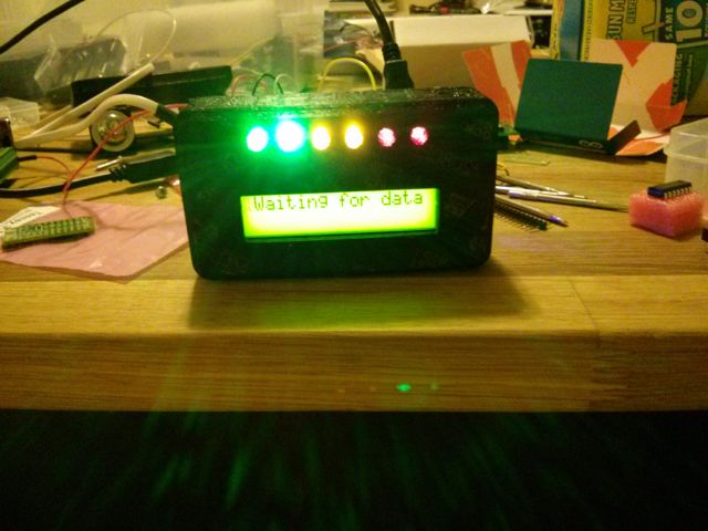

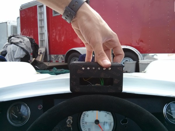

- OMG! OMG! OMG!
- dashboard-pics5.jpg (48.17 KiB) Viewed 24444 times
- Everything is connected. Finally. That's odd, it all seems to be working.
- dashboard-pics4.jpg (55.27 KiB) Viewed 24444 times
http://youtu.be/Y6mnFdxkJAo <-- Proving that I really can read the RCP serial stream (kinda).
http://youtu.be/5P9W1R12sD4 <-- Full demo, using a computer.
http://youtu.be/urQfgNi39Gk <-- Same thing, but electronics are mounted in the housing![/i]
