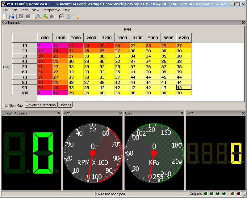

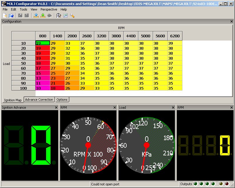

Here are screen clips of the two maps the first map is the one I am currently running and the second one is the map from a stock 1987 944
- 944 1987 Stock Ignition Map2D.jpg (112.04 KiB) Viewed 160308 times
- 924s03-10DEG-BASE-1High.mjlj.jpg (112.01 KiB) Viewed 160310 times

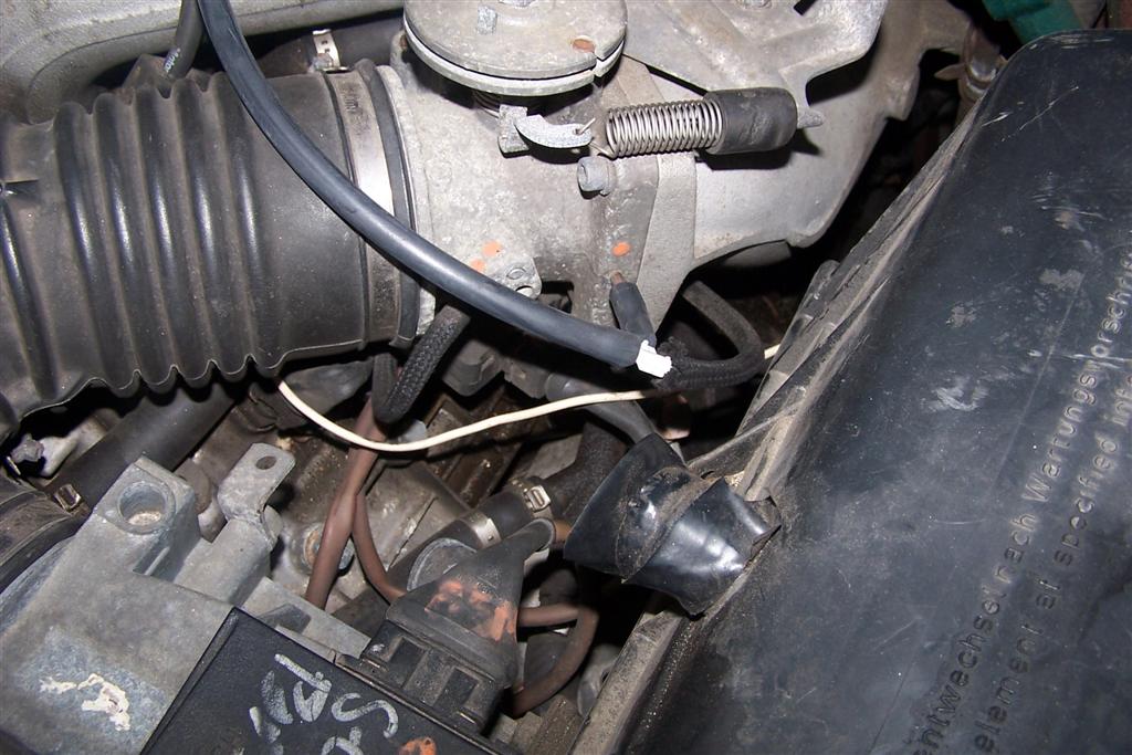

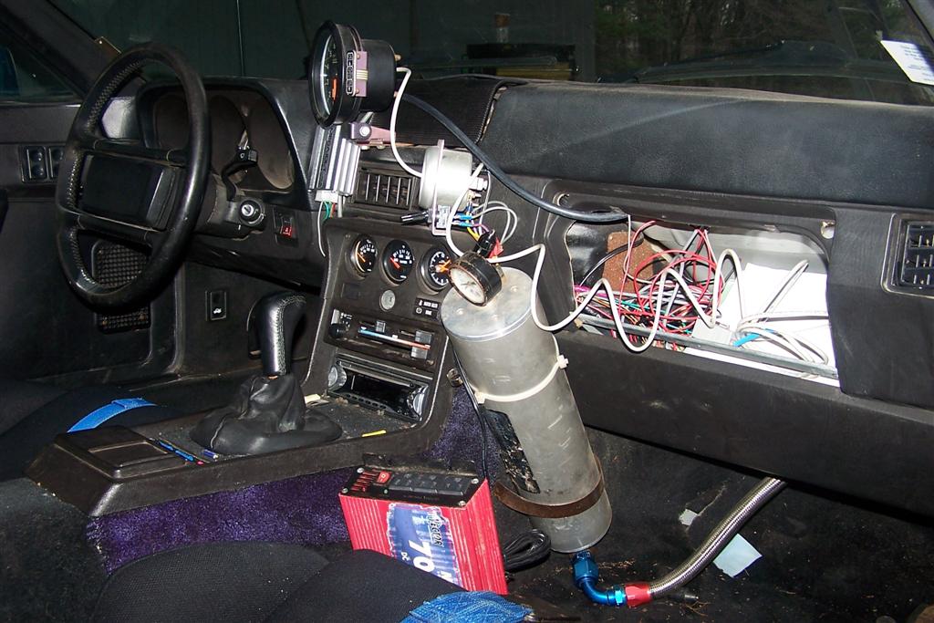

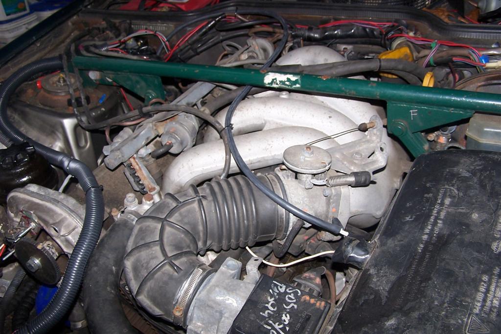

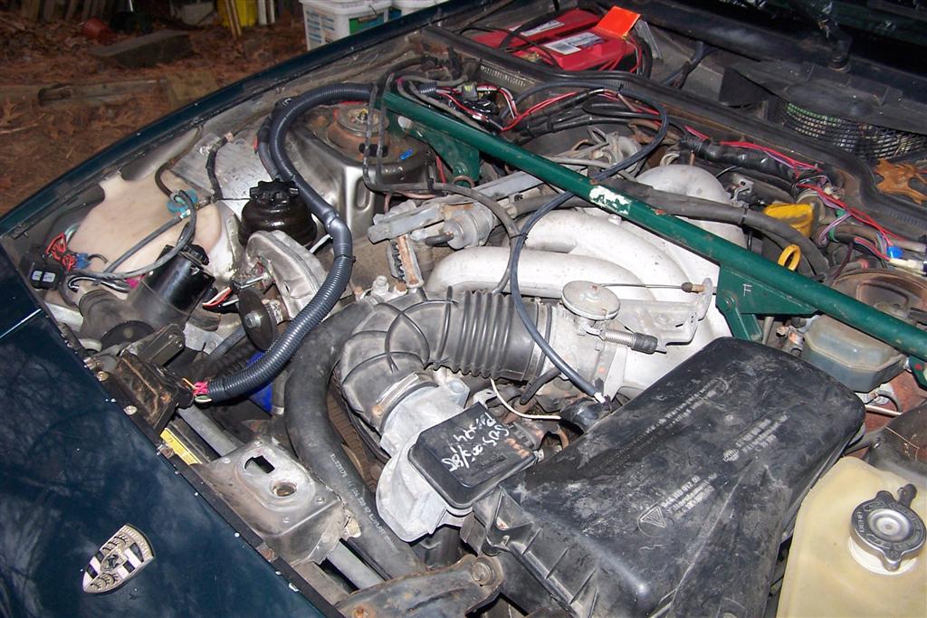

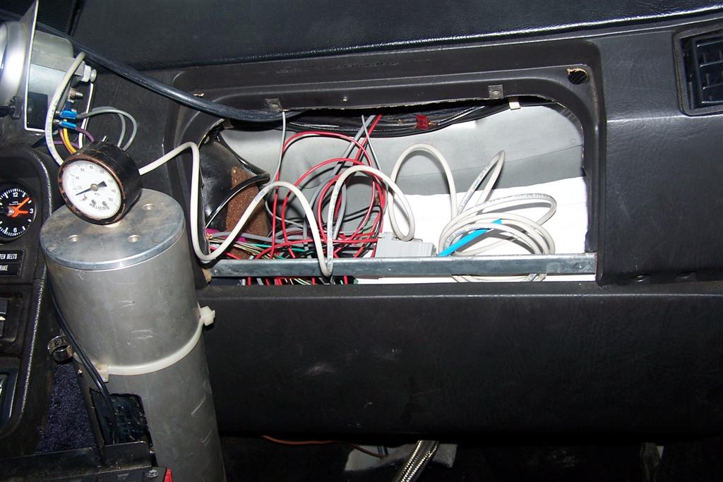

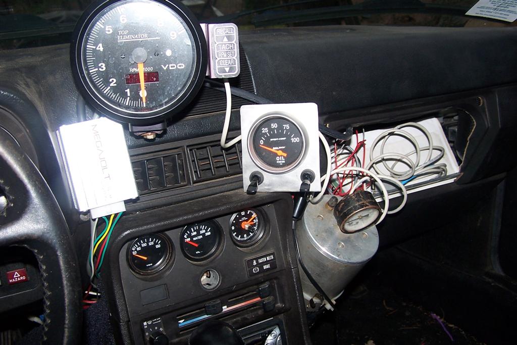

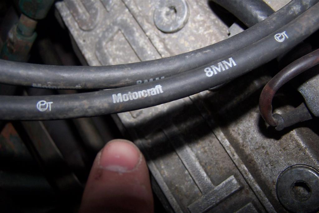

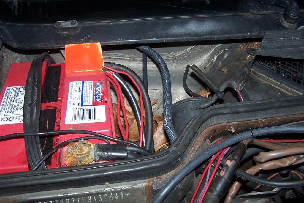

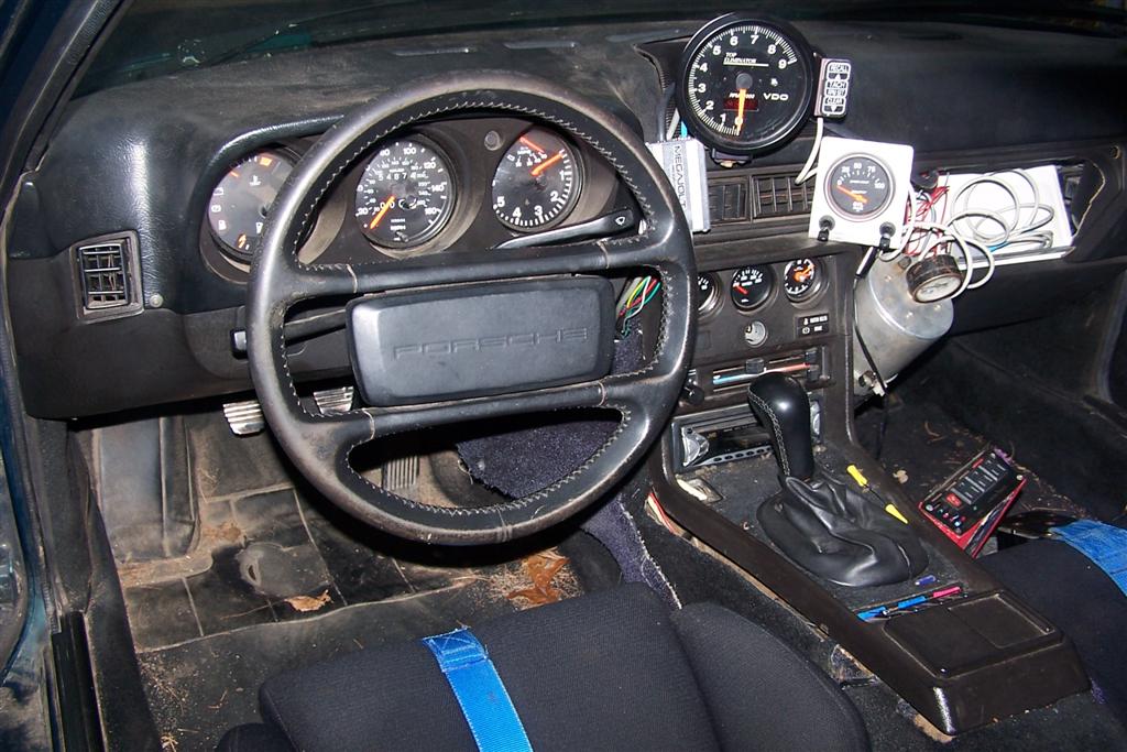

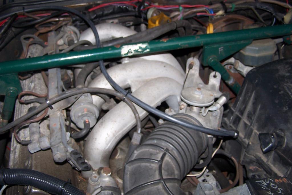

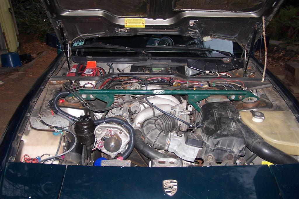

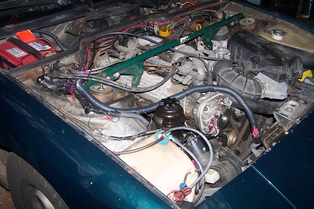

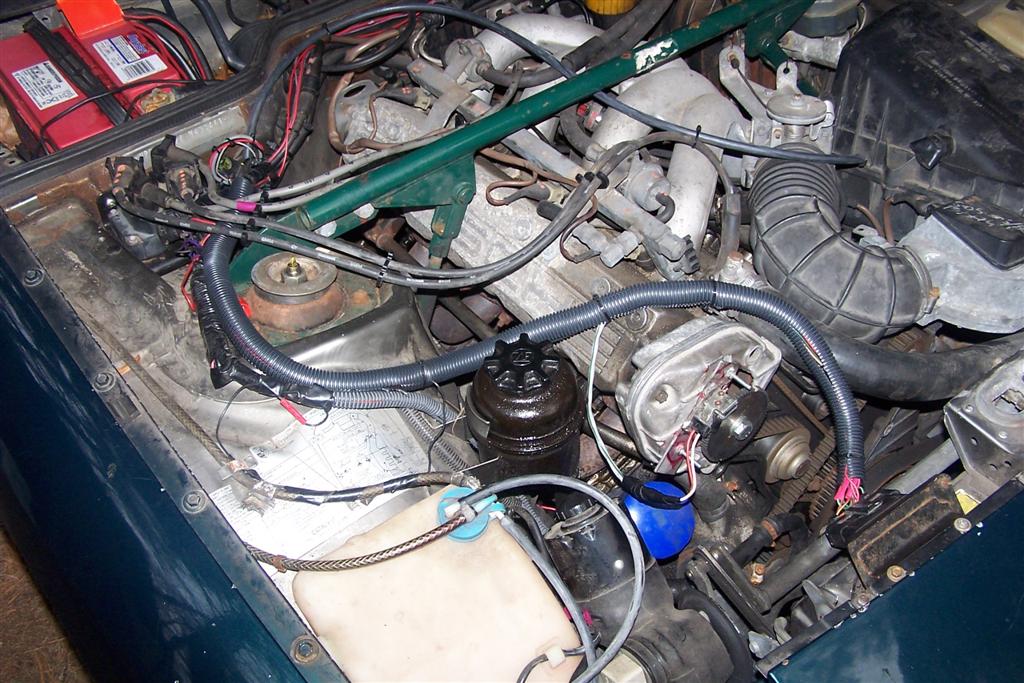

Ok some more photos of the insall cleaned up a bit. I have still not finalised the install in the cab as you can see.
I am going to take some vidio while doing a 3rd gear pull. It is incredable. Watching the tach just take off. I pulled to 6500 on the latist map. It is much better than any of the otehrs I ahve come up with to date. VERY drivable and yet goes like crazy after 4K
Anyway more pix.
Anyway more pix.
