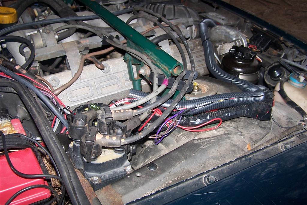

Ohya a site note here. A set of wires for a 1994 Mustanng with a 3.8 V6 would apear to be the set I need. Yes I will wast wo wires but the Escort wires are just to short for my application. If ther eis no cost / minimal cost difference for a V8 set I may considder it as I can then get two sets for the price of one

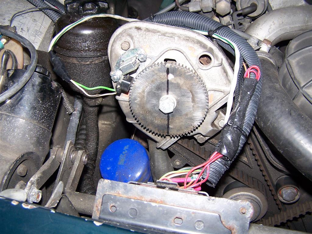

To start out with I am basing this build on my car. It is a 1987 Porsche 924s (same as a 944 just different sheet metal) My motor is from a 1983 944. It is an 8V SOHC 2.5L water cooled 4 cylinder motor. There are some small differences between the pre and post 85.5 motors/cars. As I get to them in this writeup I will try note them.

*Modification: Removal of two teeth 180 deg out from each other so you end up with a 72-2 trigger wheel

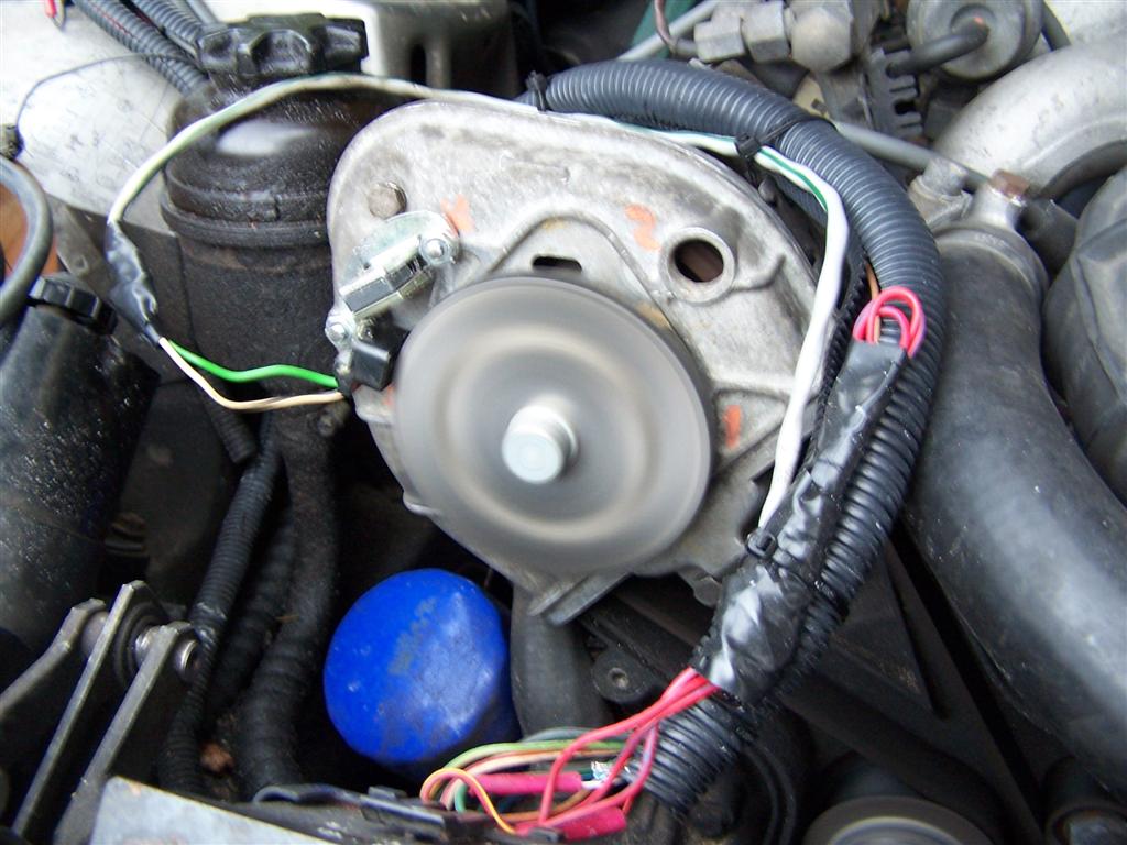

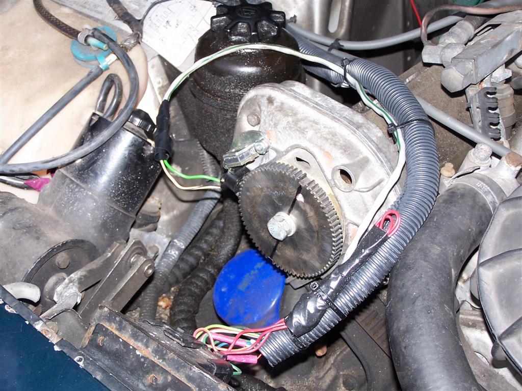

Made some changes to the installation.
They are:
New trigger wheel that is both wider (was 1/4" now it is 3/8") and larger diameter I fabricated it from a Martin Spur Gear #S2072. This resulting change also made the teeth bigger.
New sensor mounting directly to the cam cover. I also modified the sensor by reversing how the magnet is mounted. This resulted in the magnet being moved away from the trigger wheel allowing for the larger trigger wheel diameter to be used.
I also glued the inductive pickup to the steel center preventing it from vibrating and moving as the other could. With the new configuration of the of the sensor the inductive pickup could actually slide down and hit the trigger wheel.
I also found loose crimp connections where the VR sensor connected to the harness. I am sure was not helping things. The end result is a much better running car. Pulls much better than before. This is how Porsche should have tuned from the factory!!
Video of it running >>>> http://www.youtube.com/watch?v=-sDNVjqg4cM
Pix of the new installation
They are:

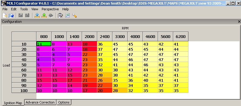

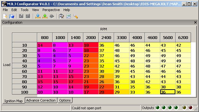

And the new map that goes with the new and improved set up.
I can not tell you all just how well this is now running. My car never ran this well. Even with the the stock ignition and a fresh tuneup new wires and a cap and rotor it was never this good. It is amazing the difference. I can only imagine what it would be like running with crank fired instead of the cam fired as I am. I am sure that I am loosing a little resolution due to belt stretch and what not but it is such a vast improvement over the old cap and rotor.
This really proves that wiring and connections are key to making this work. I am not sure that the whole issue with the loose connection on the VR sensor wires I found was probably the whole problem. But now that I have the larger trigger wheel I am sure that I am getting a much cleaner signal to the MJLJ
You will note that the map has changed quite a bit. I worked on it timing 30-70 runs on my favorite section of highway. I also re worked the bottom end of the RPM scale to smooth out the jerkiness of the off idle feel that you have. I also found that the Idle will surge if the Timing is to high. It hunts between 100 ad 1500 rpm. By lowering the timing in this area back to close to the stock settings the car changes completely. Around town end in traffic it is a mild mannered normal car. but once off idle it makes this transformation from an old tired 944 to the feel of a modern car. The car now pulls smooth of the line and accelerates smoothly like a rocket gathering speed. Once over 1500 rpm it just goes. I have put the redline at 5250 as things just get silly fast over 5000.
Anyway this seems to be a really good tune. Until I can get to the Dyno for some tuning this will probably be the map for now. I think I am going to put the knock sensor in and do some testing and see where it actually starts to knock. I should probably do this with a tank or two of 87 octane as well.

My original gear (1/4" wide) I got through McMaster Carr on line:
http://www.mcmaster.com/
Part Number: 6325K67
Steel Plain Bore 14-1/2 Deg Spur Gear 24 Pitch
72 Teeth
3" Pitch Diameter
1/2" Bore
Catalog page 1039
I still think that this may have been ok since when I changed over to the 3/8" wide one I found a loose connection in the VR sensor wiring. However I am now using a 3/8" wide wheel that is a bit larger in diameter and I had to remove the hub from it to bring it closer to the face of the cam gear cover so the sensor would line up properly and allow for a good solid mounting of the sensor directly to the cover.
Anyway to get the new gears I went to the martin website (google is your friend) and looked at there catalog and found what I wanted. I then called them directly and they steared me to there local branch (listed below) Craig smith was very helpful!! However you can not purchased directly form them you will have to go through a retailer. Craig was very helpful in finding a local company that I could purchase from. I called them and placed the order and they shipped it to my door. I would bet that there is one local to you as there was with me.
Here is the info I have for my local sources.
Craig Smith
Martin Sprocket and Gear
357 Fortune Blvd.
Milford, Ma 01757
Phone: 1-508-634-3990
Fax: 1-508-634-3998
e-mail: <mailto:[email protected]>:
Web: www.martinsprocket.com
The local retailer is:
MOTION INDUSTRIES INC
11 CABOT ROAD
WOBURN, MA 01801
Phone: 7813765850
Fax: 7813765908
The details for the second gear that I ordered that was 3/8" thick/wide was are as follows
1.0 MARTIN S2072 14 3/8 SPUR GEAR
1-2 DAYS/UPS
Item No..........: 00372887
Respectfully
Dean
Dean
I just thought I would update this and say that I drive my 924s just about every day. It sees 200-500 miles a week and the MJLJ-V4 has been flawless. Not a hiccup no issues. Once you get it up and running and get the tune proper it is basically like a hammer. The no start condition I was experiencing with the stock system has not occurred since I installed he MJLJ.
This is one of the primary reasons I have not been posting much is there has been nothing to post about. I put key in turn car on and drive. No issues!!!!
For anyone that is worried about reliability of these units don't be. What I can say is that you have to make a bullet proof installation. Make all connections very tight and double check everything. Wires hanging loose will result in loose connections or something that was in shorts. Cover everything in plastic shielding. Secure things with lock washers and or locktight. Since I have a background in Sports car racing and years ago I dabbled in NASCAR I tend to try to build to standard that I think will survive the track. Over engineering is a good thing! A side benefit to this is that you will usually end up with a neater installation.
When all else fails think like the Rotisserie oven infomercial. You want to "set it and forget it"
