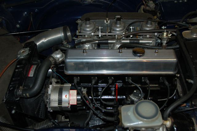

So now I am up to do some tuning to get the best out of it (Loaded the 3.1 version Firmware and Configurator). Will post some picture' s of my installation later.

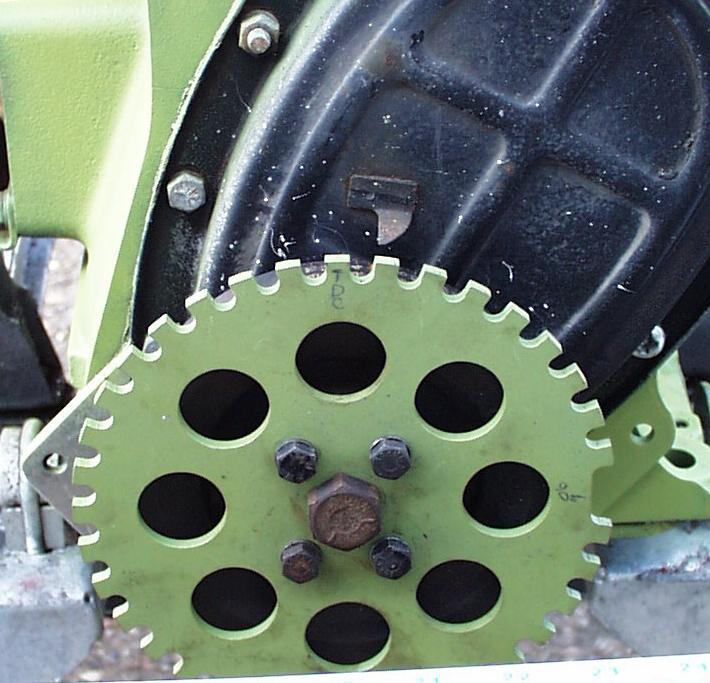

Not much room to add a toothed wheel, have the original crankwheel machineshopped with the 36-1 teeth...

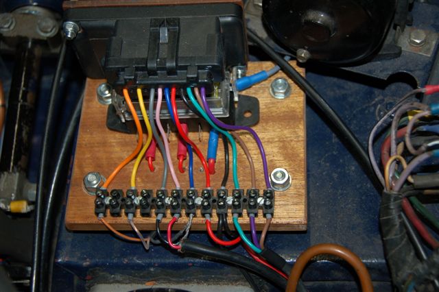

Notice the brown/purple wire switched it over to get another firing sequence from the coil, normally A,C,B with the wires switched it is A,B, C allowing to put the plugleads without crossing (depending of your firingorder of course)

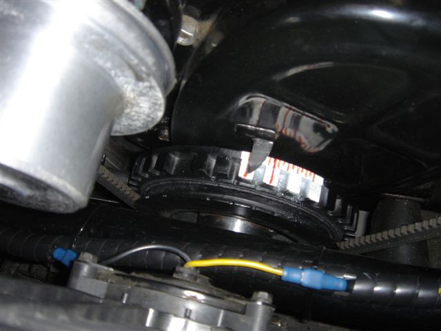

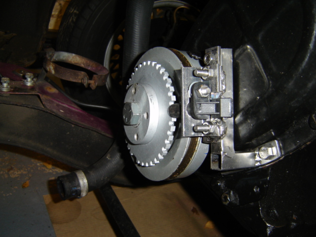

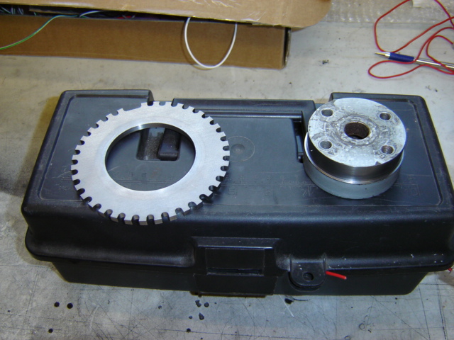

Hi, I am fitting a system to my Mk2 Vitesse (2.5L). I had considered machining the front pulley however, they have an integral harmonic damper which means the pulley is not directly attached to the crank.
Have you had any problems? I have gone for a different setup, see picture.

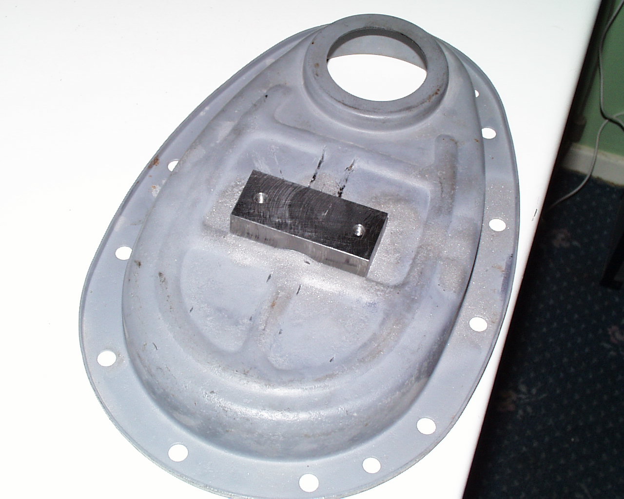

The sensor is going in the middle of the timing cover, the sensor has to be 60 degrees after the gap (engine does go clockwise as viewed), the pointer you can see is picking up on timing markings on the crank pulley / damper.

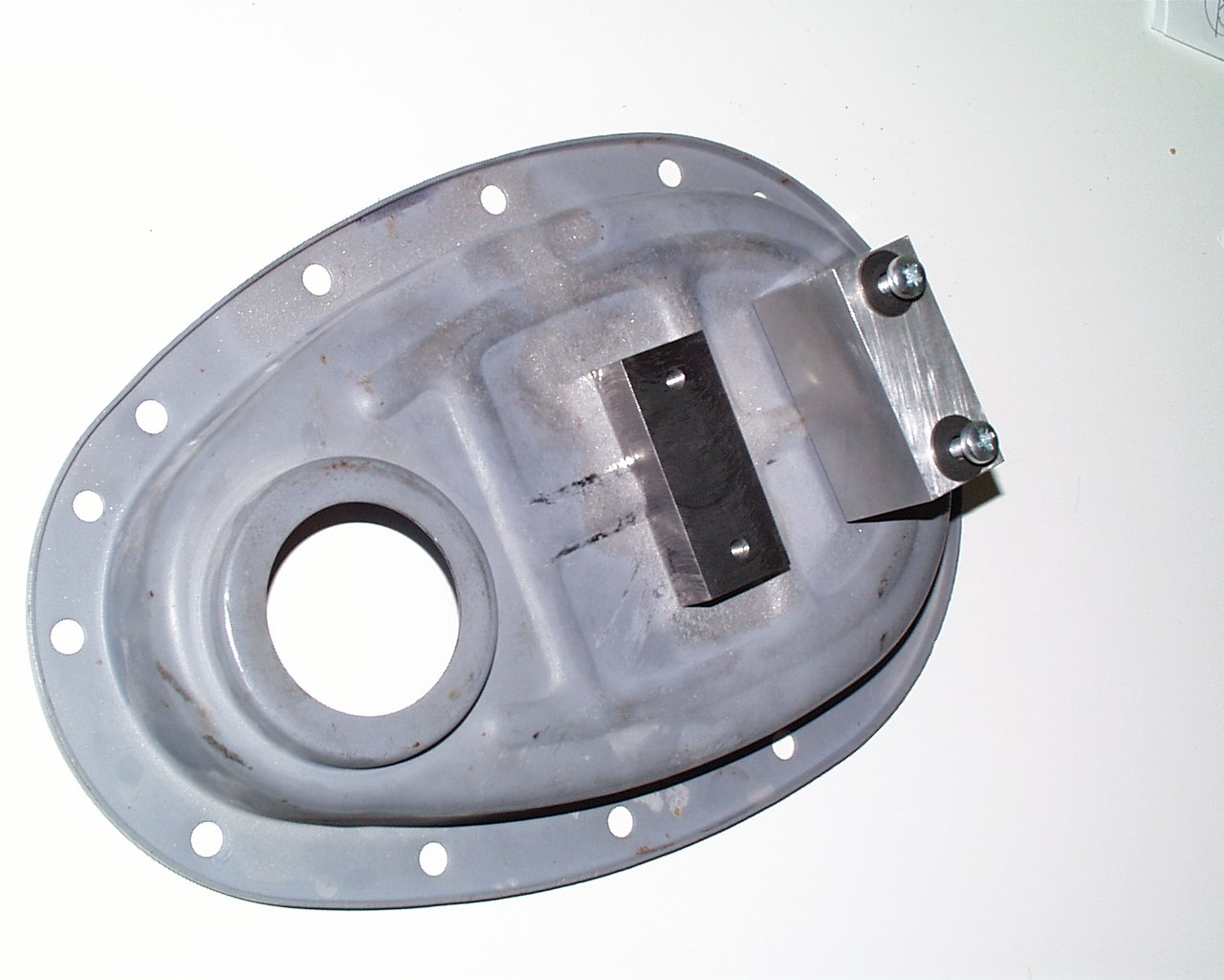

If you count six teeth anti clockwise from the gap, there is a rib. I am having a steel block machined to straddle this, it will be welded to the cover. It will have two tapped holes to mount the Alloy block for the sensor, this will have oval holes too alow me to set 10 degrees without Megajolt input.
I hope that makes the installation clear.

I am having three "blocks" machined that weld to the cover, this is a good spot as it is "inside" the fan belt loop.

And at last I have the bits ready to weld to the timing chain cover!

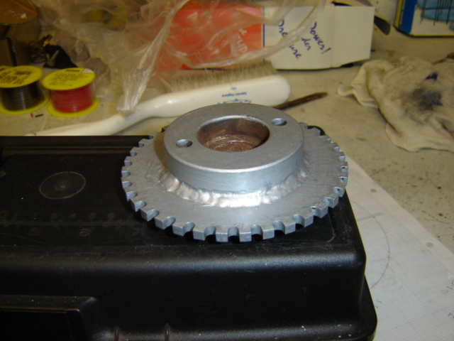

Just for interest, here are a couple of pictures of my trigger wheel mounted on my GT6 ( also 2.5L ), I had the pulley extension machined and the wheel welded to it. The VR sensor is mounted on the timing cover bolts. The bracket is not quite finished as it needs a bit more welding once I am happy that the timing is correct and then a lick of paint.
