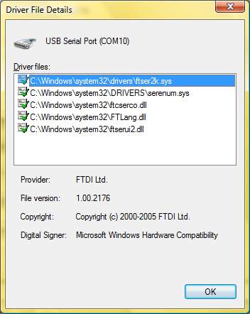

Here's a screen shot of the FTDI driver I'm using. It seems to be quite stable. I had tested it on XP, and now on Vista.
Did you get it to work on the other laptop?
