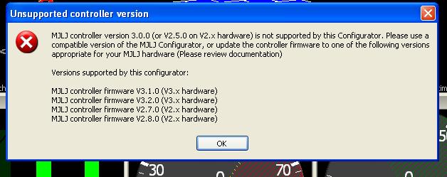

Help Guys, ive download the latest V3.2 Configurator but im unable to get it to communicate with my MJ unit.
As soon as i plug the unit in ( serial cable not usb ) it comes up with a msg Unsupported controller version. Ive download the new firmware ( bit unsure what to do with it once ive downloaded it )

This is by design. You can download the V3.0.0 configuration software to use with the version of the firmware you currently have.
As you've gathered the V3.2.x configuration software is designed to work with the newer firmware; you can also upgrade the firmware to the latest version. See the upgrade guide here for the steps to do the upgrade:
http://www.autosportlabs.net/3.1.0-2.7.0_upgrade_guide
(Just substitute V3.2.1 wherever it says 3.1.0 -- I haven't updated the documentation to reflect the released version).

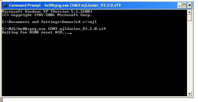

Thas what im doing guys, soon as the 'Waiting for HC08 reset ACK...'msg appears i power up the MJLJ unit but nothing happens it just keeps waiting.
Does this look ok ??
What type of serial connection are you using for your computer? The programming utility is known to have problems with certain USB-Serial adapters.
You might want to try using a computer with a standard serial port and power the unit with a fresh 9V battery.
Report back,
Also - its highly recommended you use the 3.2.1 firmware instead of 3.2.0; see the other post in this forum.

So your screen dumps show that you have V3.0.0 firmware in the MJLJ and you're trying to run the V3.2.0 configurator - which doesn't work - and trying to load firmware V3.2.0 into the MJLJ on COM3. And as Brent says, you should probably be going to V3.2.1 firmware and V3.2.1 Configurator, but that's not the issue here.
If the V3.0.0 Configurator downloads and uploads maps OK then I'm a bit stuck for ideas :( apart from:
- your MJLJ isn't on COM3. hc08sprg.exe will report an error if the COM port doesn't exist, so that seems OK. Are you really, really sure the MJLJ is on COM3 :?
- I have had problems with the reset ACK not being recognised occasionally. It almost seems that I'm not connecting the power quick enough (ie it needs a rapid application of power, which defies a lot of logic). If that happens I just Control-C the DOS command and rerun it - it invariably works fine next time I power up the MJLJ while the PC is waiting for the reset ACK
I'll keep thinking....

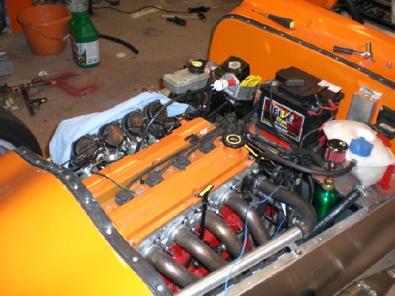

Heres the engine that the MJLJ is sparking. Tuned 2L Zetec on Bike carbs.

Which bike carbs are they and what manifold did you use?
Martin
