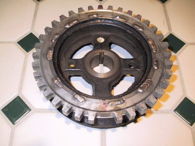

I had a similar problem, but due to bad engineering on my part- I had adapted the metal ring from a 1.9L escort to an aluminum under-drive pulley. The clamping arrangement I used failed at 7600 RPM, and the timing wheel bounced around the engine compartment before exiting the bottom of the car!
Thankfully I had steel braided oil lines in the area; otherwise they would've been sliced through like butter. I too, thought I blew my engine!
Here's what I have now:
