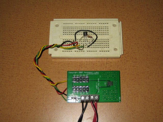

We have a design in hand for a hard rev limit module, designed to be triggered by the REV_LIMIT output of the MJLJ. I'm working on a full project page in the wiki, but in short, the basic approach solves these simple requirements:
1. Disable coil packs from firing upon command from MJLJ module
2. Prevent an early ignition event when rev limit is activated 'asynchronously' during coil dwell period.
The circuit is simple and rugged, using a power mosfet to 'current starve' the coil when rev-limit is activated. It does not abruptly cut power to the coil.

An update-
we're delayed sending out the rev limit modules for testing. While performing testing on the first version I wasn't satisfied with the design and ended up reworking the input circuit. So I'm waiting for a updated board to come in- and barring any additional gaffes I'll be sending these out to you.
In the meantime, here's a picture of the 'V1.0.0' design, which will never see the light of day (or the recesses of any engine compartment. :) )
