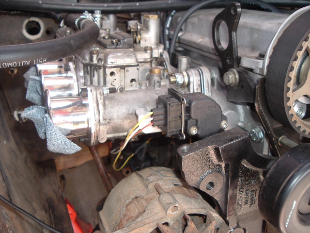

The throttle position sensor that i am using is a standard 98 2.0L mondeo unit. i have attached a pic to hopfully help with explanation. If the TPS is wired as per instillation quide (yellow wire being on the right) the values run backwards, changing just the MJLJ wires the values tick between 83 and 86 from closed throttle to wide open. To get the TPS to work with increasing values it was wired, BROWN to earth, YELLOW to lower MJLJ connection, WHITE to top MJLJ connection.
Any one else running zetecs got a wiring diagrm for these TPS wire values

- From top down, Yellow, White, Brown

Mik,
Not 100% sure what you mean by 'top' and 'bottom' MJ connection, but sounds like it's not quite right. Going from your pic, the centre WHITE wire needs to go to the 'TPS INPUT' terminal, and the outer 2 wires YELLOW and BROWN should go to EARTH and the 'TPS VREF' pins, swapping just these two around if you need to reverse the 'sense'.

Hi Brent, First of the easy answer TPS connections.
Plugged + connection of volt meter into white wire of TPS with a value of 0.51V at closed throttle and 3.82V throttle wide open.
changed wires around as per Rich's post and values reversed. So TPS is connected OK.
