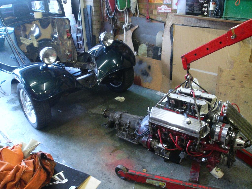

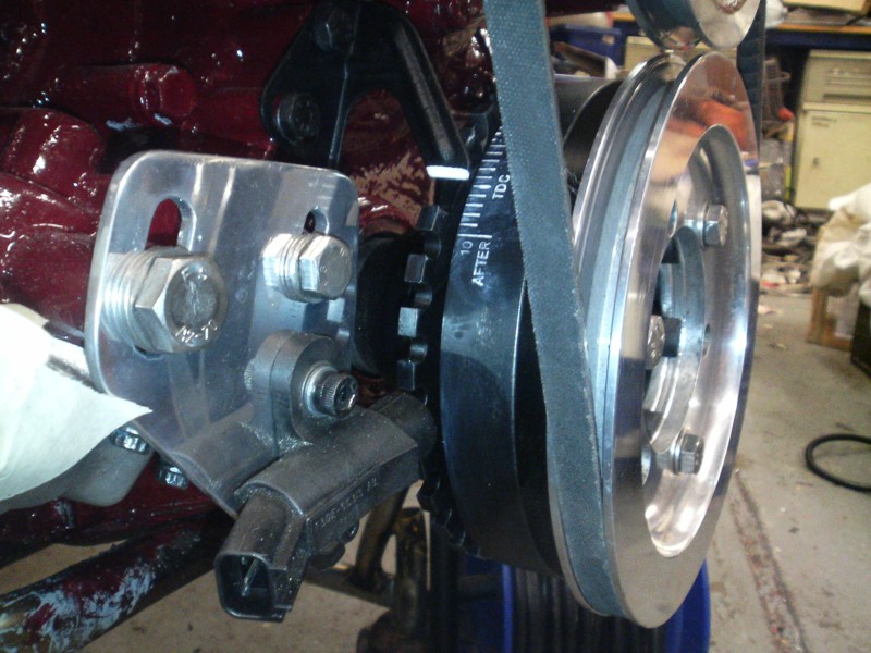

hi, received the megajolt kit last friday, and a hours mad soldering (including downloading the instructions) and the unit it up and running, all straightforward!
rigged the edis pickup/ trigger wheel on the my lathe, and spun it up, advance changing with revs and tps changes!! Hurrah!!!
the next one was the serial link, with the joys of vista, and no serial port, but a prolific serial convertor seems to be doing the trick, and now have comms!
just got to get the engine back in the car (had some other tweaks, and core plugs to replace) and I should be sorting a map out!
the car's a 1937 ford Y sedan Hotrod, 3600cc quad dellorto'd Rover V8, soon to be distributerless!

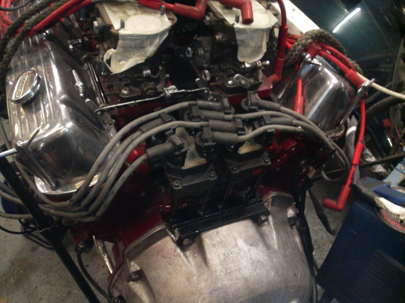

coil packs mounted onto the back of the engine, I got the coil packs off Mondeo Zetec as they are at the top of the engine, and easy to get to!!!
one thing to note on the rover, each coil 'pair' feeds a plug on each bank.. that is, each coil feeds an 'odd' cylinder, and an 'even' cylinder. Had I the room to mount them side by side, in line, there wouldn't be any crossing leads between banks and a neater installation!

well, the engine is back in, most of the bits underneath hooked up, headers on but no system, and no rad yet, but couldn't resist seeing if it would fire! with the plugs out, and the oil pump primed, I span it over on the key with the timing light on (EDIS only at the moment) and the timing was about 8deg BTDC, close enough for the time being! I did include some adjustment in the sensor bracket to dial this out, but in the excitement, I refitted the plugs, double checked the plug order, and fired it up!
